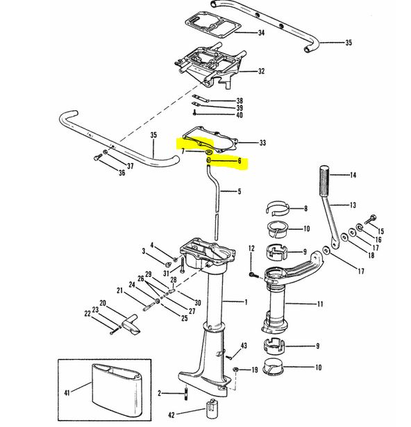

        The spring is there because it allows the thermostat to lift off its seat at higher speeds, for additional cooling. 143 degrees is correct. 15s are great motors with one big problem: Over time, the upper water tube grommet under the power head gets pushed in by corrosion and blocks a great deal of water flow, which will lead to overheating. It is an odd situation because often, you can’t tell this is happening by just looking at the tell tale output. If it were my engine I would spend the time, pull the power head and clean this area up, replacing the grommet. You’ll also need the power head base gasket. Have a propane or Mapp gas torch ready. You may need it on the inner exhaust housing/tuner bolts. Then again, you might not, if you’re lucky.

            Like Bill says, chances are good that you have a grommet issue, especially if this engine has seen salt water use. Adding insult to injury, this 15hp may have two pesky grommets. Later model 15hps like yours have an “open inner exhaust tube”, along with a short water tube exiting the powerhead….
            That being said, I am assuming that you cleared out the overboard indicator hose and plastic restrictor nipple, oftentimes these are plugged…Surely don’t want you to pull this thing all apart needlessly.

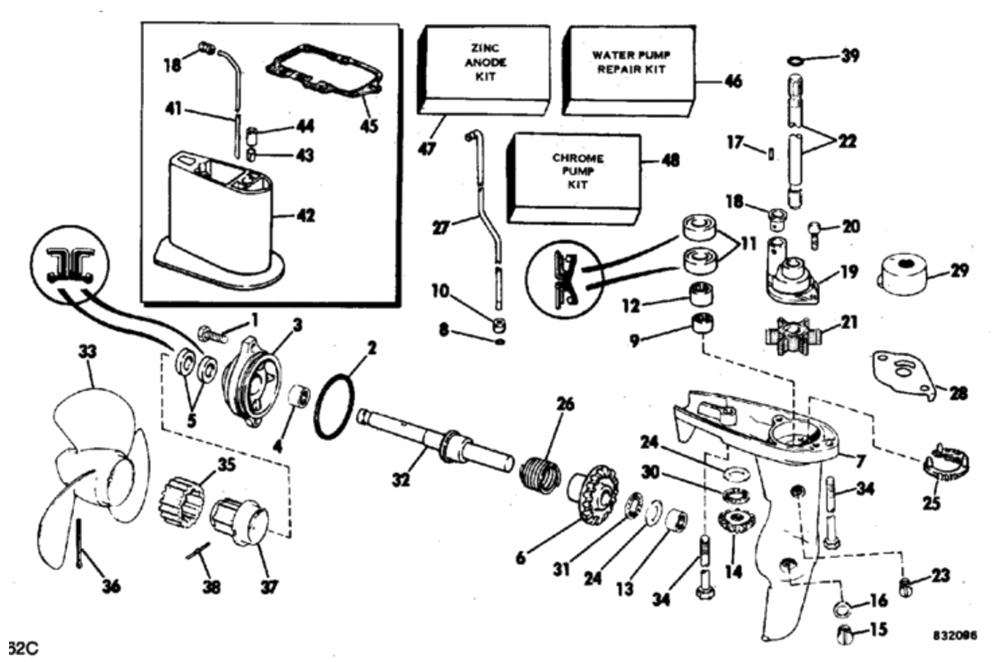

              I did find the parts diagram and see the spring,retainer, gasket and thermostat, I have these .ordered. I am a where of the grommet issue and may have to pull the power head to fix that, but I’ll put the thermostat in and see if I get lucky , the passage to the upper over flow hole is clear, if I blow compressed air thru it I can feel and hear the air coming out the water pickup on the lower unit, so we’ll see. Next is the issue with the the throttle gears in the handle with broken cogs , the plastic gears inside the cowling don’t seam to be broken but I am sure they are worn.looks like those parts aren’t cheap. This is the little motor that keeps on giving I guess.

                  Well, I hope you do get lucky and don’t have to attack the grommets…Didn’t mean to jump the gun, guess I have seen too many of these. I remember the first one I discovered back in 1981. Just want to make sure I understand your post…The engine didn’t pump well before you replaced the water pump, correct? Any possibility that the water tube is misaligned and not going into the impeller housing grommet correctly? Perhaps someone bent up the water tube on a previous attempt. Perhaps the intake screen is plugged up with debris from your test tank. This engine “looks” fairly clean, has it been used in salt water? The gear housing castings are very thin under the forward part of the SS impeller plate, and erode badly….This might be causing the pump to suck air instead of water…Don’t get this confused with the other scalloped cut out under the impeller housing that is supposed to be there…
                  You can be fooled by using compressed air to blow through the water tube…The compressed air usually has enough pressure to “open up” the grommet allowing air through it, whereas the water pump doesn’t develop that much water pressure….Keep in mind that this 15hp probably uses the two water tube set up I mentioned in my earlier post, so if the outlet grommet was collapsed, you would still feel air coming out the telltale hose blowing through the intake water tube.
                  Again, I want to be wrong, so feel free to ask plenty of questions and provide any more info that might help us help you…I surely don’t want you to pull the thing apart needlessly….The grommet job isn’t too bad on fresh water engines, but salty ones usually require the torch…Sometimes trying to pry that powerhead off the exhaust housing can be a challenge also, be careful not to break the motor pan with pry bars.
                  There is a way to install the new grommets “improperly” that will avoid this issue in the future, hopefully we won’t get that far and it will pump fine with the new thermostat….Don
