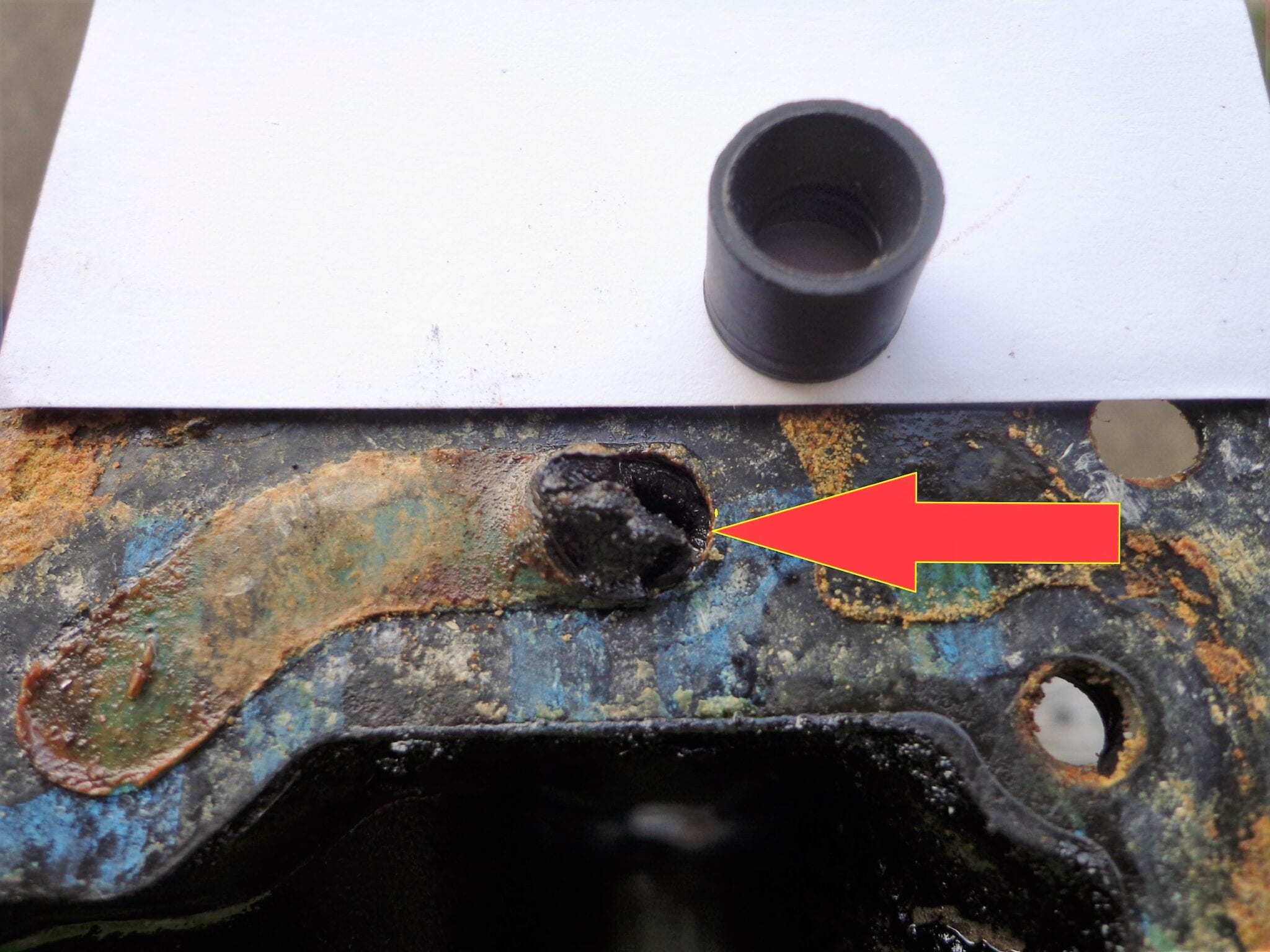

                  Bill is right on….Those darn crushed grommets may show water flow, but it is not enough….The classic symptom is starting the engine, seeing water flow until it starts to overheat, then it will suddenly blast steam out of the telltale and really heat up. Keep in mind, some of these engines have two of these pesky grommets, if it has the open inner exhaust tube. I surely don’t want you to rip this thing apart for nothing, but the grommet(s) will have to be addressed at some point if cooling issues can not be resolved with simpler inspections/repairs. The grommet/water tube set up was improved over the years, but even some of the “improved” set ups get crushed as well. Needless to say, this is more of a salt water issue, but does happen on fresh water engines also.

                        For anyone wondering what this water tube grommet is being referred to, here’s a crushed one and its replacement. There is quite a difference between the two!
                        9.9-Grommet-Failure
