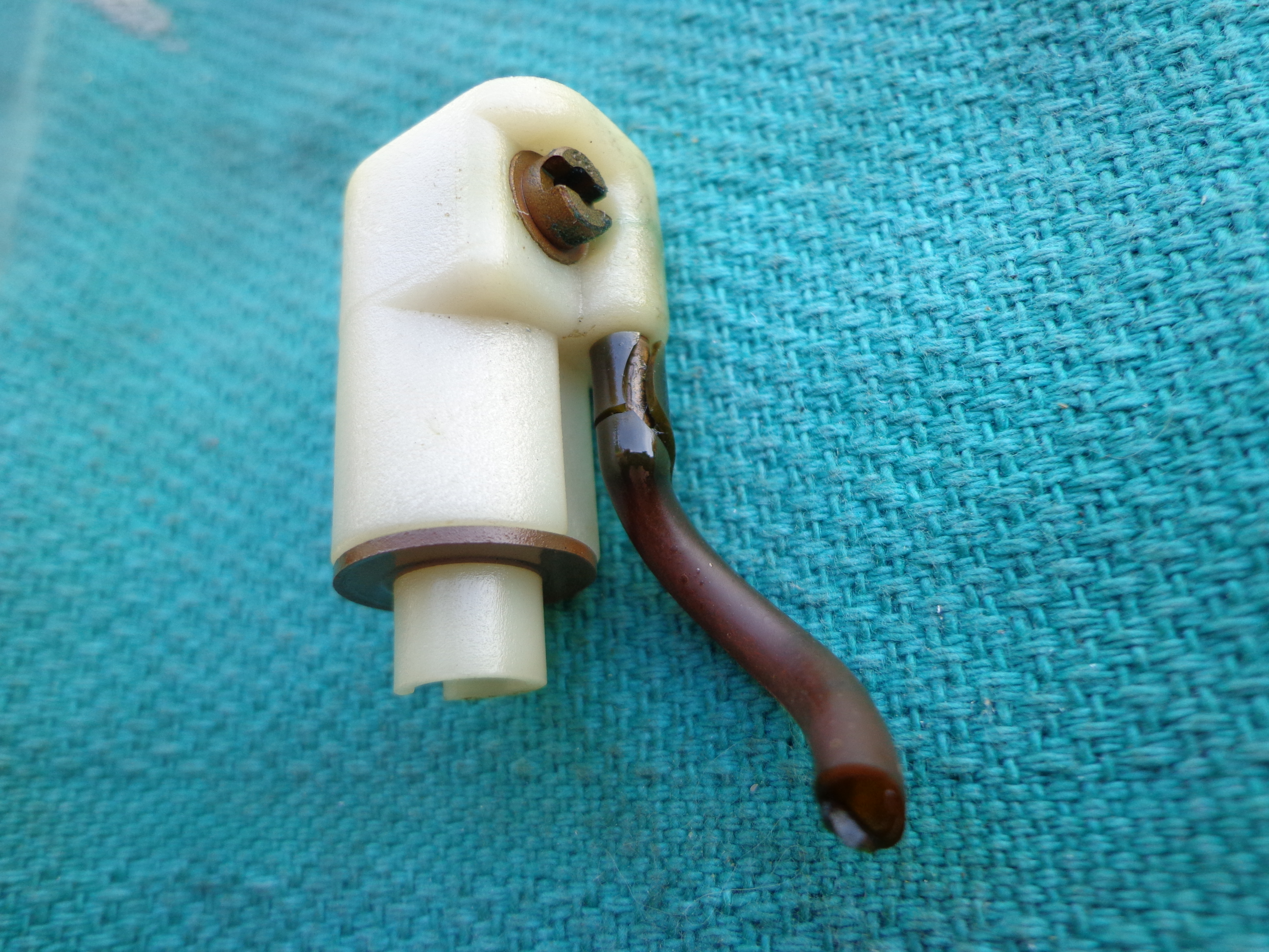

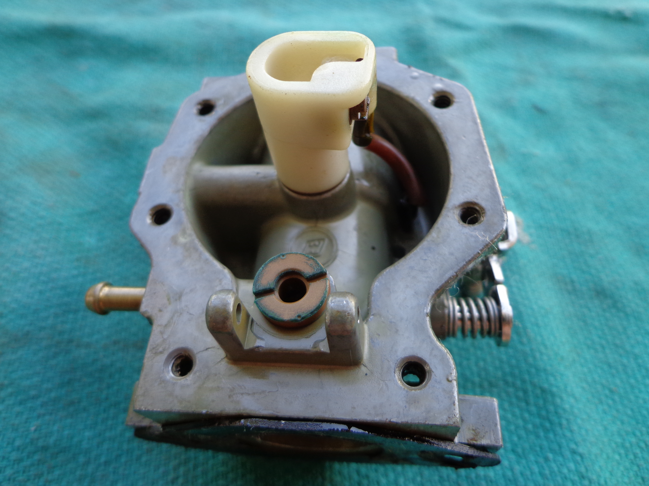

      #74108
        The problem could also be in your carburetor. In the bowl.
        These carbs have a small fuel line in the bowl which deteriorates and breaks down over time causing all sorts of operating issues. Alcohol in your gas might aggravate the problem. Replacing it with a short length of Tygon will solve the problem.
        #74109
        davesko
          Hi Mumbles, Thanks for the reply but my carb is not that type on that motor. My 1987 looks like that but the 1985 doesn’t have that tube.

                      Right you are as your motor should have the normal 9.9 style carb on it. These carbs with the small tube appeared on the ’86 models.
