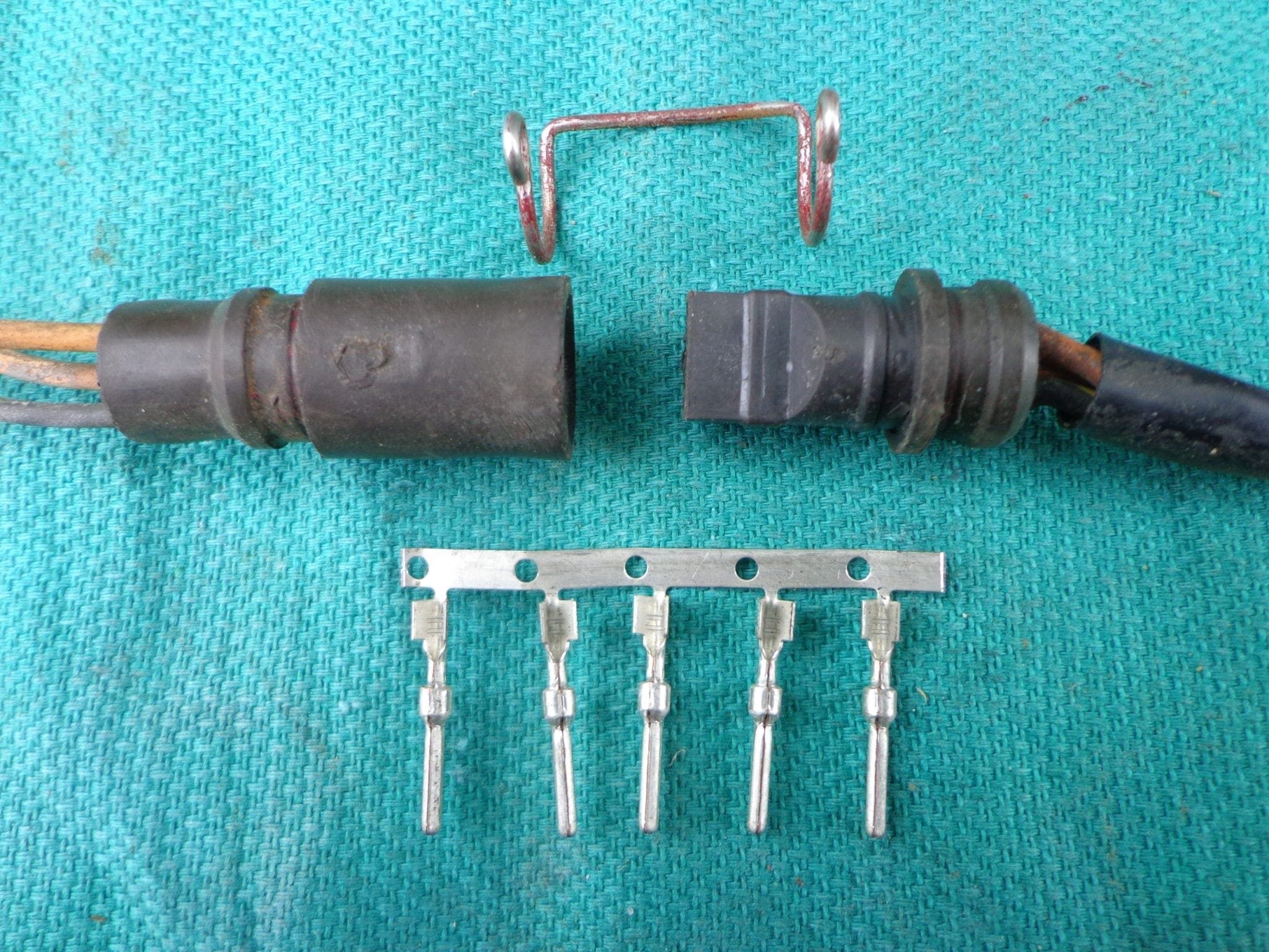

        One possible problem area to check would be the Amphenol connectors. The wires going in can be broken off inside the connector or the pins can be pushed out when reconnecting them. Corrosion in the connectors will cause issues to. If the pins are damaged, a new one can be crimped and soldered on quite easily. Also, check the wiring to the kill switch for shorts to ground. Any of these issues can cause a no start issue.

                    Mumbles is soooo right…..Those amphenol pins/sockets/connections are a major cause of simple problems that oftentimes gets overlooked. You will need to invest in those amphenol pin/socket remover/installer tools if you are going to work on the OMC CD ignition systems….
                    Never overlook the simple basic things on these systems….
