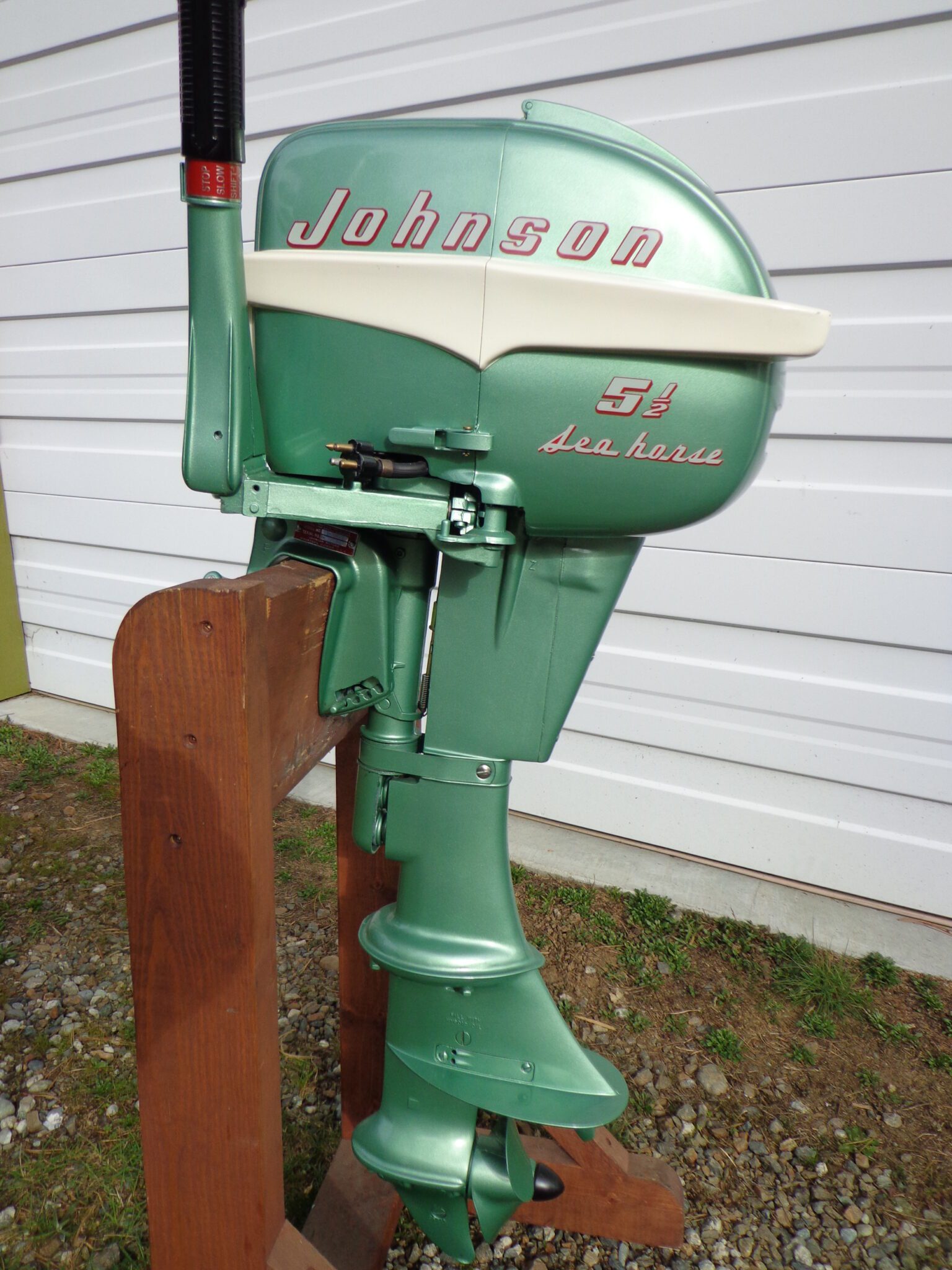

September 17, 2022 at 10:50 pm #266251September 18, 2022 at 2:45 pm #266290Piece of ART, very nice Job. Was the clear coat from a spray can ? was it Gloss ?
September 18, 2022 at 6:08 pm #266292Outstanding restoration Mumbles. Do you media blast all the old paint off?
