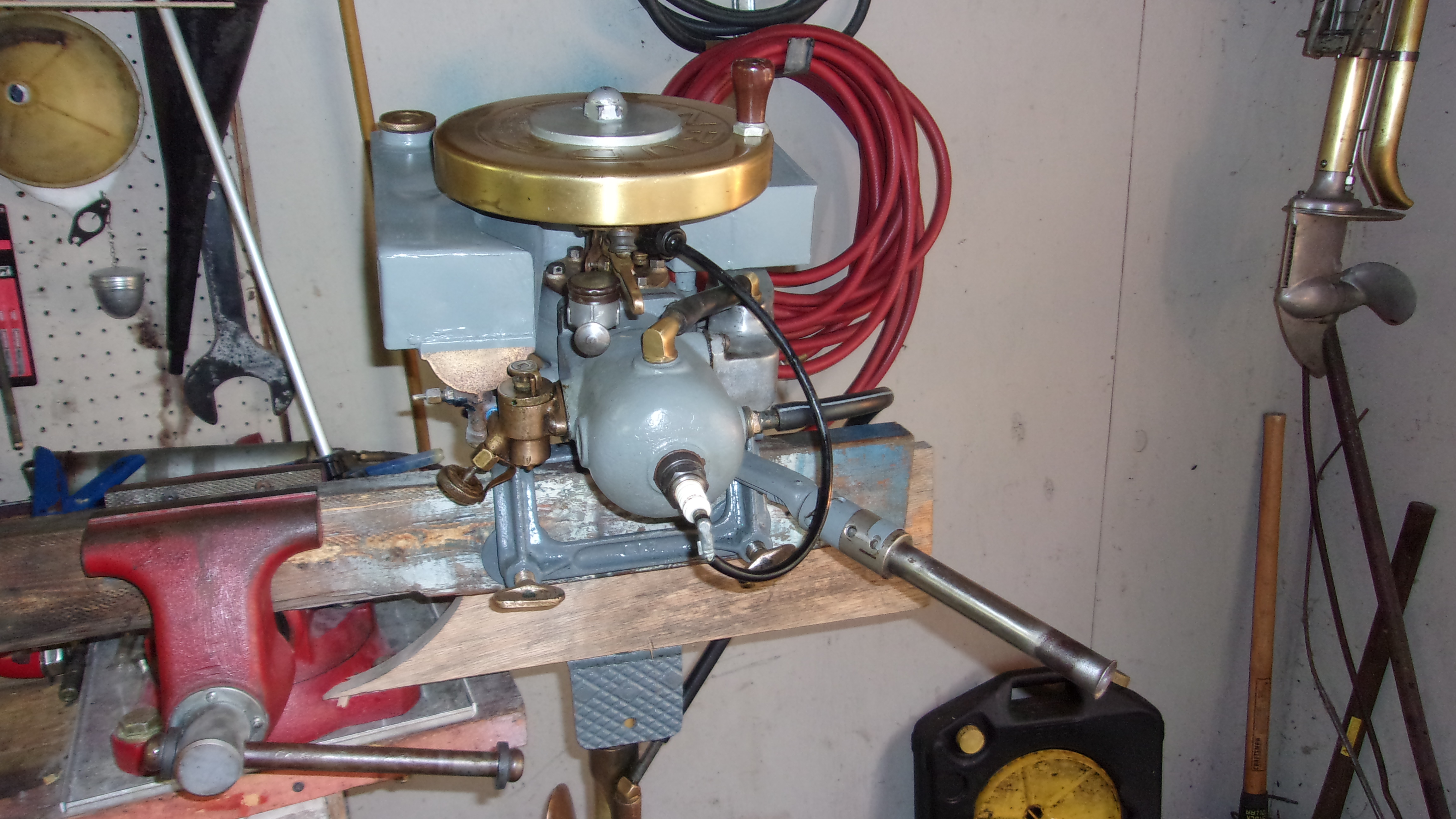

      slim60
        I’ll have to take it apart again. The steering is not working. There is a 3/8" gap between the reverse mech and the crankcase. When I set it on the floor it closes up. Turning the lower by hand is a little tight. Oh well, I’ll keep pluggin’ away. Thanks for the parts list and support.

          slim60
            Thanks for the photo, Tubs. Part #A262 was turned around backwards. Now I see that the only thing keeping the lower from spinning itself around is the reversing mech. Turning the F-R lets A262 loose momenteraly to catch on the other notch on the reversing mech. Does this sound right? If so, I can understand why some guys welded them.

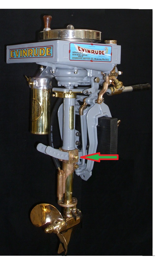

              #66600
                quote Slim60:
                Yes To all of the above. If you look at the parts picture I posted
                you’ll see where someone use screws to make the reversing mech.
                inoperable rather than welding. Happened really early in its life
                as it is in really good condition.

                  #66629
                  slim60
                    One more thing worries me. What is keeping the driveshaft and tube from falling out, besides the two bolts on part A262?
                    #66637
                      That’s it but my experience is they
                      are more than adequate. The key
                      inside the sleeve that attaches to
                      the crankshaft also has to move
                      in the slot of the driveshaft at the
                      same time. Your more likely to
                      have difficulty in getting the tube
                      to move than to have is slip out.
                      The ability to adjust the length of
                      the motor to what ever the transom
                      height is on the boat you may be
                      putting it on is a feature mentioned
                      in the manual.
