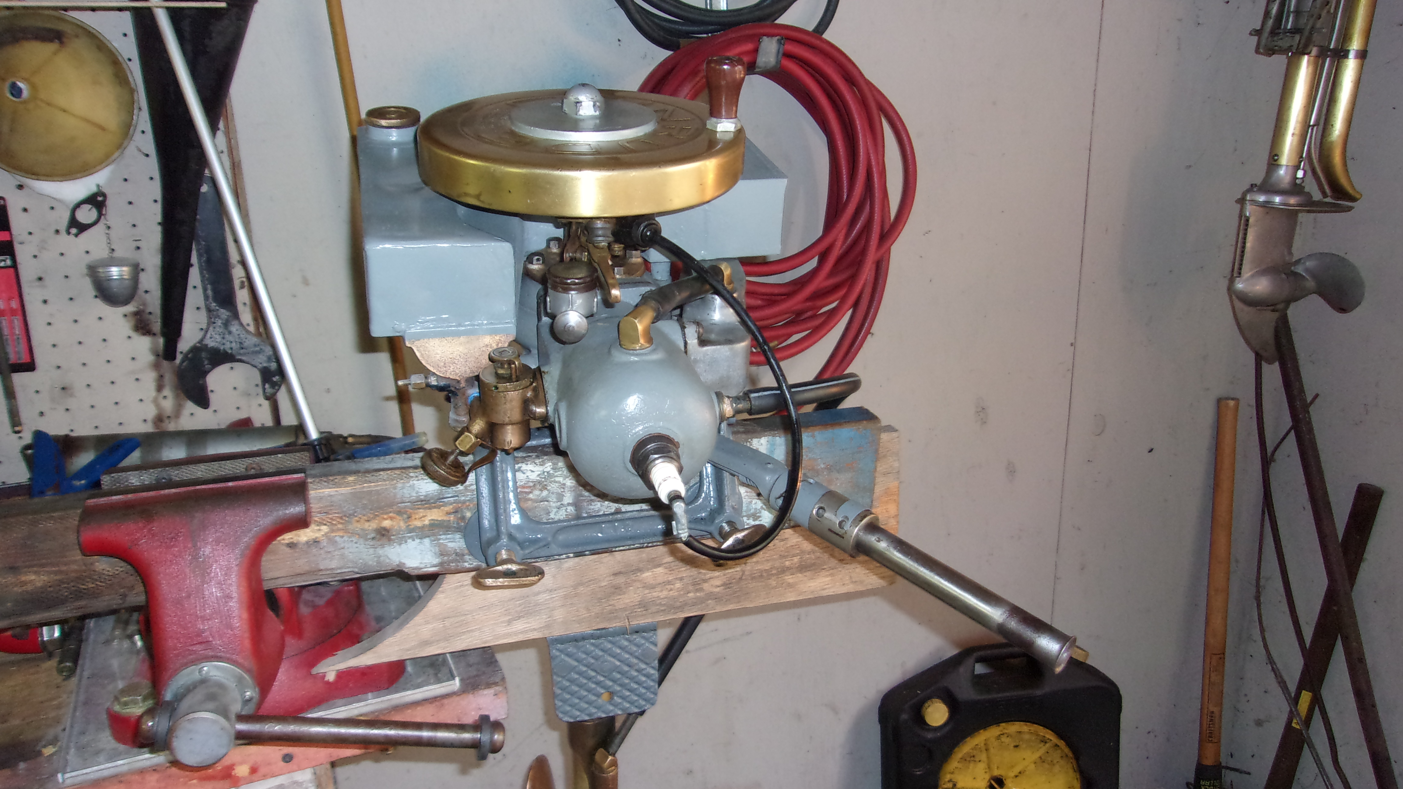

      The powerhead is finished and turns freely. Compression is good 6′ o’clock at TDC. and I have spark at 5 o’clock. I installed the poppet valve and would like to see it ‘pop’. Any reason why it should’nt?

              I mounted the powerhead on the test tank for more leverage. Then sqirted some fuel into the exhaust port and pulled it through a few times. It popped a couple times and then ran for five seconds. It sounded good and smooth. Now I’ll torque all the bolts and start to reassemble the drive shaft, lower unit, and tiller. I may have some issues with the tiller/reverse mechanism as the shaft looks different. Tubs, I’ll turn the poppet valve upside down and try it again after I torque. Good idea.

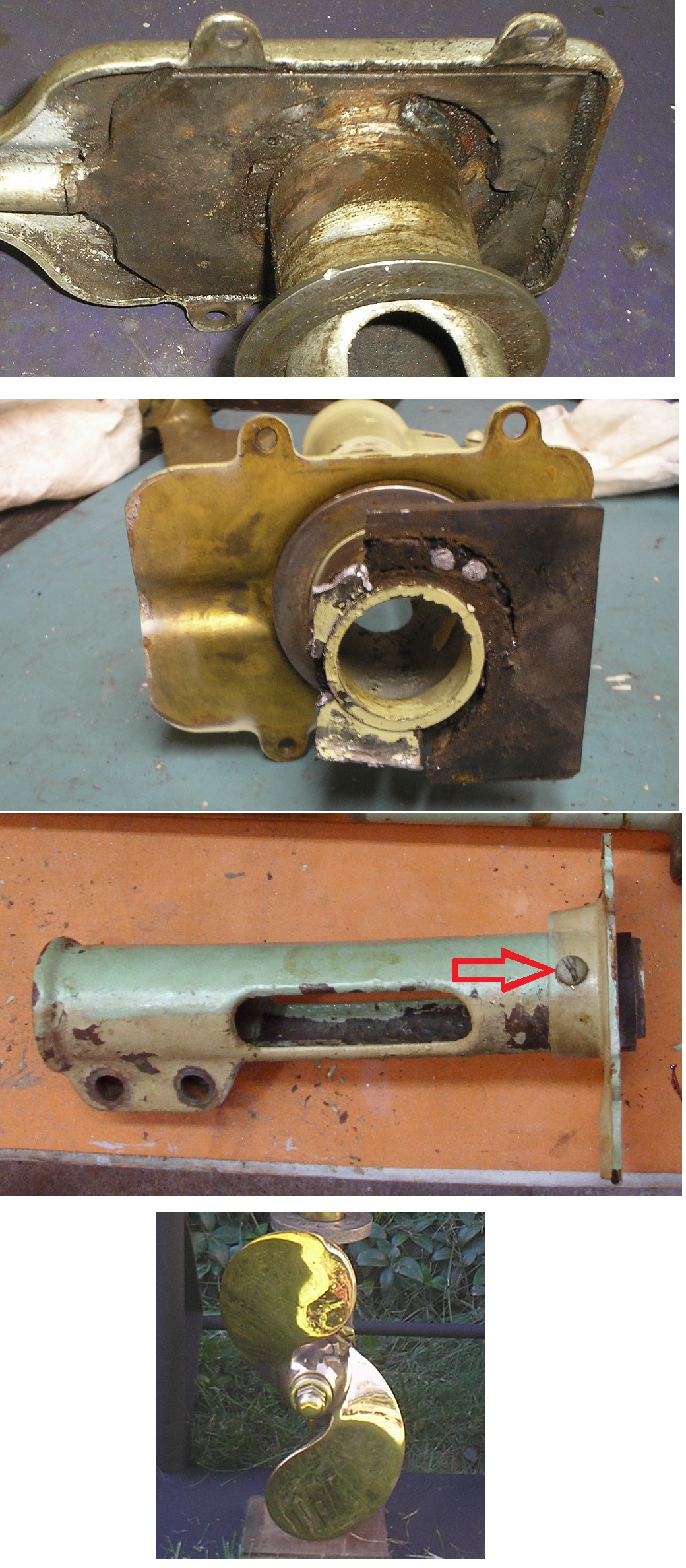

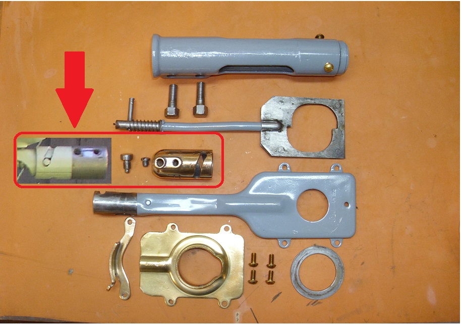

              #65543
                Now I’m not very knowledgeable on these.
                I’ve only had a couple and there is so much
                to know but from the ones I have had all
                the reversing mechanism parts seem to be the
                same except for the part circled. If you want
                to disassemble yours press the pin out. If
                you try to just knock it out often they will
                expand before they are all the way out and
                stop. Your 1922 should have the one with the
                green paint on it in my photo.

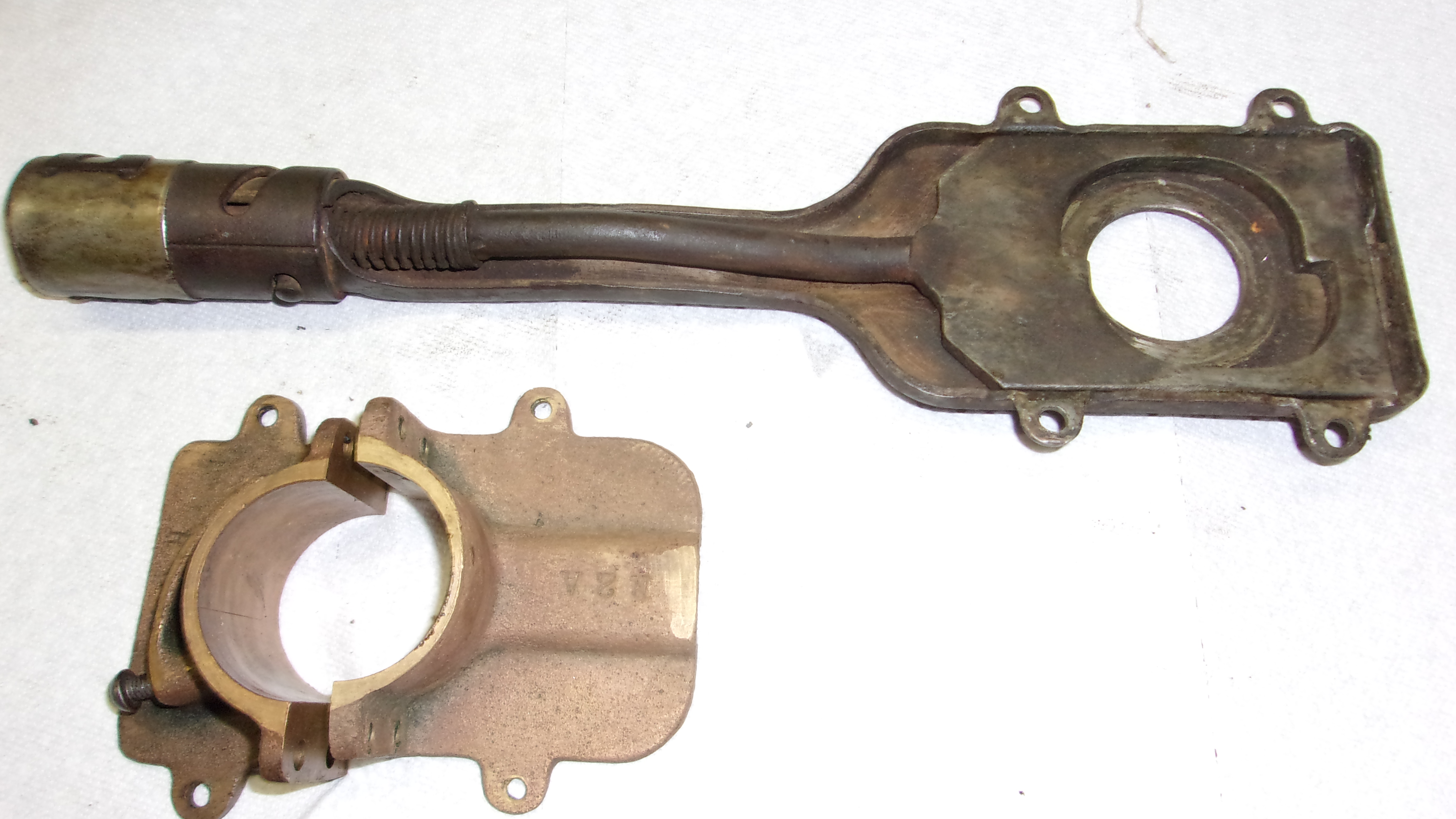

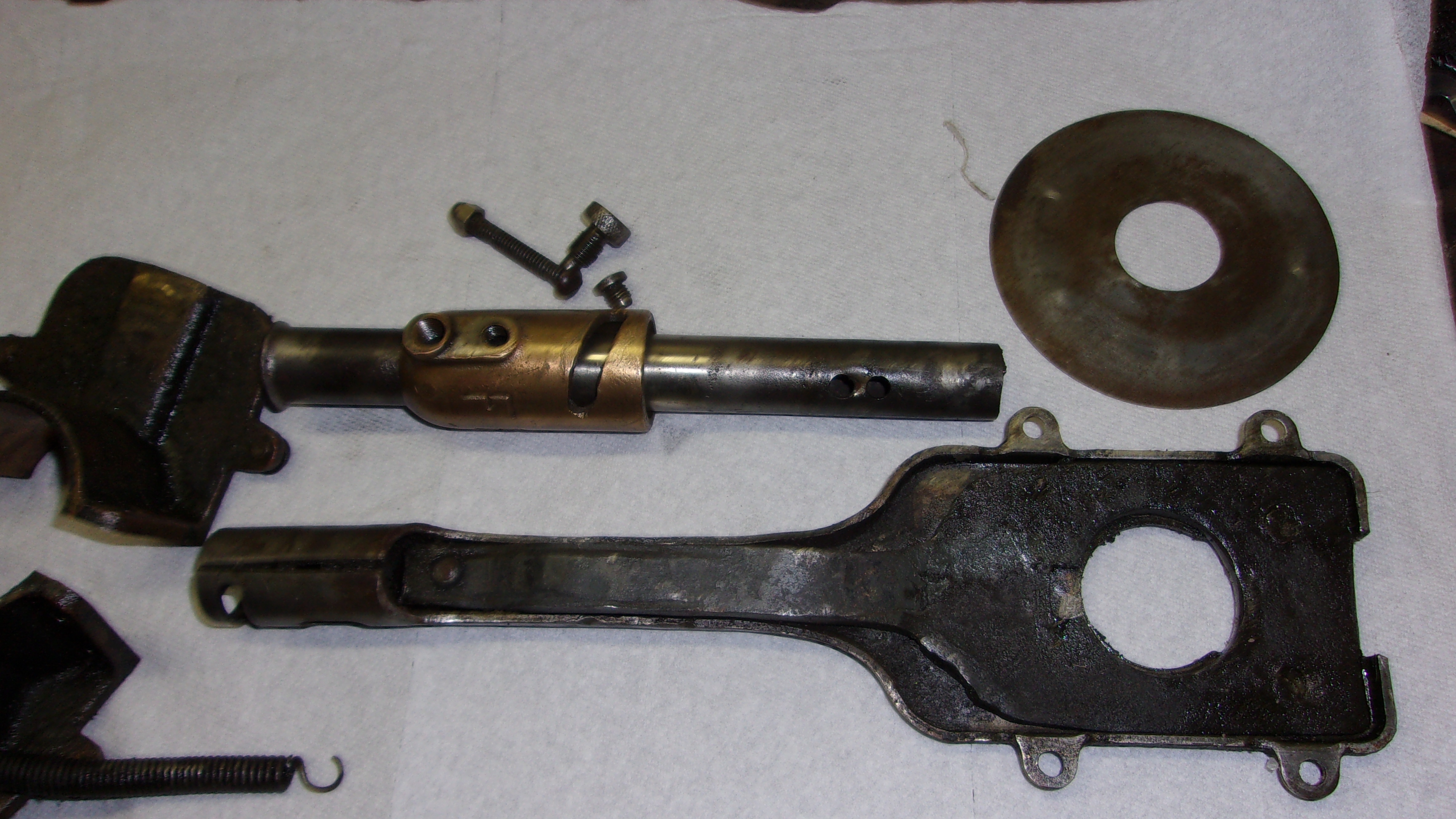

                  Tubs; The parts from mine in photo top. Looks to be welded and does not slide. Bottom photo are of parts I bought. That one slides.
                  The brass part with screws in your photo I must have missplaced. It’s been apart for a year.
                  #65597
                    The bottom one in your pictures is the
                    same as the 1922 I had. I believe its the
                    only part that is different and all the other
                    parts will interchange. That other part
                    in the lower picture is new to me. In 1922
                    they reversed the rotation of the prop so
                    yours should look like this one. Locking up
                    the reversing mechanism seem to be
                    pretty common however I found one
                    motor where they accomplished this
                    by just installing a couple screws.

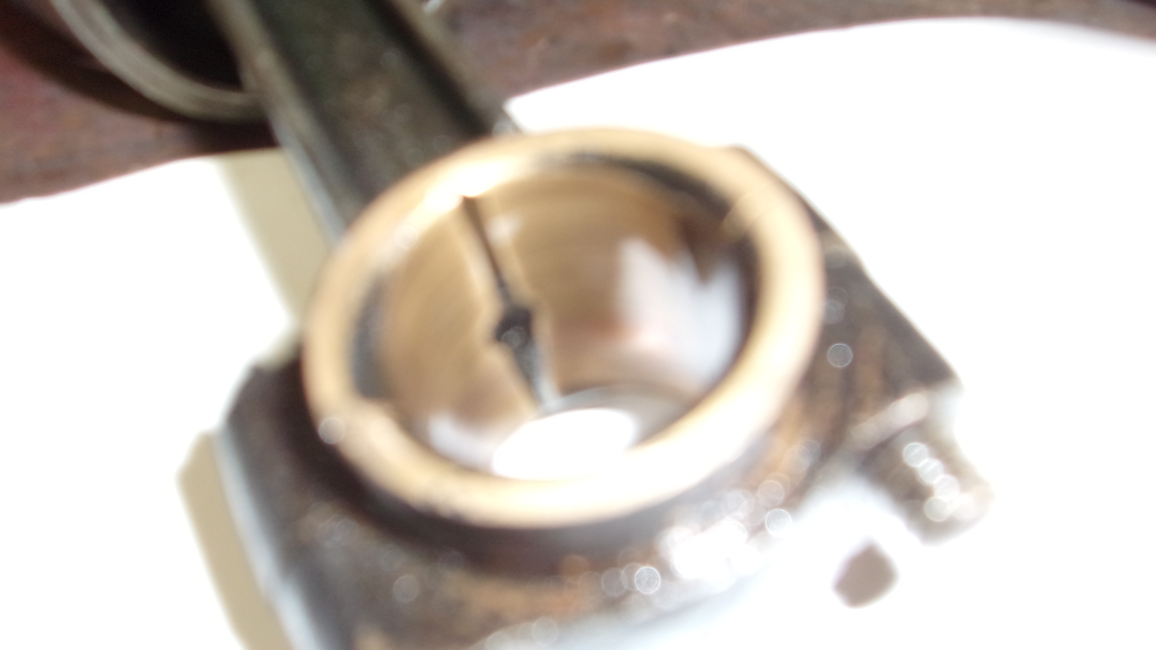

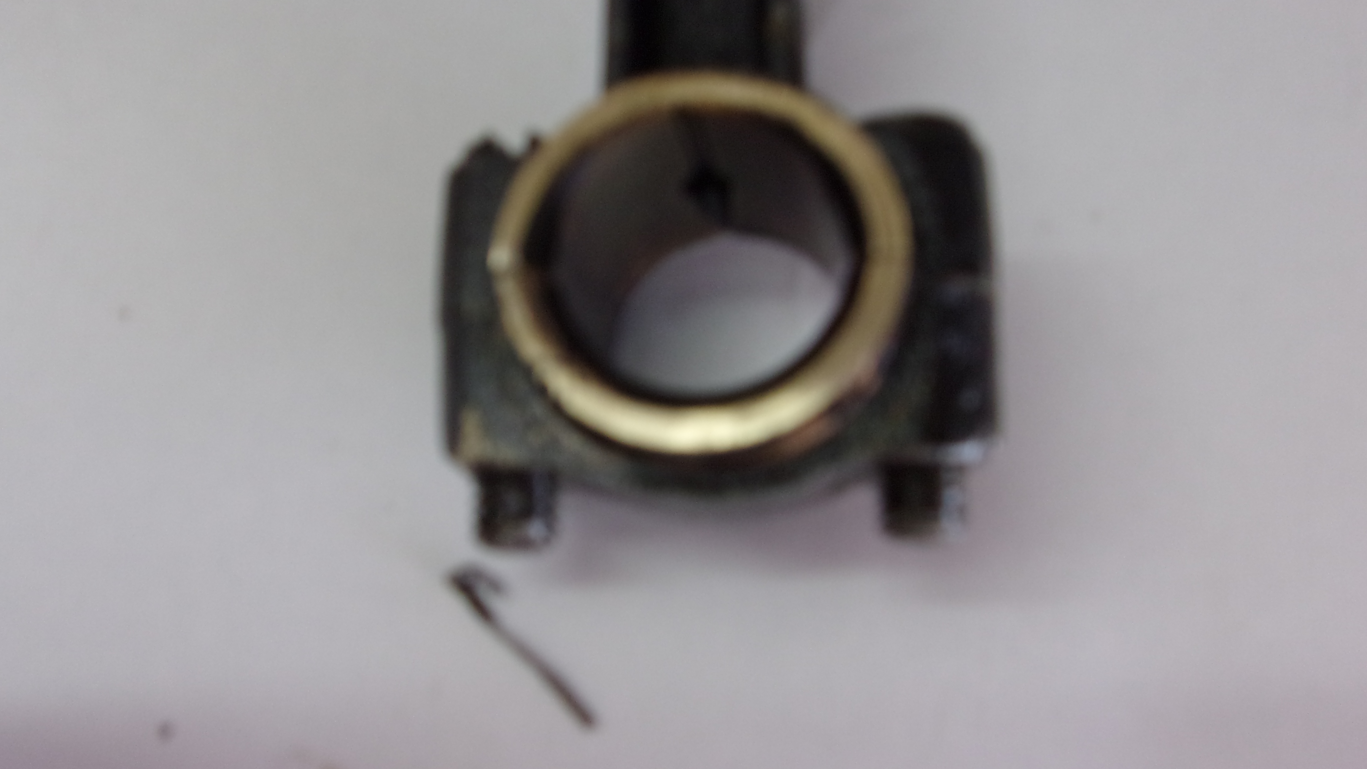

                    #66510
                    slim60
                      I could use some help on reassembly. I’m using the parts in the bottom photo. Where should the tab on the driveshaft tube fit into the reverse mechanism? Do I need shims in the two piece brass clamp?
                      #66527
                        quote Slim60:
                        Doesn’t matter as it rotates in there.
                        I’ve never had the 2 piece bottom so
                        can advise you there. Parts manual
                        doesn’t show any shims.
