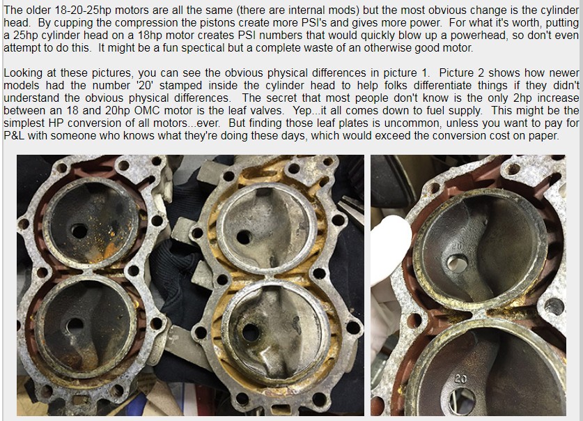

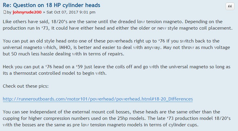

                Doug, I’m pretty sure he’s referring to a 1975 Evinrude 25 HP that he mentioned in another post.
                Dave, Be careful buying on eBay because lot of listings aren’t accurate or don’t have enough clarifying pictures. They might list a cylinder head and say "fits 18, 20, 25 HP motors"…or something like that. It might physically fit but it won’t be right for your motor. As Frank mentioned you can’t substitute, and Johnyrude200 had some nice info on a previous post about cylinder heads too. It would help to read it over to be sure you get what you need. And as others said too, place a wanted ad here.
                viewtopic.php?f=2&t=14247&p=74518&hilit=25+cylinder+head#p74518
                http://runneroutboards.com/motor101/pow … ifferences
