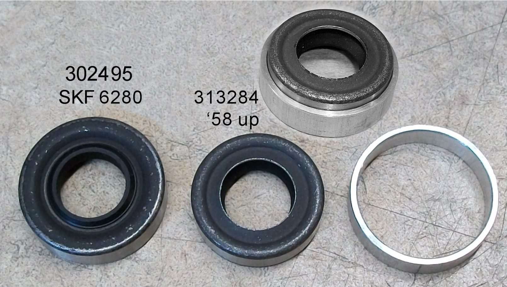

        John, If you’re referring to seal kits that say 18 HP and up, everything in them will work for your 15 except for the prop shaft seal. I think late ’57 and into ’58, 18 horse changed to a smaller O.D. seal that would be too small for the 15 prop head. That’s why I mentioned the guys who can make up a kit because I think for the most part the members who do that know what seal you’ll need with the ’53 15 HP.
        The other options you have are buying the kit from ebay and also buy the the SKF 6280.
        Or get the kit for the 18, and use that smaller seal with a reducer bushing. There is a member who used to make them and as of a couple months ago I thought he mentioned on here he still had a few. His name is Ben, OldJohnnyRude on YouTube and fisherman6 on here. Maybe he’ll see this and confirm whether he still has some.
        302495-SKF-6280-and-smaller-seal-with-reducer-bushing

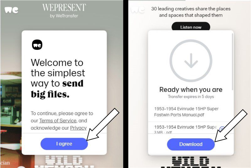

              Hey John, No need to purchase the we app, just click on the Agree button and that will open the Download page.
              The link below is the discussion a couple months ago when Ben said he still had some. Scroll down a little and you’ll see his post, “fisherman6” and just click on his name and it will take you to his page where you can send a private message to him.
              https://www.aomci.org/forums/topic/early-1957-evinrude-18-prop-seals/
              we-agree-and-download

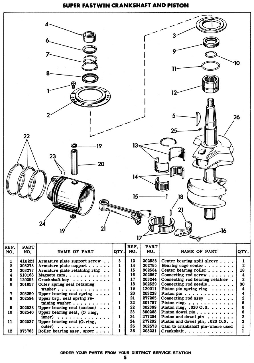

                first things first, received upper crank oil seal, looks like press carbon (brittle?) and am asking what is the best way to get it out without the tool ($50)? I got it from Marine engine in Vt. They also sent me 2 brings to replace. Are they easy to get at? And replace! Was thinking of using a tiny drill bit to make 2 holes and screw down 2 fine threaded screws and see how that goes. Will be extremely careful as to not scratch the shaft!

                  Never heard of a tool for those carbon seals, or drilling through them. I’ve always just used dental picks in the 2 rounded notches/cutouts in the carbon seal with a gentle back and forth and slight upward motion, with a drop or two of oil/WD40 to free things up a bit. I know they’re brittle so go easy and take your time. What do you mean they sent you 2 brings?? Do you mean 2 O-rings? A new O-ring sits in the recess of the I.D. of the carbon seal.
                  I sometimes like to poke the O-ring with the dental picks first and try to free that up first before trying to bring the whole thing up. Once you get that loosened up and rotating around the shaft a little, then try a light upward motion. This will help avoid breaking the brittle carbon seal. Sometimes even being careful, you can break that seal.
                  If guys have other ways of doing it, I’m open to learning about them.

                    One question, re: new carbon seal. It seems like it will fall in there easily with the o ring inside of it. I was sent another o ring tha looks like it will fit the outside of the carbon seal. Does it go under or over the seal? Help!! Thanks

                      You only need the one that fits inside the carbon seal. See the parts diagram. Also be careful re-installing. New ones can break too. Don’t know why they sent a 2nd, larger o-ring. Maybe they sent you an upper bearing o-ring too?
