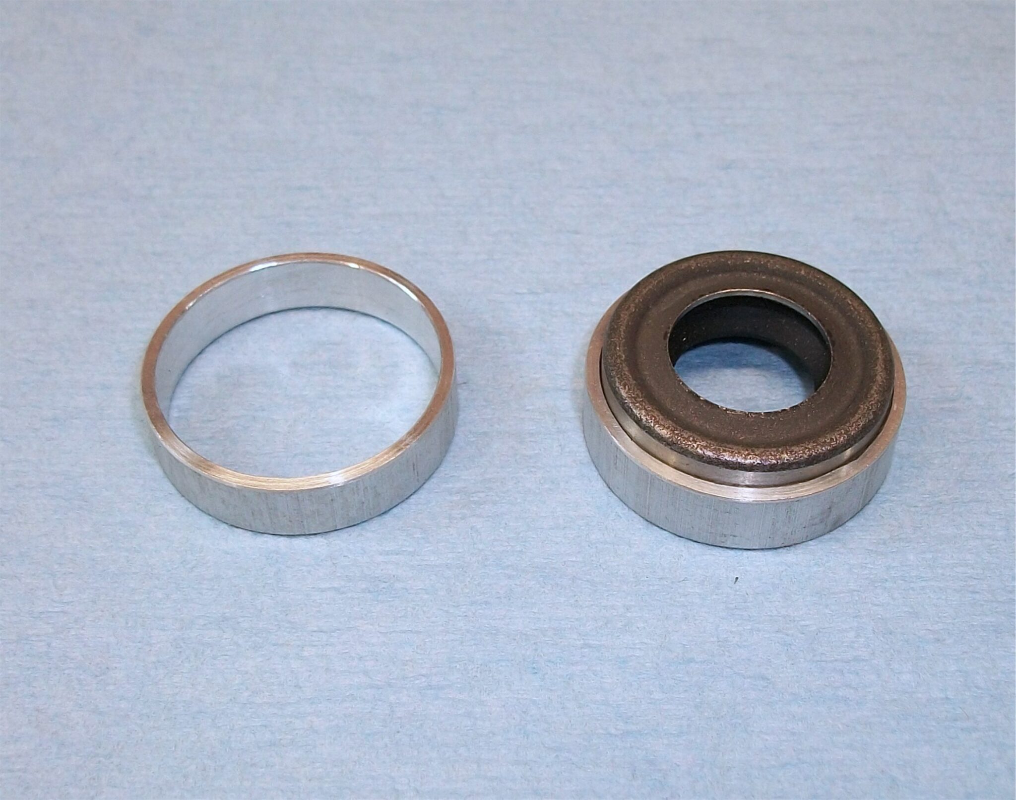

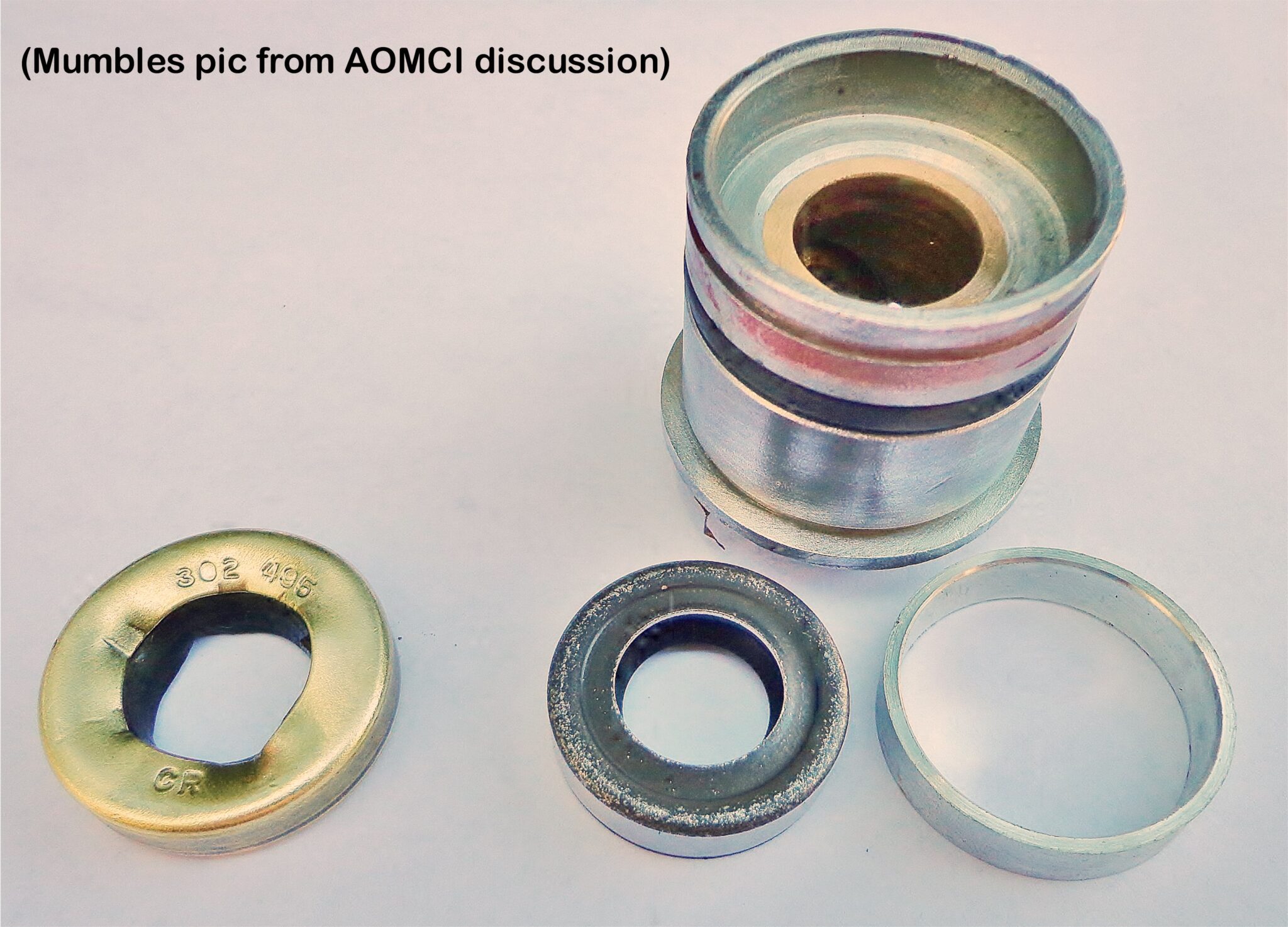

              Another option that some have used is a spacer allowing you to use the more readily available smaller seal 313284 in the earlier larger gearcase head. A member made them a few years back, not sure if he still does.
              https://www.aomci.org/forums/topic/qd-16-prop-shaft-seal/
              prop-head-reducer-spacer-ring-302495-to-313284
              302495-313284-Seal-and-Adapter-Ring

              fisherman6
                I made some of those reducer bushings a few years ago.  I still have some.  DM me if you’re interested. I’ll try to keep an eye on my messages on this board.
                -Ben
