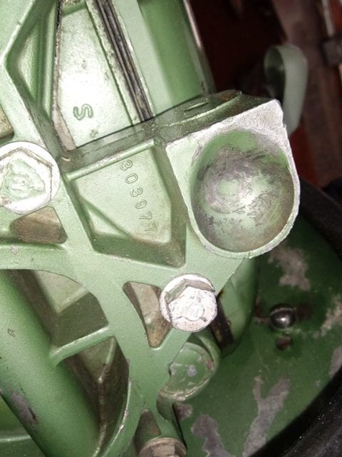

      i have a cylinder head on a 1955 25hp evinrude model 25920. it has a part number 303977.
      can someone tell me if if it interchanges with the 376336 Johnson and Evinrude cylinder head listed in the 1955 parts diagrams?
      i cant find much info on it.
      #218002
        Where did you find that part number? Is it another casting number? It doesn’t come up as a valid part number.
        #218017
        The red boat
          it is right on the cylinder head near the depression for the round hood bumper on the Johnson hood.
          Pics attached.
          it is the only number on the part.
          I likewise couldn’t find the number listed anywhere and physically, it doesn’t look like any other I’ve seen listed for that year.

          #218022
            Again, it is a casting number, not a part number.

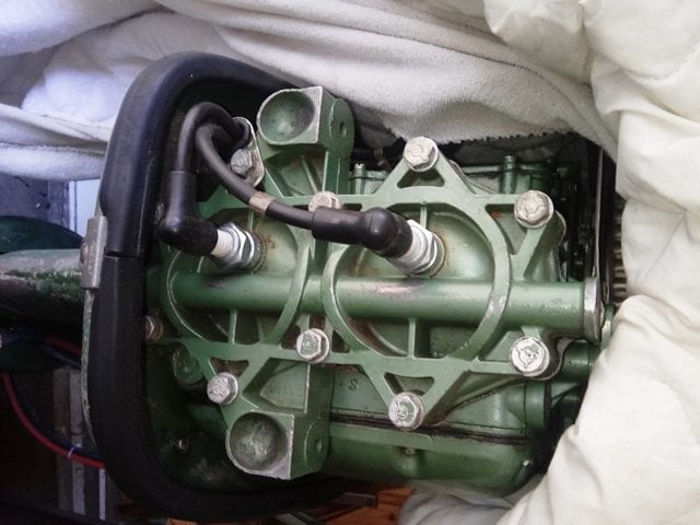

                  outboardnut
                    I don’t know if this help but
                    I own a RDE-17 25 hp Johnson 25 hp
                    The casting number is 303977
                    20201007_121500
                    #218045
                    outboardnut
                      whole-head
                      #218048
                      The red boat
                        that’s what mine looks like – exactly.
                        I need to paint it and put it onto the Evinrude but the Evinrude head has a different looking mold/casting even though they have the same number.
                        just want to be sure the bore and water passages are all compatible.
