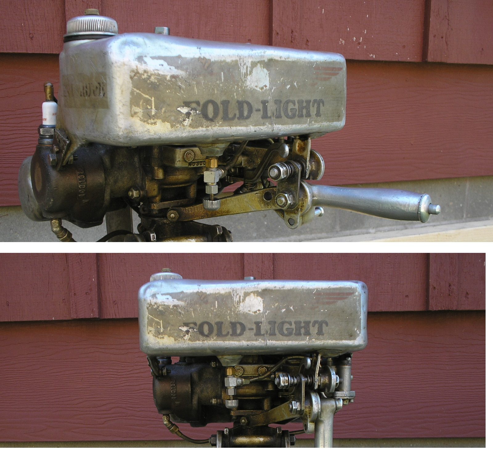

1946 Evinrude RangerJuly 2, 2025 at 9:57 am #297851Snap a pic of the front of the motor, try to reduce clutter behind the motor, a sheet or something…helps with the old eyes trying to focus…

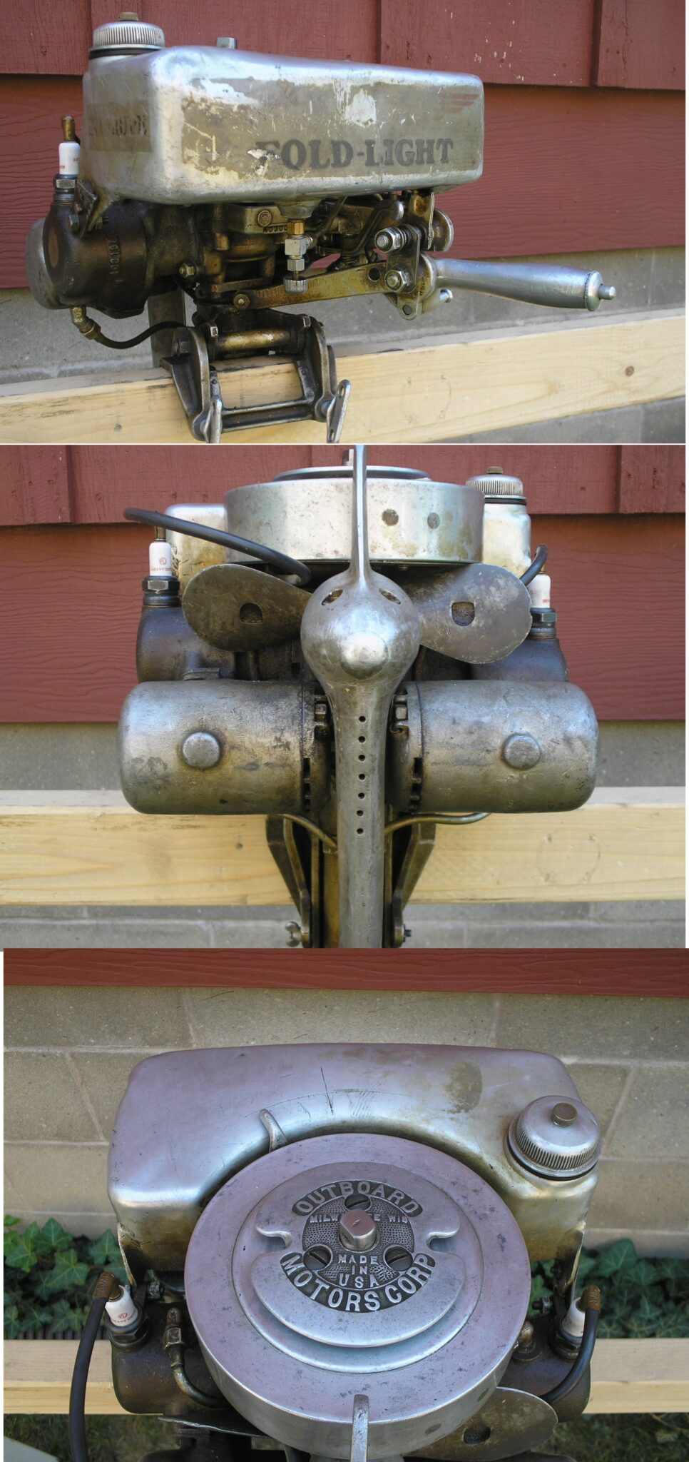

I have a few pictures of my 1931 on this lap top. Don’t know if they will be of much help to you. Only picture I have of the magneto is with the OMC style coil substitution. I won’t be home till mid-August to give you better shots. Just so you know when searching for parts the tiller mount is somewhat different on the 1930’s motors compared to the later motors.
July 2, 2025 at 10:08 am #297854
If you copy the pictures and paste them in paint they will be larger and you can also expand them.
