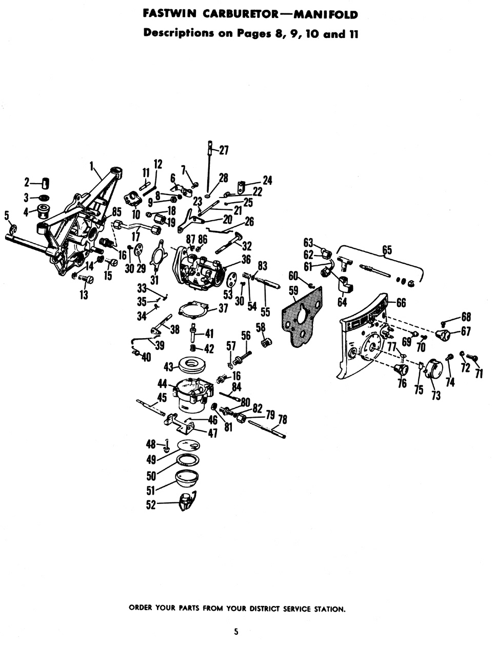

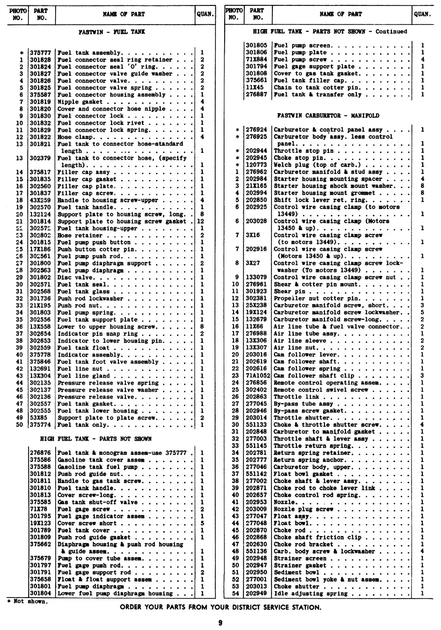

August 12, 2017 at 9:26 pm #62935This was used on Chryslers . . . ๐ – ๐
This on the neutral clutch Fleetwin – handy for gaskets.
And the 14 horse Fastwen . . .
The current list on the 0551142 float bowl gasket is $5.00 – fits dozens of outboards – ๐
