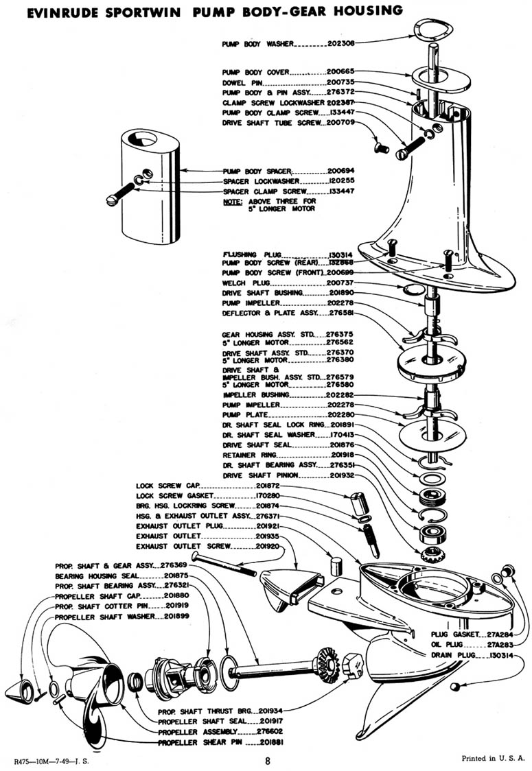

      After a couple of unfruitful days of research, I am at a loss as to how the water flows thru my little Sportwin. I can see how it gets to the lower impeller, but then to the top impeller? Then how it gets to the powerhead? That is the big question. I see the hole by the Welch plug, but from there??
      I asked around while at my first visit to Tomahawk yesterday, and was told there should be a water tube. I revisited some parts explosion pages that I could find on our site here, but could not find a "tube" anywhere. I also inquired of a few friendly fellow members enjoying Tomahawk as well as to whether or not my impellers should reach the outside of the volute, and why they were curved in the direction of rotation unlike all others I was familiar with. I got mixed opinions.
      So, here I sit, again, needing help from the greater audience that is the contributors on this forum who so kindly have offered such to me in the past.
      The problem I am troubleshooting is no water flow to the powerhead, evidenced by the exhaust cover paint burning and no flow out the vents before I knew what was happening when I first started in a barrel. I have taken the lower end apart and can’t figure out what is what.

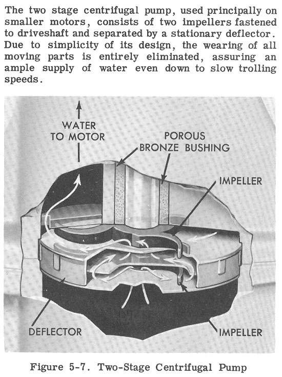

      #80655
        The impellers pump by centrifugal force, not by displacement as modern ones do. The lower one pumps to the upper one’s intake, and the upper one then supplies water at higher pressure (than a single one would) to the powerhead.

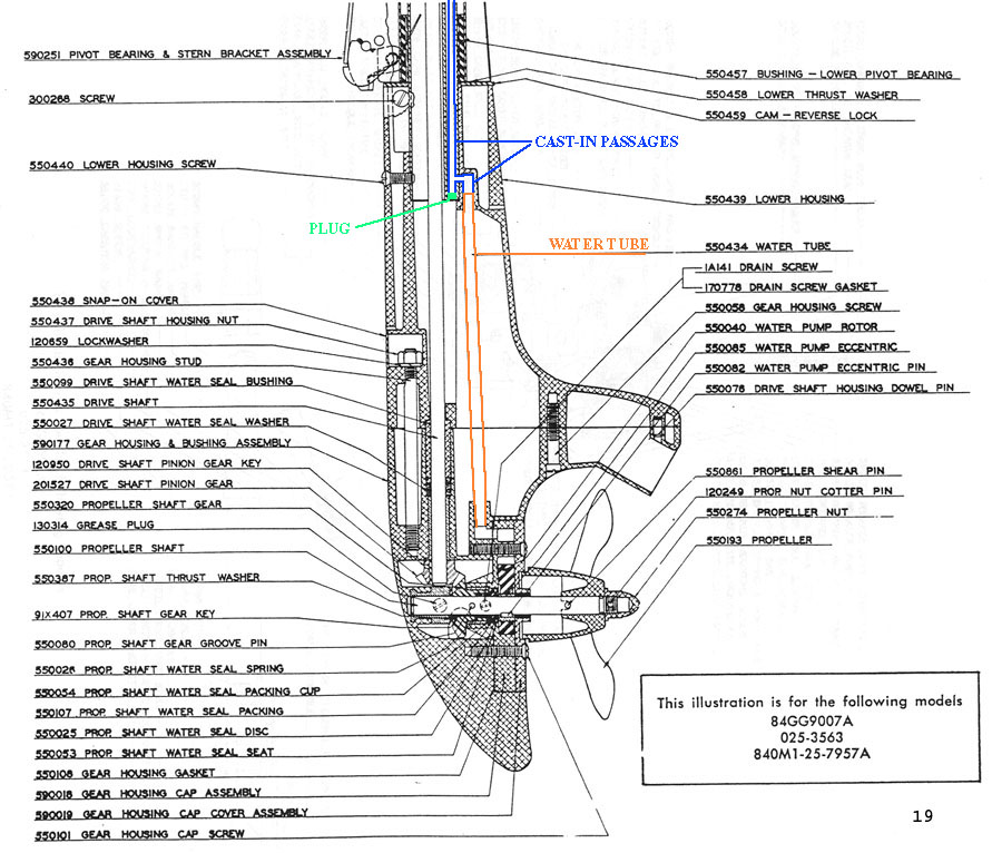

        #80656
          Not the same motor, but shows how water flows to powerhead through passages (blue) cast integrally into the drive shaft housing.
          #80657
            Two Stage centrifugal pump
