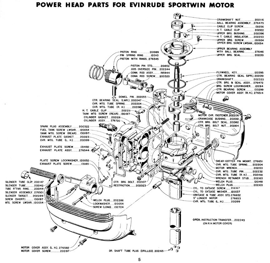

      hey guys . i’m still stumped on the power head removal on the motor . i’ve removed every screw and bolt i can see . any ideas ??

          THANKS . but there is no base gasket . the crank case and tube are one piece . there has to be some kind of a disconnect somewhere

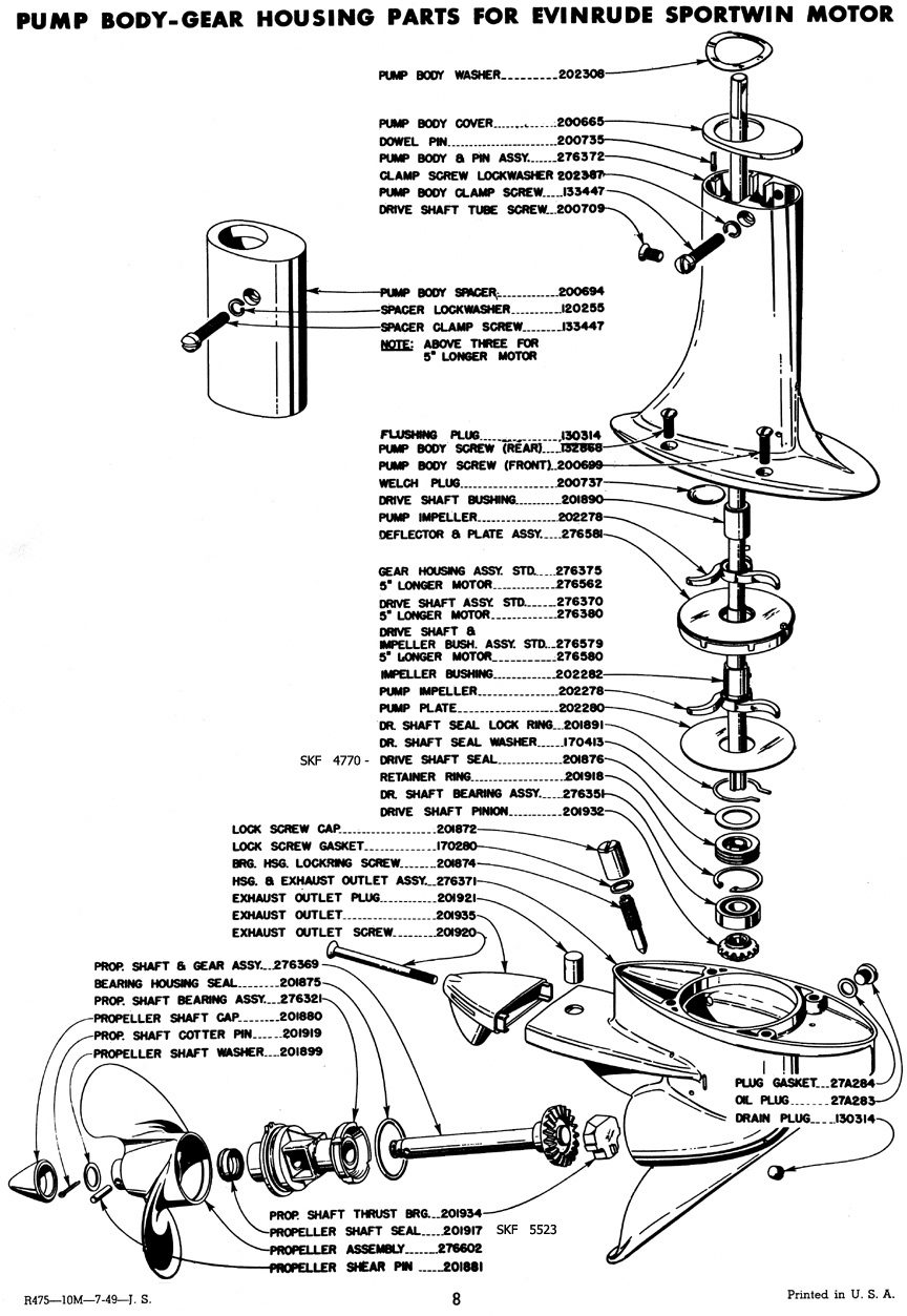

            I should know as I rebuilt/restored one of these motors a few years ago but can’t quite remember.
            Maybe these diagrams will help.
            4423_Blk
            4423Swvl
            4423_L.U
