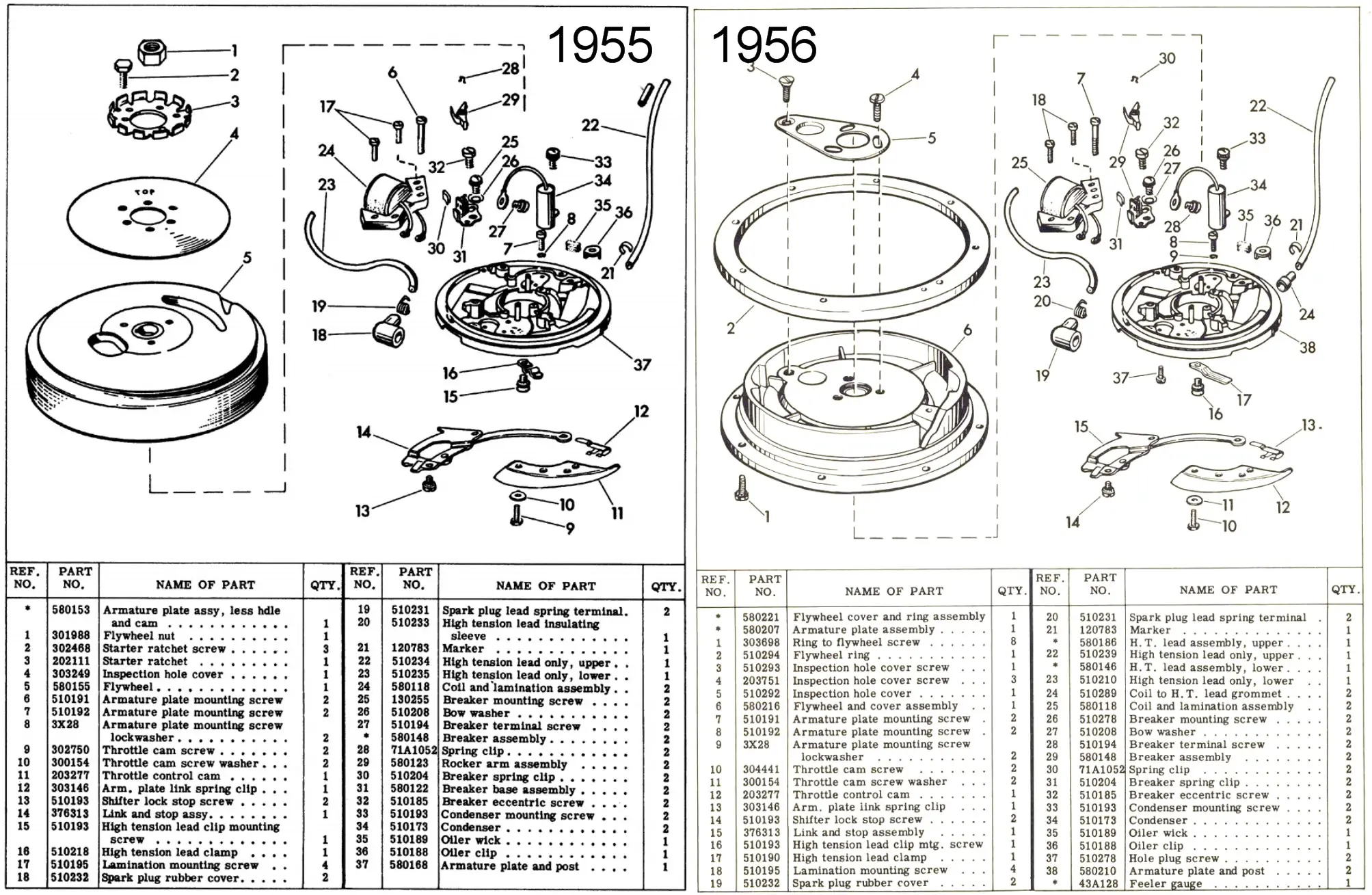

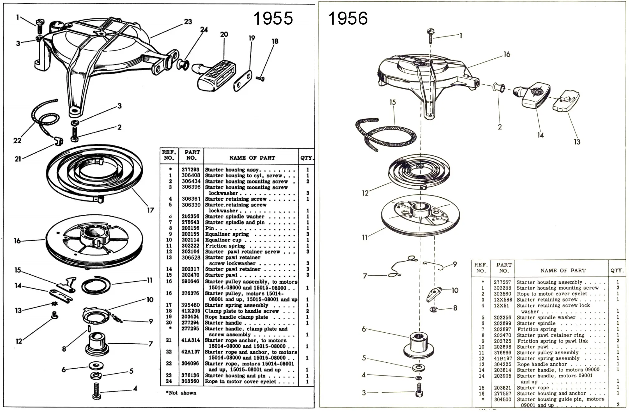

      So I have all three, none have recoil starters, the 15016 power head is seized.  Do they all three use the same recoil starter?  The 15012 and 15014 seem good power head wise.
      #325011
      Steve D
        The recoils changed in ’56 along with the flywheels and mounting brackets.
        2-recoils
        2-flywheels
