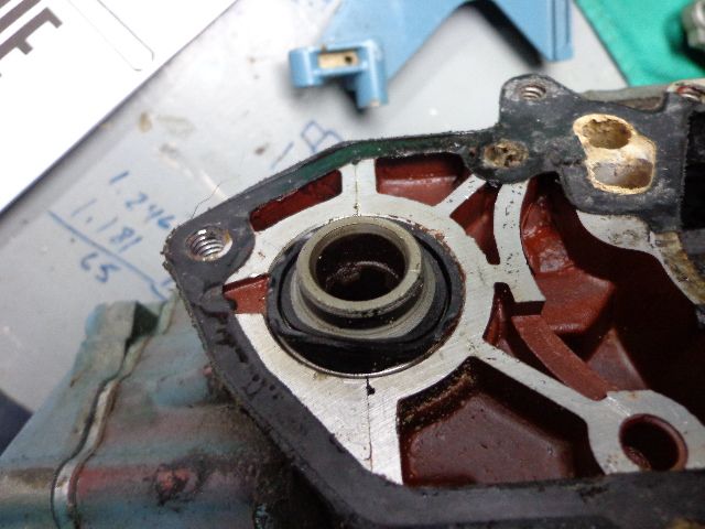

June 23, 2016 at 10:53 pm #38833Here’s a pic of that lower crank seal which likes to fall out or disintegrate and a link to the same ’63 Gale built Viking 15 horse running on a lake. I find the 15 is no screaming powerhouse and I can easily notice the extra power of an 18. Watch the video and compare it to your motor. ☺
