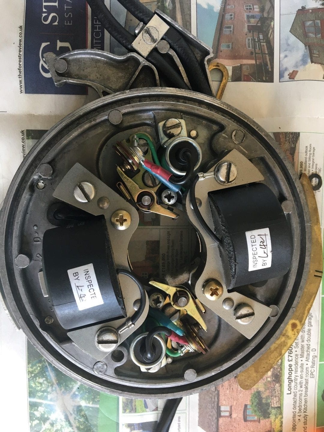

      Hope the pics are OK – for some reason the facilty wasn’t there when I posted the other night…
      I have completely removed the kill circuit wires, just had no idea what was going on under there with the flywheel on, so needed them out the equation for the time being.
      The smooth HT wire shown in the pic is my replacement (changed over to be upper, has the ali ‘top’ tag attached.
      Still getting 7-8 OHms on each new coil, new points set to 020 and clean, new J4Cs set to 030. Flywheel magnet appears strong. Mag plate can be eaten off. Both HT leads were scrubbed clean and checked. New capacitors fitted.
      So, perhaps the Zhongfadz coil is suspect, but a. I’ve swapped them over and always got a spark on the bottom pot b. it’s reading is in line.
      Or it’s positioning could be out, but the heels are pushed right back inline with the plate & the coil worked on the bottom. Points are Turkish made, but OEM I think.

        Is this the right way up in it’s ‘carrier’?
        #175230
          Yup
          #175304
          fleetwin
            Well, first may I compliment you on how nice and clean that mag plate is….The only thing I see that may be troublesome is the positioning of those condenser wires…They should be positioned more horizontally on the points so they don’t rub against the flywheel. I don’t think this is the cause right now, you would see the rubbing on the leads, but sure can cause trouble in the future. Looks like the coil primary leads don’t have any insulation on the ring terminals, not that this is a problem, but be sure the leads aren’t inadvertently grounded. You have had this apart so many times, I’m guessing this is not the issue either. Watch out for the positioning of the primary lead as it exits the coil and runs near the crank also…. Are these components OEM? I know you mentioned that the coils are aftermarket, but the points look aftermarket also. I see that you have replaced one of the plug leads, you may as well replace the other one while you have it apart again. I see that you have removed the stop leads from the mag plate, so they are not causing the issue.
            How are you checking spark? The spark should be able to jump a 1/4″ gap while cranking, but I am assuming you don’t have one of the conventional spark testers and are just grounding the plugs to check spark.
            Finally, the beveled edge of the aluminum threaded mag plate retainer should face down, towards the gearcase. Be sure to use the OMC moly lube in between the retainer and the brass retainer ring, apply a little moly lube to the top of the brass ring where the mag plate rides also. A bit of moly lube should be applied to the brass mag plate bushing also. Proper lubrication is critical here for two reasons….Not enough means premature wear and excessive sideways slop/play. Too much means the excess lube gets into the mag plate and fouls the points….

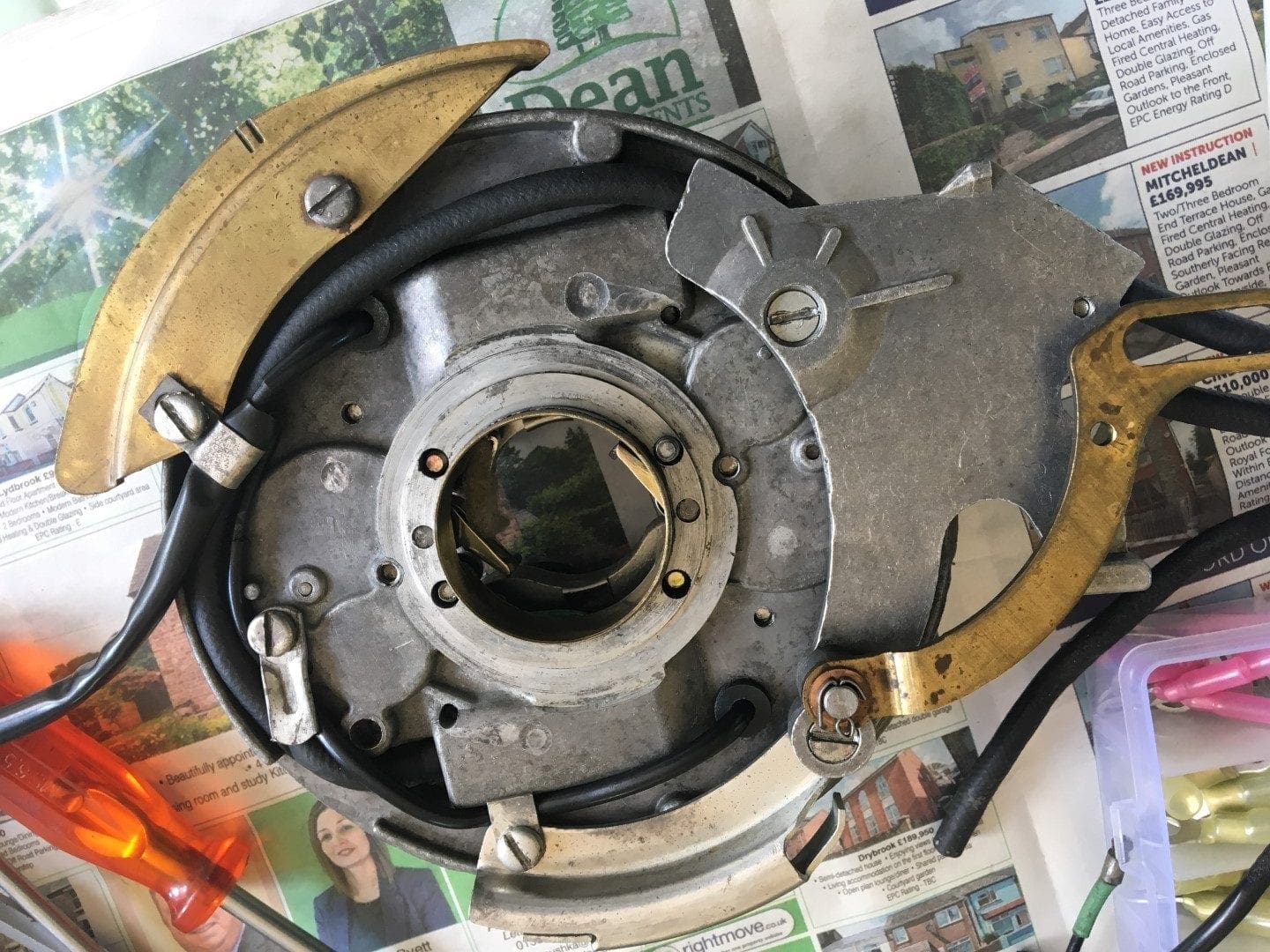

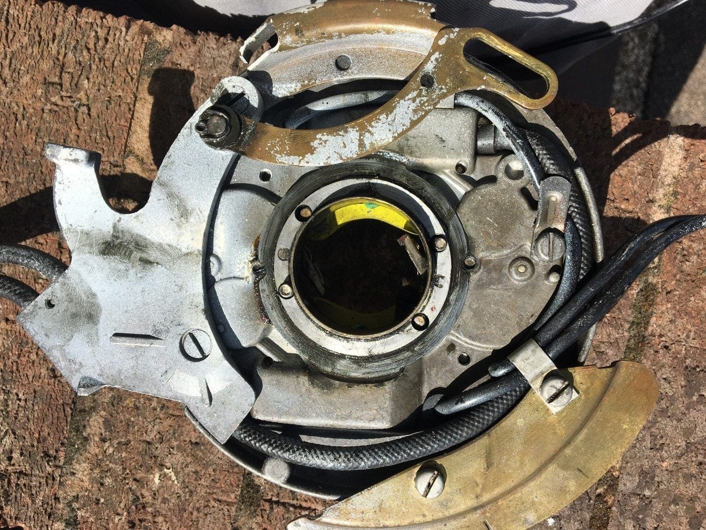

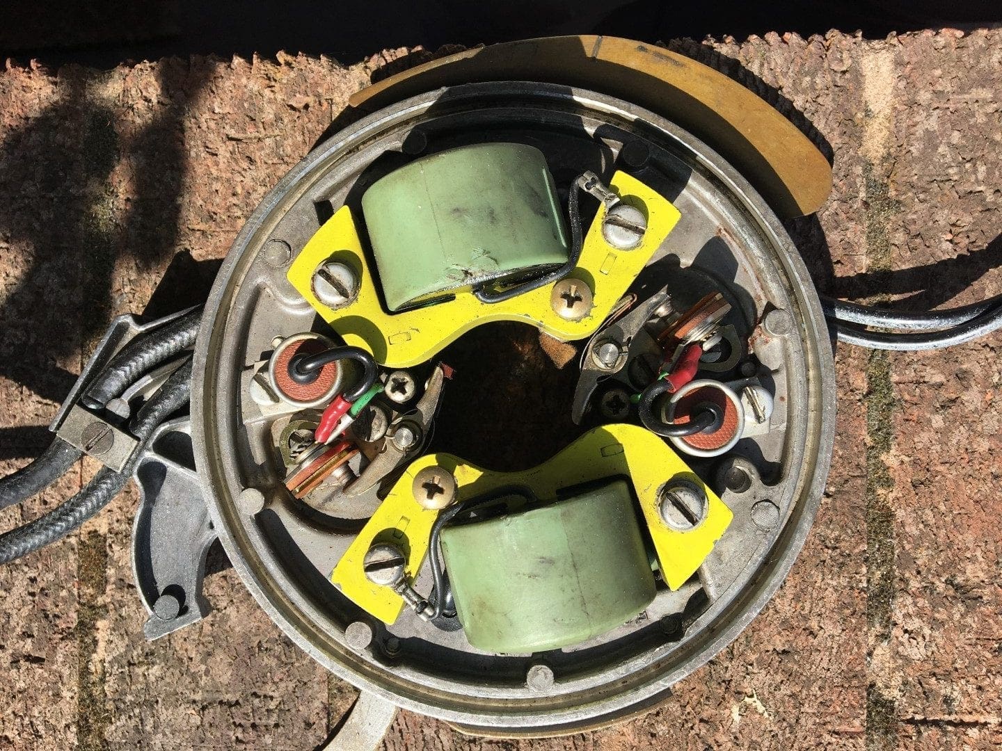

                  Thanks for the welcome comments Gents, before seeing the latest replies I went down most of the route above, looking for anomolies..and having looked closely at the mag plate (am using 2-4-C to lube), positions in relation to a reference mag plate (see below) for anything out of ordinary.
                  After picking up the old mag plate from an RD, setting the points and getting 2 decent sparks (unfortunately it belonged to a motor that wasn’t mine.), I have just walked away and removed the coils from the plate.
                  I just couldn’t trust the Chinese coils and the points had higher profile rubbing blocks and what seemed like a different shape springs vs. OEM points. Anyway, awaiting delivery of 2 OEM coils this weekend, they will join the OEM points and 2 fresh out of the packet OEM capacitors. I also have 2 extra spares mag plates in case the lateral wear is too much and some cable to make up HT leads with.
                  Will keep you posted.

                    Following the arrival of 2 OEM coils, I went back to step one with a used mag plate, but am still getting no spark on the top cylinder..I did test my motor with a known good mag plate (that I don’t own) and it produced 2 good sparks.
                    So, as of today:-
                    – 2 new OEM coils – continuity / resistance is 4.65 & 4.77K OHms (between the block and the spark plug boot end)
                    – 2 new OEM condensers / capacitors (fresh out of the packet) – not sure how to test with a digital meter on OHms..if the top one is shot..I could swap them..
                    – 2 new spark plugs – Champion J4C set to .030 – bottom plug sparks with the plug I used to test No1 (holding the plug to earth on the head).
                    – 2 new HT leads I made up from new 7mm wire (continuity tested ok) old boots and tangs used
                    – 2 new sets of OEM points, set to .020 – clean (readings of 0.03K OHms normal closed, (+0.01 above reference reading) and 1.1K Ohms open, also normal readings)
                    – an old spare mag plate (spotlessly clean) used, with little lateral movement, lightly greased with 2-4-C where it should be. The reference plate is the pics of the green / yellow coil version.
                    – kill wiring isolated from the anti-pop and ignition circuit, with both of those hanging free (I fitted new ring terminals with heat shrink in order to ensure there’s no earthing)
                    Am unable to come up with anything further, or further tests I can try perhaps to find if there’s any earthing to ground, stray discharge?
                    IMG_1507-Large
                    IMG_1508-Large
                    IMG_1461-Large
                    IMG_1465-Large
