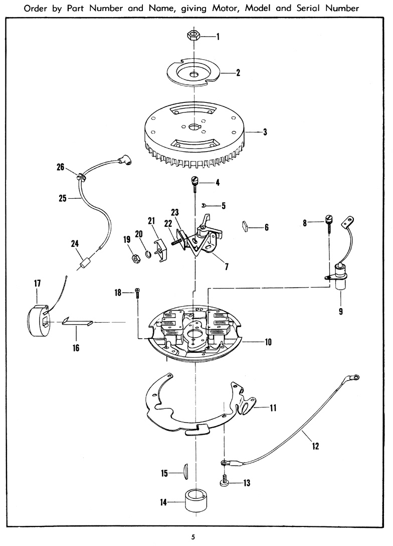

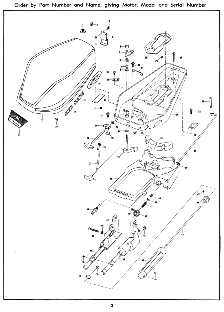

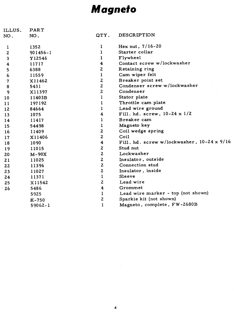

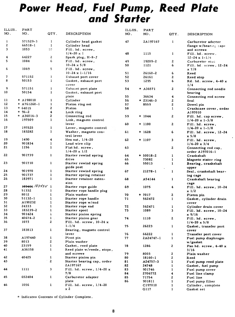

              Or this? Model numbers are important. Especially with Chrysler Sea Kings, because there were so darn many of them. This is a 1973 model VWB27400
              image urlcertificity.com
              picture uploadercertificity.com
