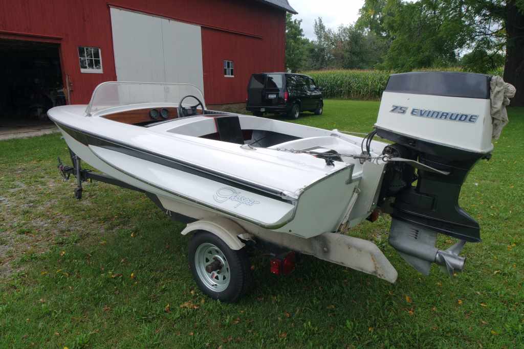

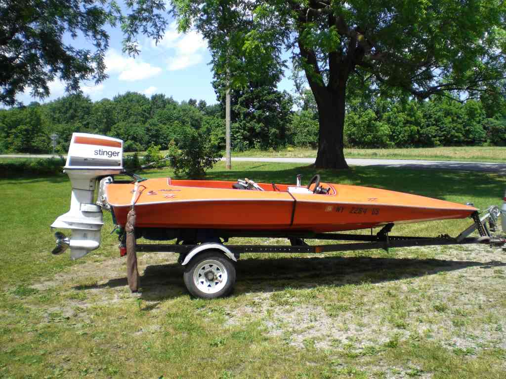

These are great engines, but plan on doing a total powerhead rebuild on any used engine you find, it has probably been used hard and is ready to be "refreshed". Like others have said, piston skirt cylinder fit is critical on these engines. Simply honing and re-ringing is not going to address this issue.May 15, 2017 at 2:46 pm #57754I have two Stinger/Hustlers. One is a long shaft 1975 Stinger on a Hydrostream Vixen. I am messing with jacking it up and will add a nosecone. It has the large gear case w/3 water pickup holes. The other is a 75 Evinrude short shaft and has the small bullet w/4 water pick up holes. The large gearcase gear ratio is 12:29 and I am using a 22" pitch prop. The small gear case ratio is 15:28 and I am using a 17" prop and get 52 mph @ 6000 rpm. The G3 also has a steering bar and tilt and trim. These motors are still raced and the tilt/trim is a unit used by the racers.
