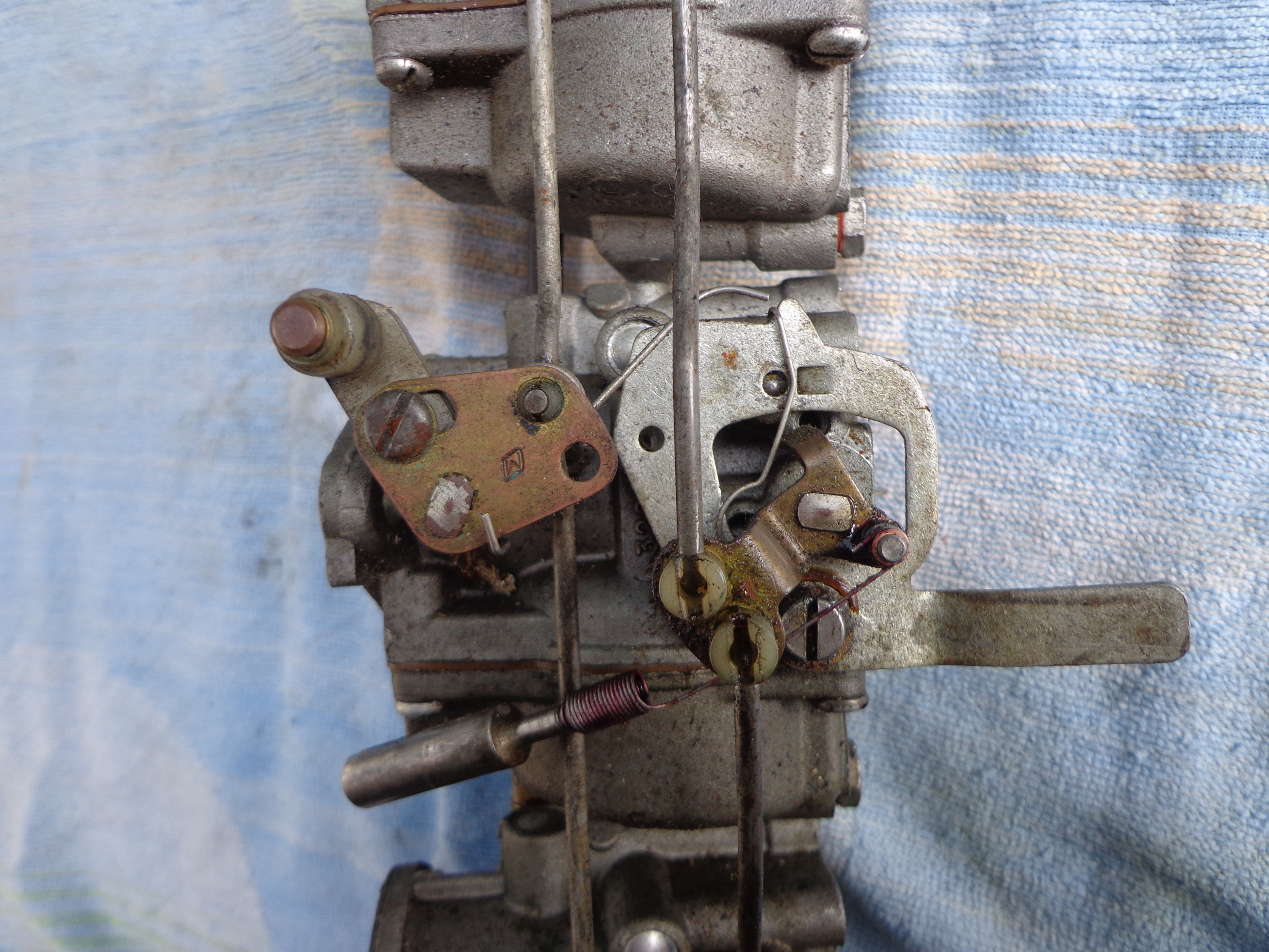

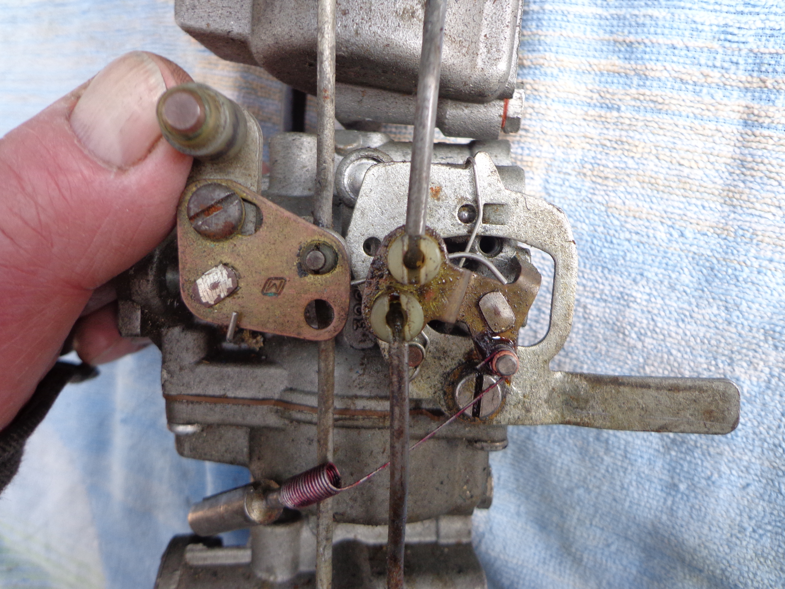

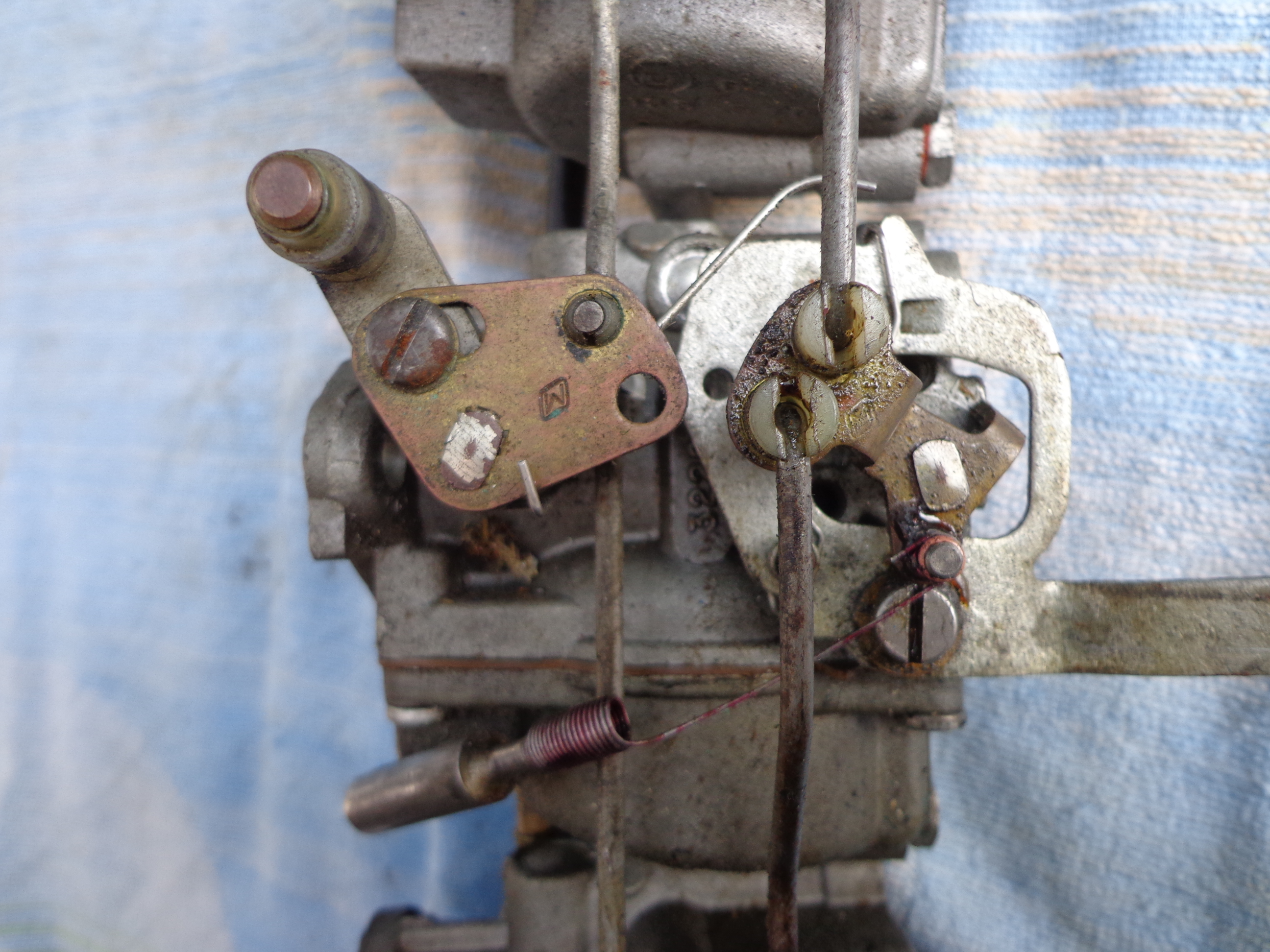

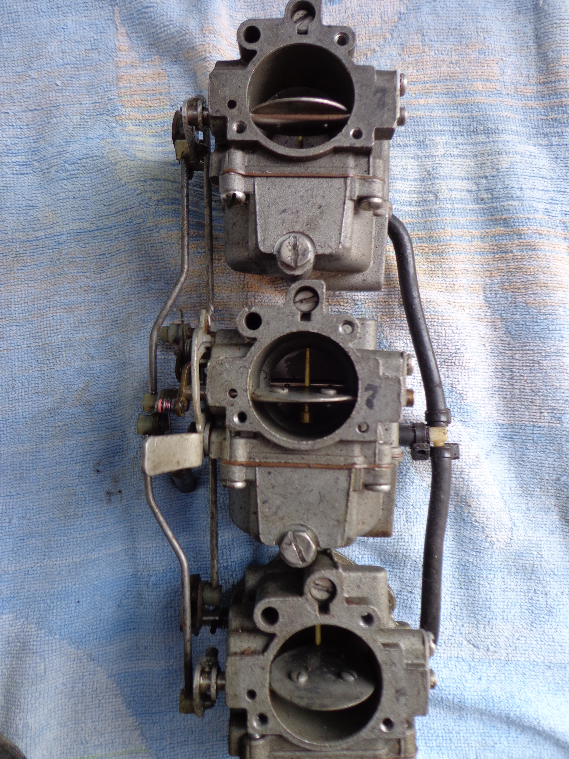

March 6, 2017 at 3:55 pm #53942Here are pics to explain things better. I pulled the carbs to clean/inspect for a service order and putting it back together, I can’t remember how this spring goes back on! Hence my plea for assistance!
The last picture shows how the choke flaps are staying partially shut when I let off the key switch/choke solenoid. I suppose they would probably just open up once the motor is running but it needs to be done right.
I believe the center hole on the spring goes around the little plastic keeper on the left brass hardware, and the hook loops under it to set it in place. The ‘arm’ of the spring reaches over the choke flap brass piece and tensions it back down to swing the flaps open when you let off the key. But when I put this on in this configuration, it doesn’t do it’s job. It was working when I pulled it apart, so I’m missing something here.
March 6, 2017 at 6:56 pm #53949I’m pretty sure the choke butterflies open by gravity and airflow past them. The spring makes sure they open as the throttle is advanced.
In the photos you can see how the butterfly shafts are offset with the larger half of the butterfly on top of the shaft making them top heavy. Also, the weight and geometry of the linkage will help to open them. The spring slides onto the nylon bushing before it is snapped into the throttle linkage plate and the long end goes over top of the choke linkage.

March 6, 2017 at 7:11 pm #53952Thanks Mumbles, glad I wasn’t going crazy. I had the spring in the right spot, but thought it was supposed to apply a downward force on that brass carb hardware. I see in your picture it is set up the same way the one I have here is.
