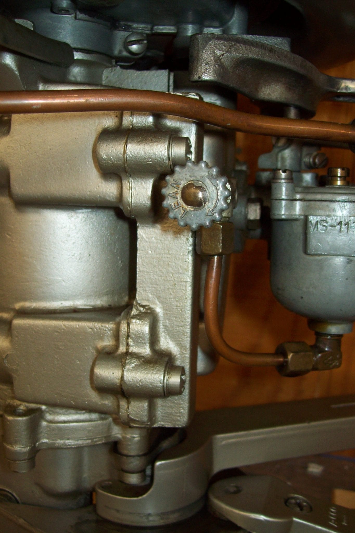

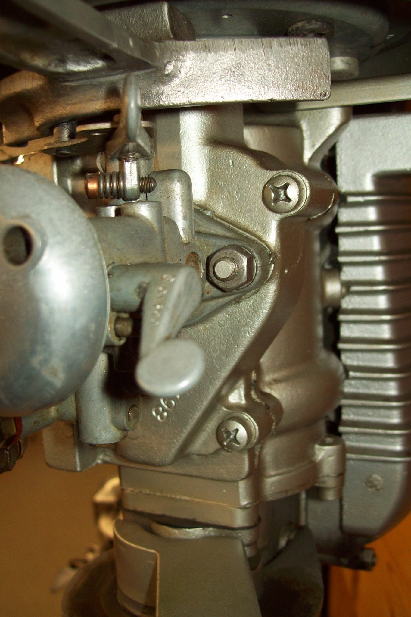

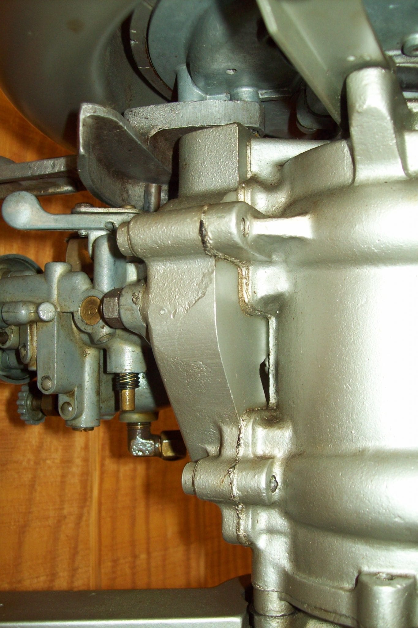

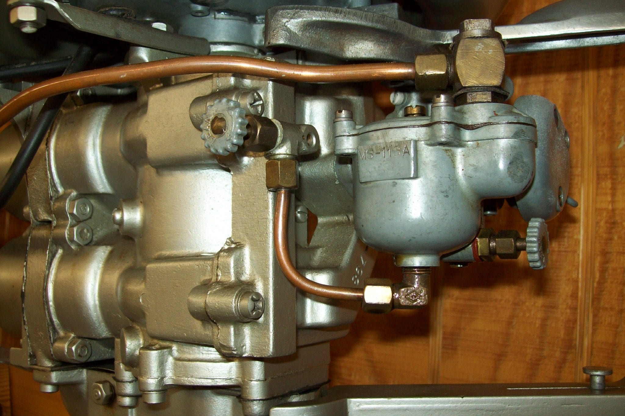

      Looking for parts list and diagram for subject carb. This is the one with (high speed needle valve, in combination with auxiliary carburetion for idling with separate idling adjustment ).Statement in ( ) straight from owners manual. Thanks for any info or input as not much info online. See attached photos.

            Have done some more research On the Tillotson site and emails from them that helped and found a model number on the carb ( after removing several layers of paint ) MS-113A
            If anyone has and info on this carb it would be very much appreciated.

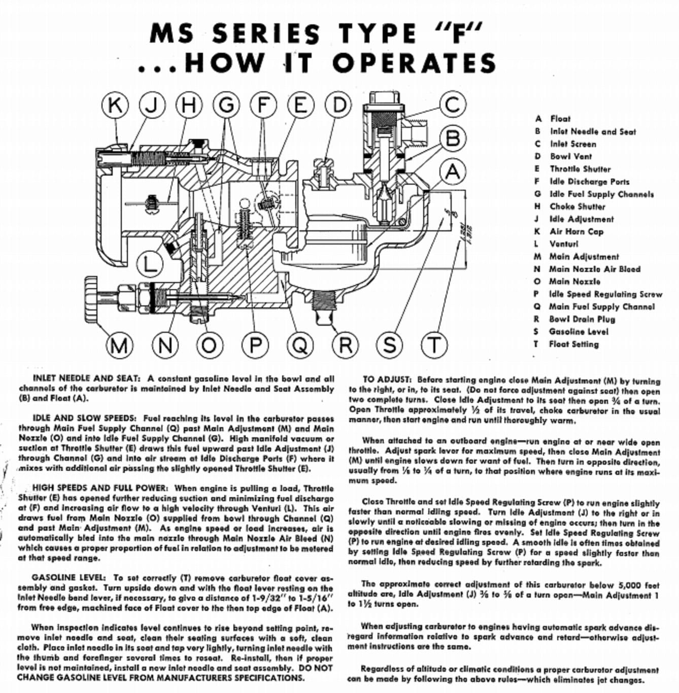

                #199443
                  I found this in my files……
                  Tillotson-MS-type-F-adjustments

                    ROBERT LAFAYETTE
                      Some carb pics provided to Lou from Bob Grubb!
                      Thanks Bob!!!
                      105_3912
                      105_3913
                      105_3914
                      105_3915
