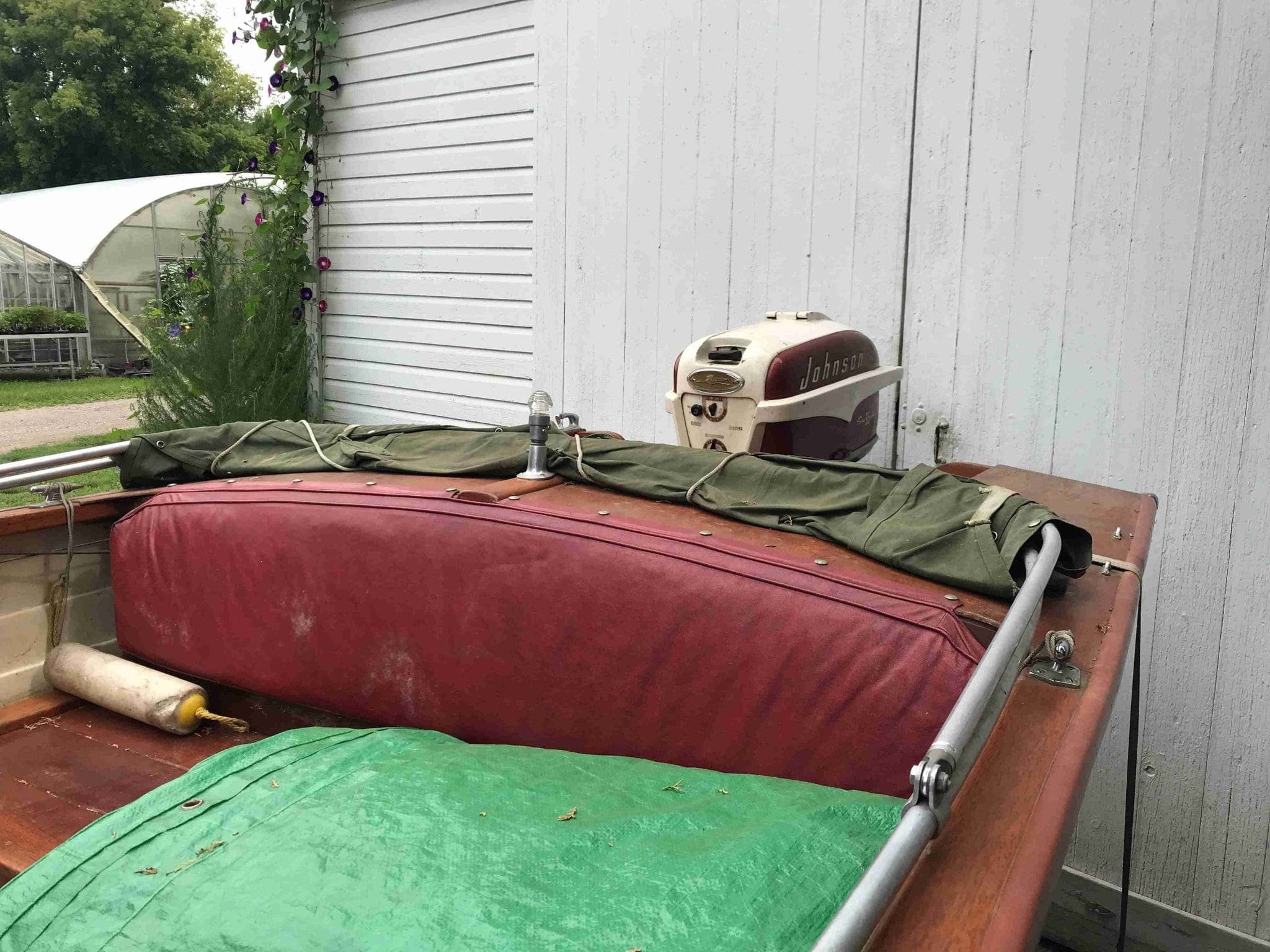

      First super pumped for the help. I just bought a 1958 MFG with a 35 HP Johnson Sea Horse on it. Is this a 6V or 12 V motor. Can I/ow do I convert it to a single fuel line motor.
      I am sure I will have more questions but this will get me started
      Thanks,
      Tim

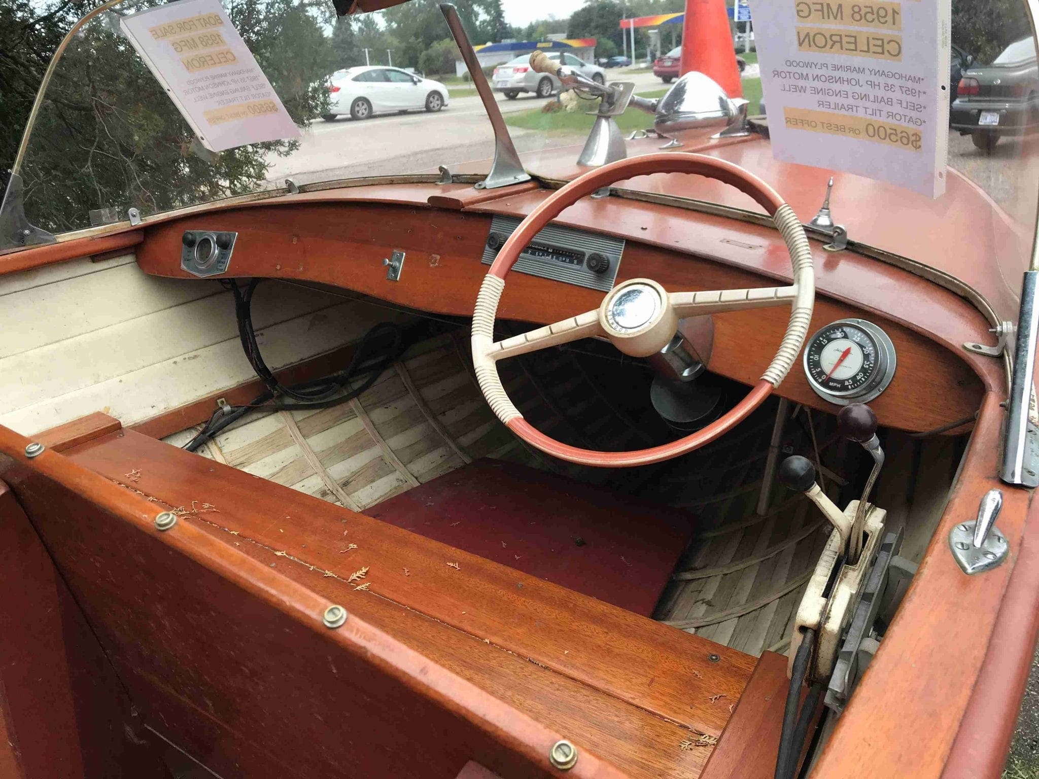

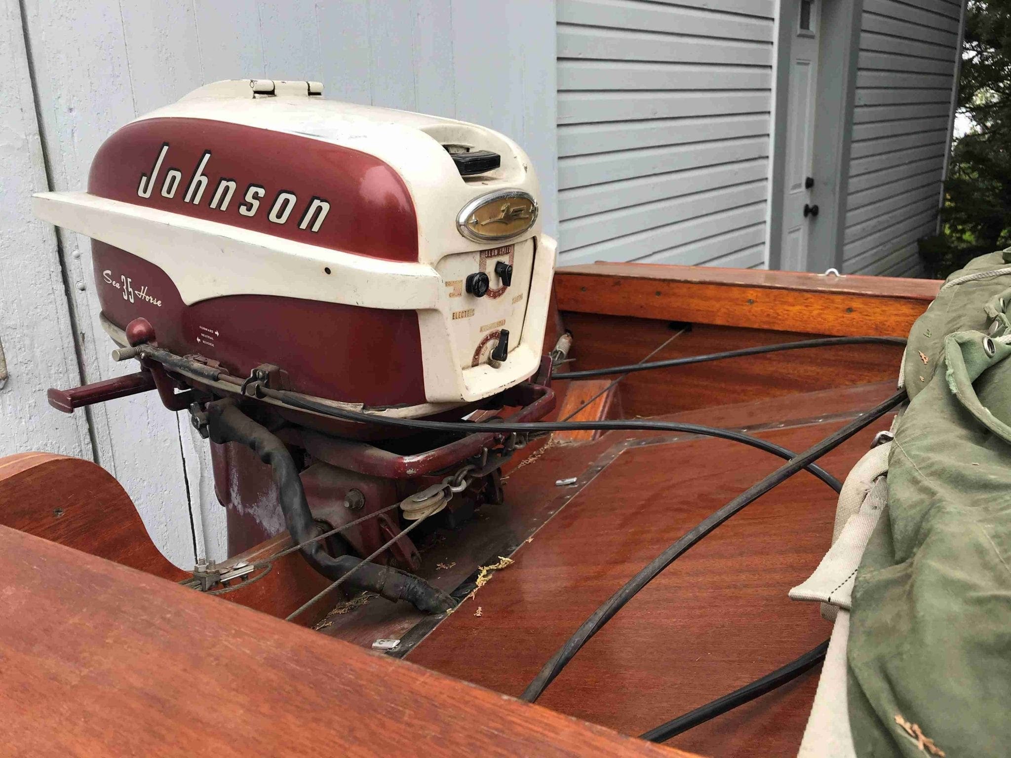

        Not a 58. Not a 59, but a 12 volt 1957 RDElectric! And it has the hard to find boat side wiring harness with the electric box inside the boat. Nice find!

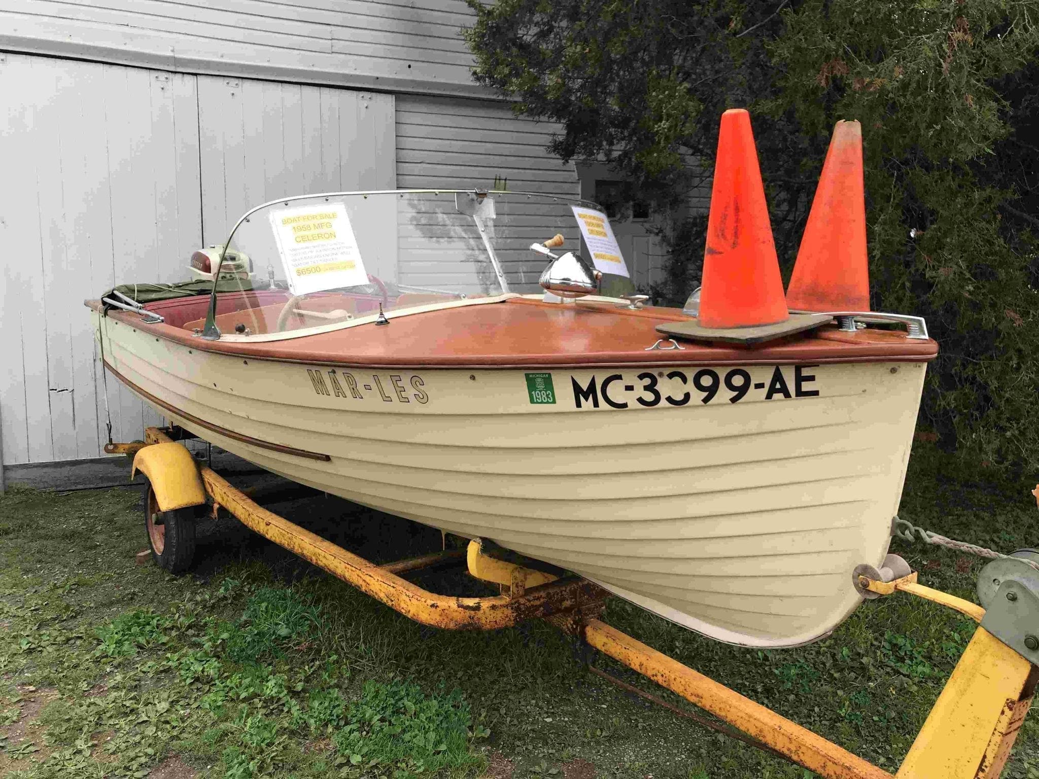

        Tim Krause
          Awesome thanks for the info. The seller had no Idea abut what he had.

            A very good buy indeed. Motor looks to be in good shape too.

                    the motor may likely need new coils if originals are still in and cracked same for impeller …no big deal to fix up points… carb kit maybe needed float may be shot and dried
                    this should be a fun project …don’t despair lots of help here
                    nice find ! check compression before spending more money on it ..just in case
                    btw OEM BRP coils costs are expensive but I have had great success with chineese coils (check EBAY OMC coils …some are free shipping to ! )
                    spark plug wires may need replacement using 7mm solid/strand metal wire (no carbon wires !) if you do coils do wires at the same time
