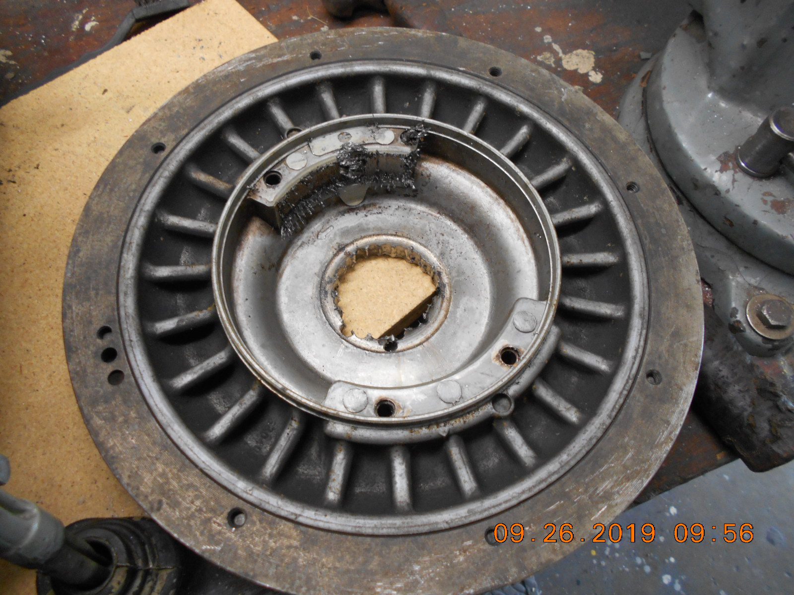

September 22, 2023 at 6:04 pm #280884This is the only flywheel I remember that would not eventually come off with normal means.
It was on a 40 hp Gale. I broke the OMC puller bolts, etc., from having the puller so tight.
Used a torch, whacked with a hammer, PB Blaster, etc.
I finally ended up destroying the flywheel to get it off.
Turns out that the flywheel key was terribly buggered up but the last guy
used it anyway.Prepare to be boarded!
