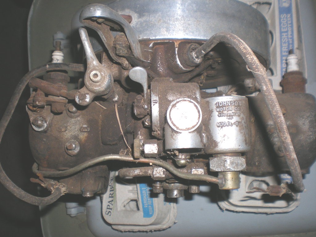

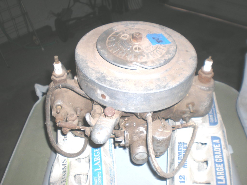

I came across a A45 Johnson and was wondering if someone could explain the purpose of the compression relief valve on the left cylinder and how to use it. Thanks in advance. TJI

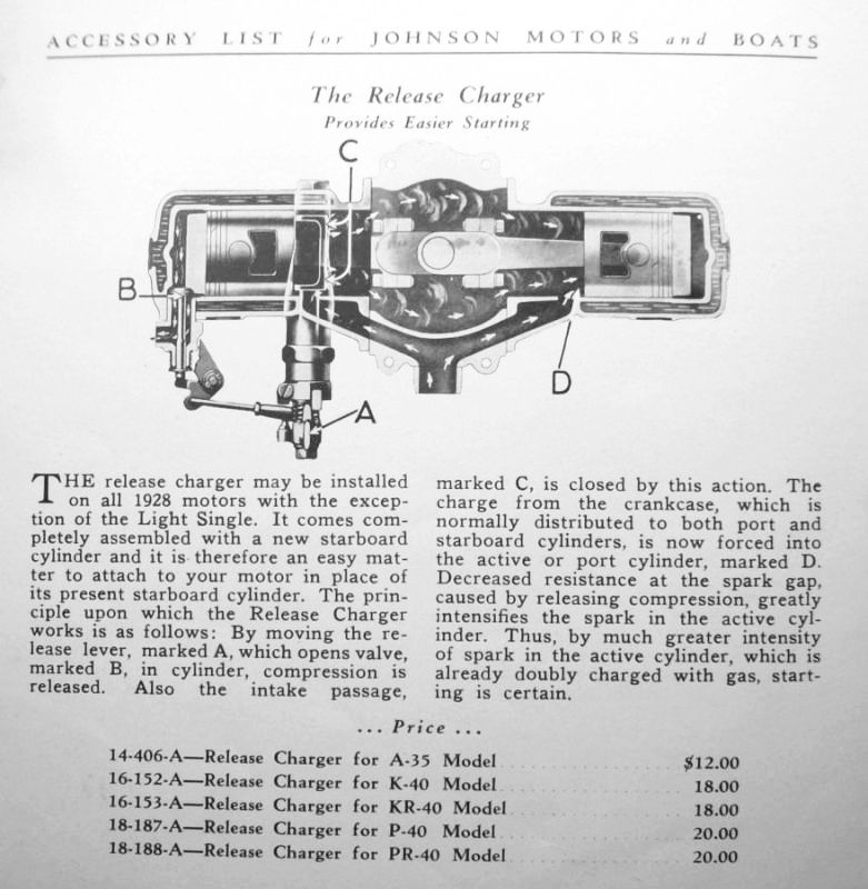

November 20, 2015 at 4:06 pm #27420The compression release closes off the intake port to the motor, which forces more air/fuel mix to the other cylinder. In cold weather, this might help keep the fuel from condensing out, and actually getting to the cylinder. The compression release also opens up the cylinder to the atmosphere, making it easier to crank over the motor.
I have owned and run A, K, S, and P motors with rotary valves, and never needed to use them. Choke the motor, bounce it a couple of times, open the choke, and start.

November 22, 2015 at 2:19 am #27493Thanks for the info on the A45. Looking at the picture I can see how it works. My motor is missing a lot of pieces, any additional info on this motor would be greatly appreciated. Thanks, TJI

November 22, 2015 at 6:41 am #27498Not sure if I can help much, but that particular model is the last year of the opposed twin A model Johnson built. In 1930, the model became the A-50 (4hp) and it was an alternate firing twin with the revolutionized "under/over" engine design, which is still in use today. By 1939, the model had become a 5hp. The 1938 was the 4.2hp and the last model year with the "all cast iron" cylinder assembly. 1939 was aluminum with cast iron cylinder linings.
Believe it or not, that is also the model that the old TD, CD and all the other 5 and 6hp Johnson outboards derived from.
The LT became the TD and the TD became the TN and then the CD went from there.
Enjoy that old classic. You will be amazed at how easy it is to run and how reliable it is. The old Johnson A model was the motor that made the definition on "old outboard reliability"November 22, 2015 at 7:58 pm #27517November 22, 2015 at 9:55 pm #27527I like my A-45. I often use the compression release to start it, makes pulling rope a bit easier. Very reliable.
