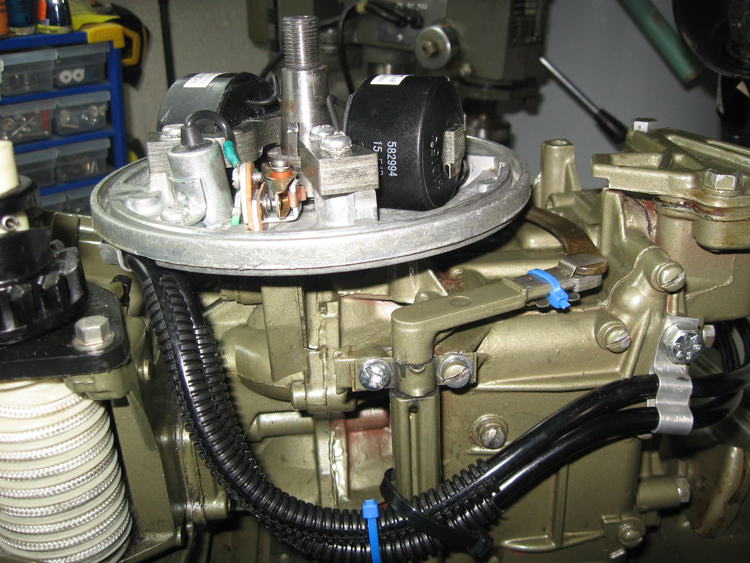

            I went an extra step… to prevent any rubbing my new wires
            this sould last till I start cracking up…. 😯
            btw the condenser is ok….
