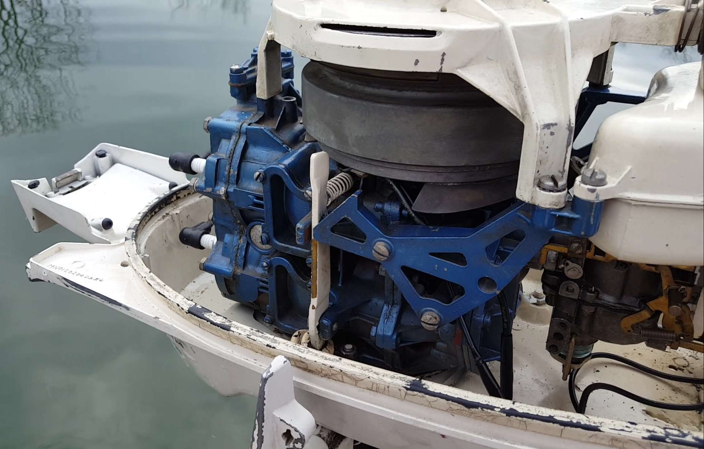

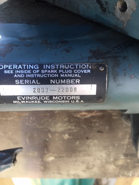

Picked up a couple Evinrude project motors and a pressure tank yesterday for $60. Turns out one is a complete 1952 25 hp, and the other is a 1957 35 hp that is missing at least the flywheel and motor cover. I will be working the ’52 with my son as a project for a mechanical restore before we look to resell it.
Got them home yesterday and took a closer look at the ’52 and determined it truly is a Johnyrude – looks like a red Johnson powerhead with everything else Evinrude blue! It turns and has spark, but we didn’t get it running yesterday. We ran out of gas pulling on the starter cord. I look forward to working on that one with my son. I need to get something with more torque to get it spinning.

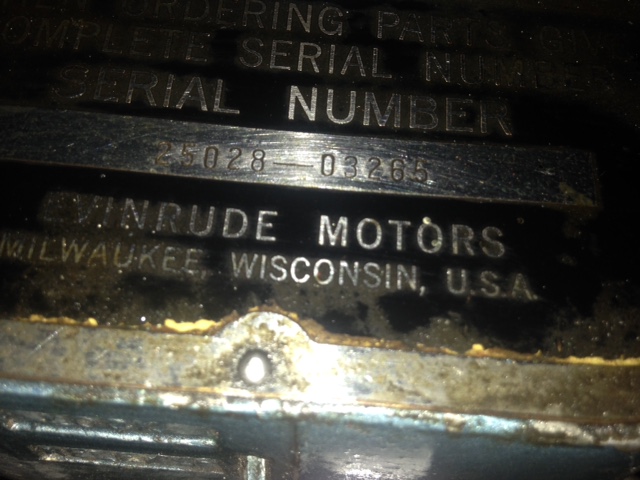

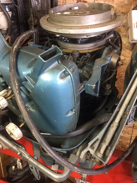

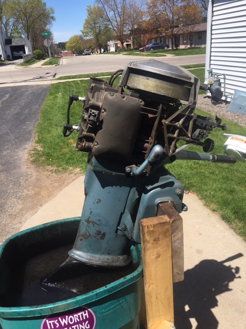

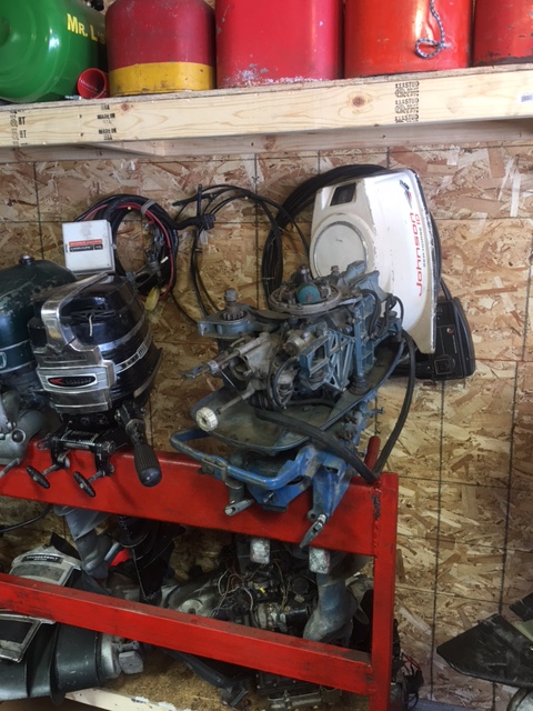

My dilemma is with the partial 35 hp. It is an electrified 25920, and the guy I bought it from says the starter works. However, not much good without a matching flywheel!! I also have a seized 1957 25028 35 hp that i was going to restore. It is complete, just needs a rebuild, but I have not pulled the powerhead apart to look for mouse nests and other issues. I did take off the intake and exhaust covers and did find extensive rust under the intake cover related to the rings. Other than that it was in good shape cosmetically.
How much would parts interchange considering both are 57s? Can I just swap powerheads – assuming I get the correct flywheel for the new purchase? It is worth getting the partial running knowing that it is not complete?
Give me your thoughts on what you would do. Pictures below of the new projects and the siezed 35 hp.
May 8, 2017 at 5:55 pm #57304Johnsons were green in ’52, so what you’re likely seeing is the red primer they used By the time Johnson went to Holiday Bronze in 1956, the powerheads were quite different. Sometimes, the primer might indicate a replacement powerhead, as they were the same powerbeads, regardless of whether it was for an Evinrude or Johnson. They left it up to dealers to paint them to match – which often didn’t get done.

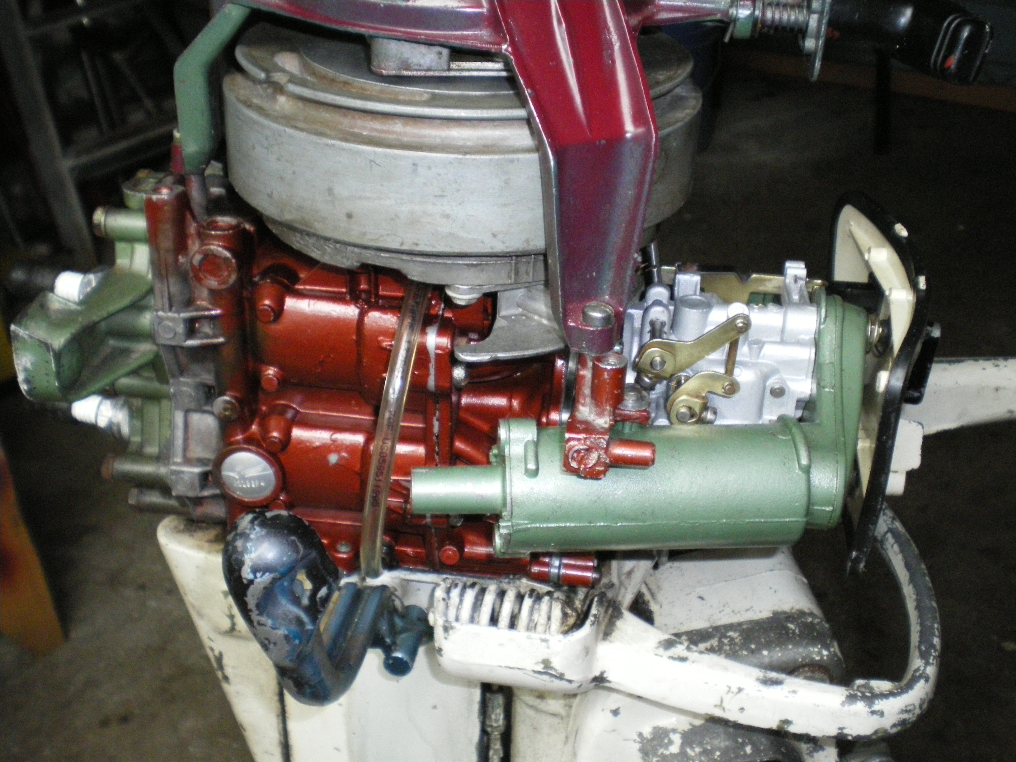

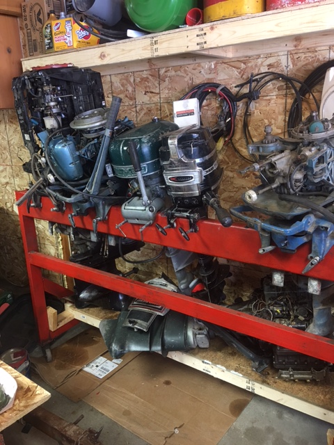

May 9, 2017 at 5:10 am #57334May 9, 2017 at 1:09 pm #57344May 9, 2017 at 3:04 pm #57349I call mine Johnny Cash, after his song "One Piece at a Time". Seven different motors donated parts to this project.
May 9, 2017 at 3:59 pm #57352quote Chinewalker:I call mine Johnny Cash, after his song “One Piece at a Time”. Seven different motors donated parts to this project.
That could be the record, 7 motors to make one complete running motor. Would be interesting to see more photos of these Frankenstien’s
Robbie RobertsonMay 9, 2017 at 5:23 pm #57358quote pugetsoundboater:quote Chinewalker:I call mine Johnny Cash, after his song “One Piece at a Time”. Seven different motors donated parts to this project.
I agree Jim! I’d love to see the various Frankenmotors that have been built out of spare parts from here and there. Maybe we should start a new thread for this. I know of a few that I have already seen pictures of on these boards that you’d never know at first glance weren’t factory original / correct. I have the utmost respect for that kind of work, but also really appreciate the ones like were seeing here that are built with the various parts left in their original colors and finishes from different brands and years.
Chinewalker, I love it! The Psychobilly Johnnyrude!
