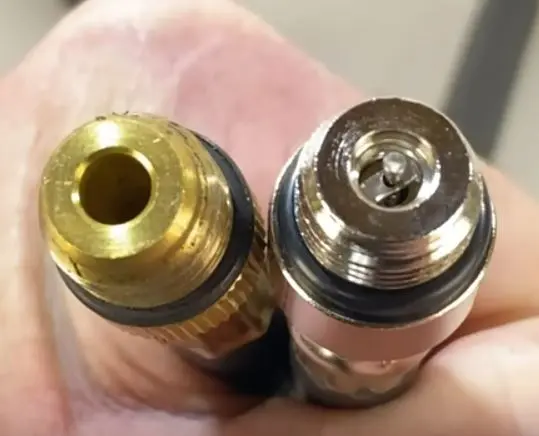

                  #303798
                  CHUCK
                    The location of the Schraeder valve affects readings on small volume engines.
                    Compression-Tester
