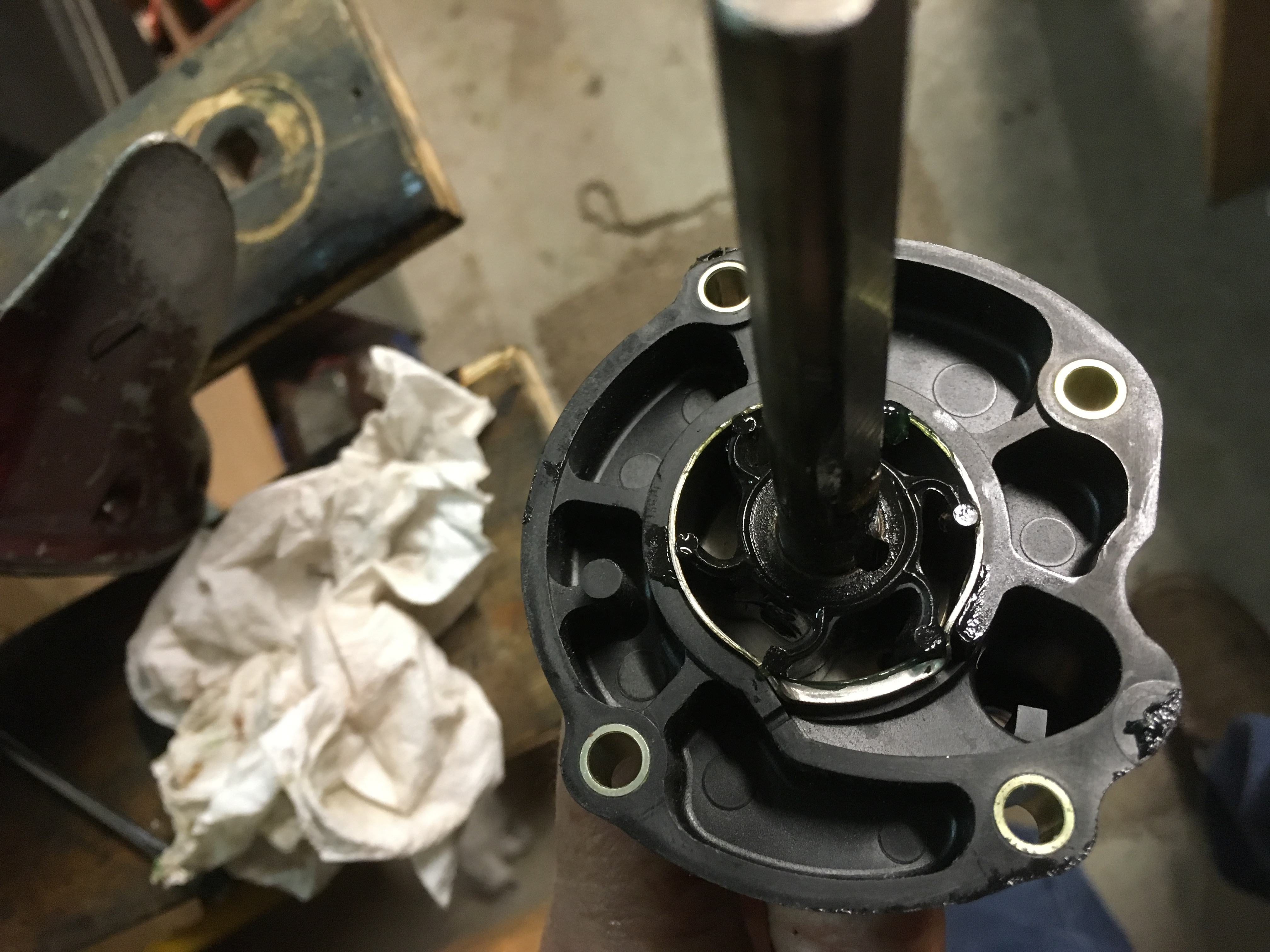

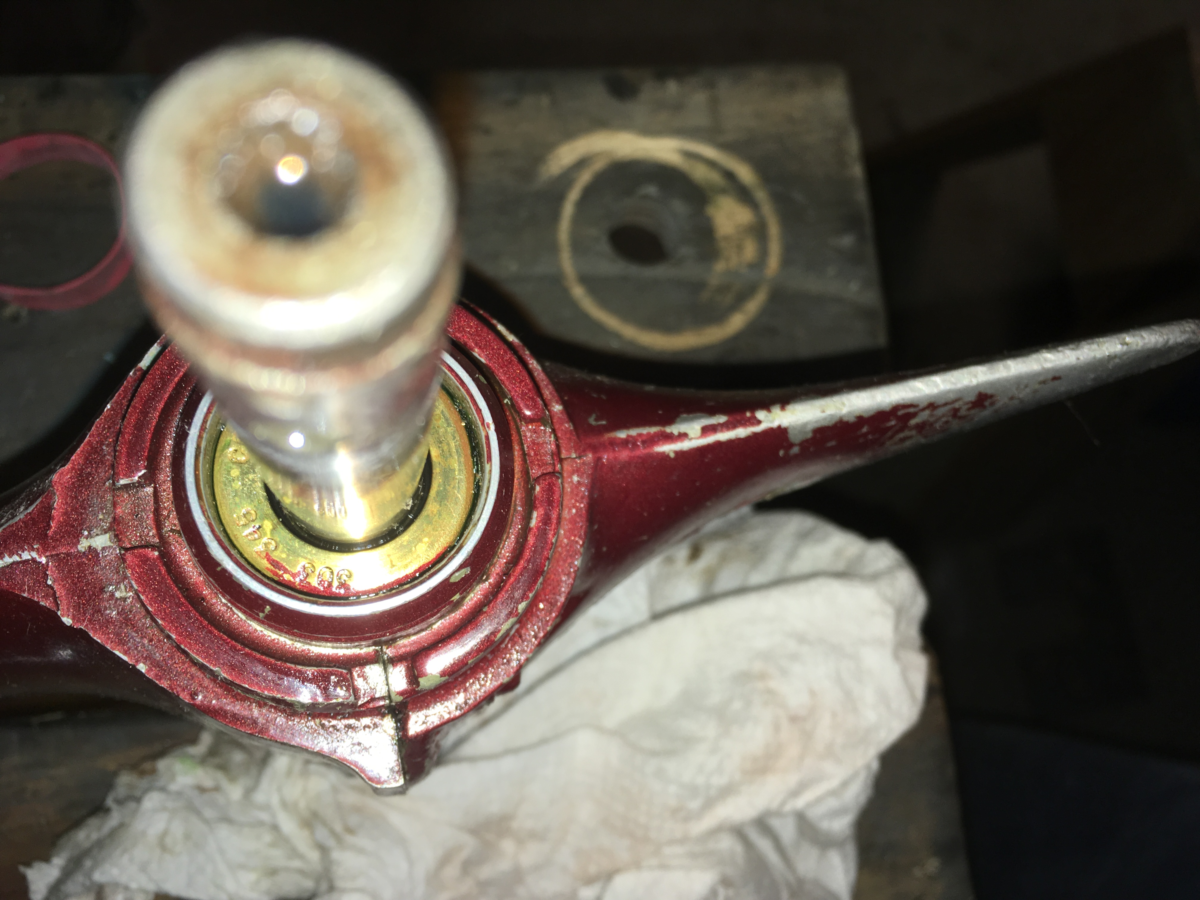

The shock absorber was not the issue having been permanently fixed by a previous owner. The water pump has been upgraded to the new style impeller and it was put in dry causing the tightness. A little grease fixed that.

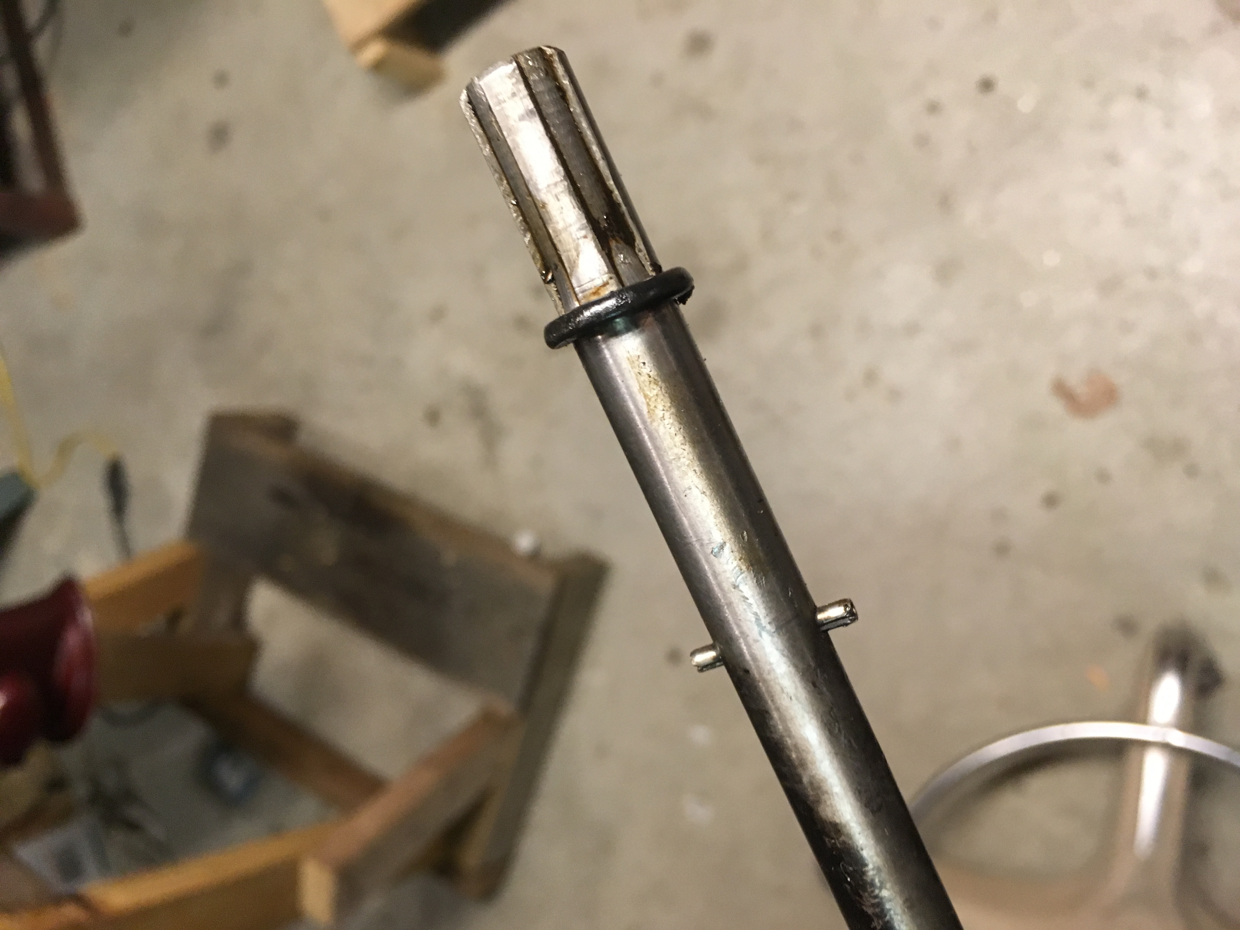

The biggest surprise is that after taking the time to fix the shock and upgrade the water pump, they left out all the seal pieces at the top of the driveshaft. Just a single o-ring with no groove to sit in. Go figure.

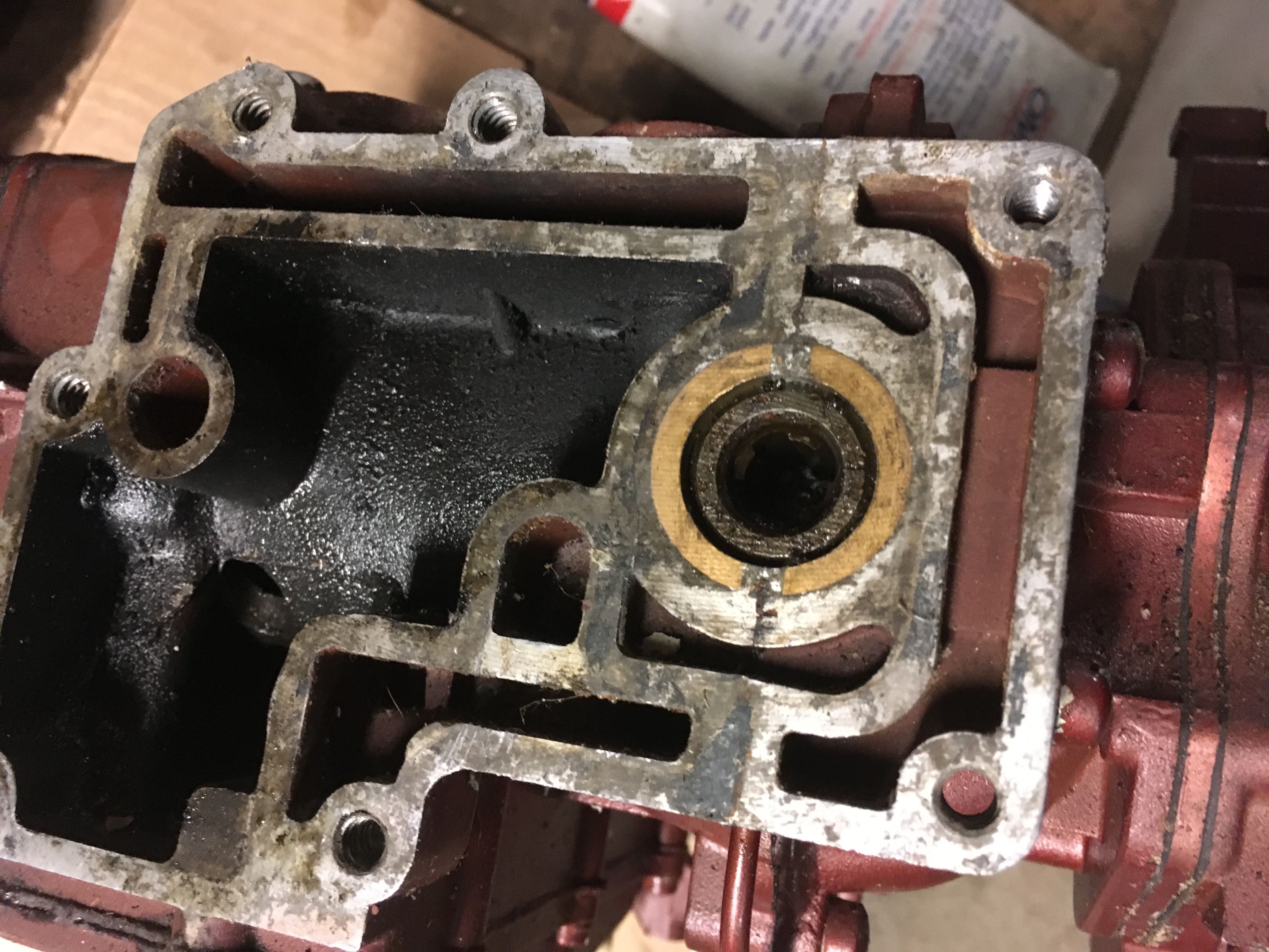

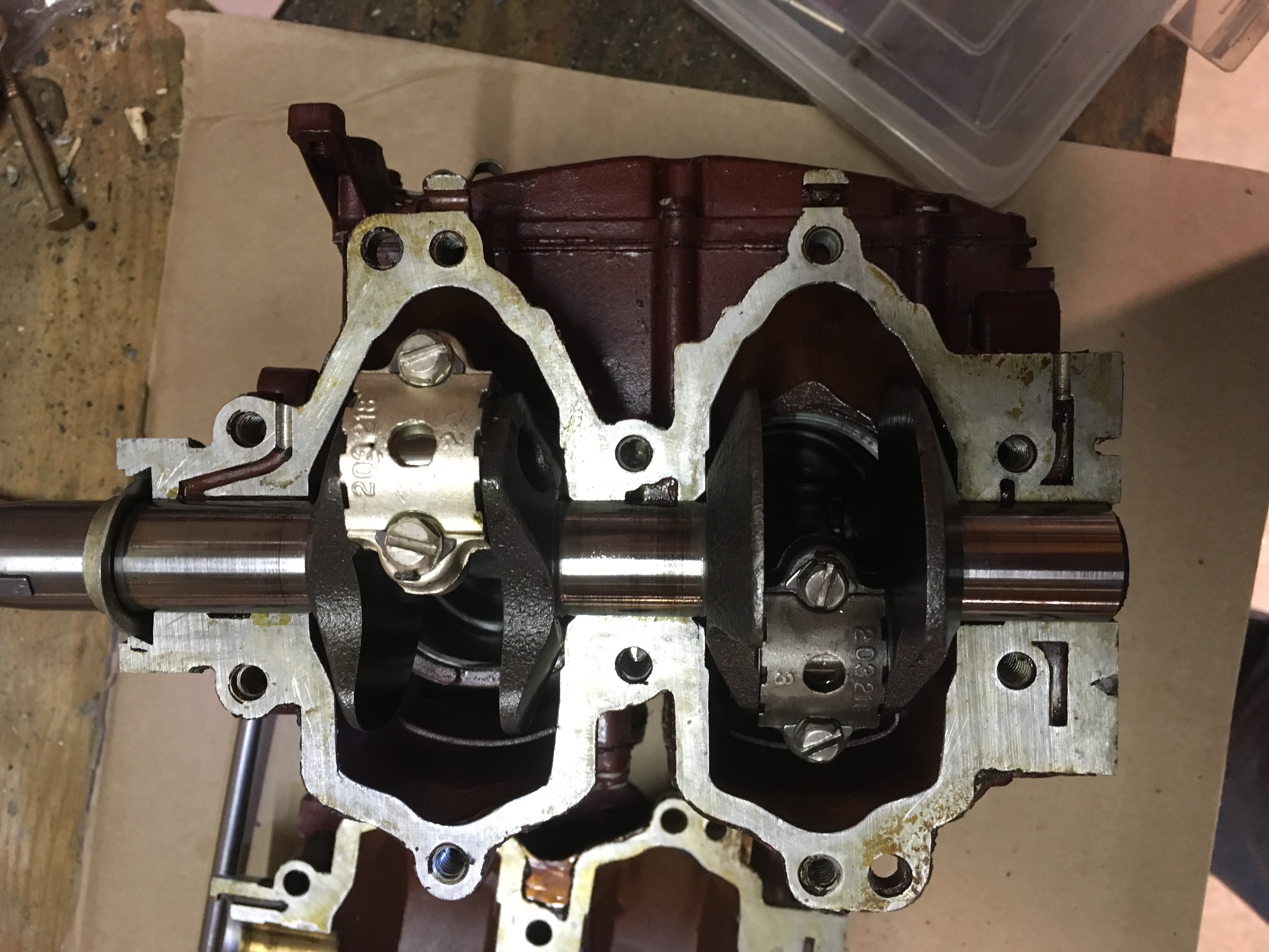

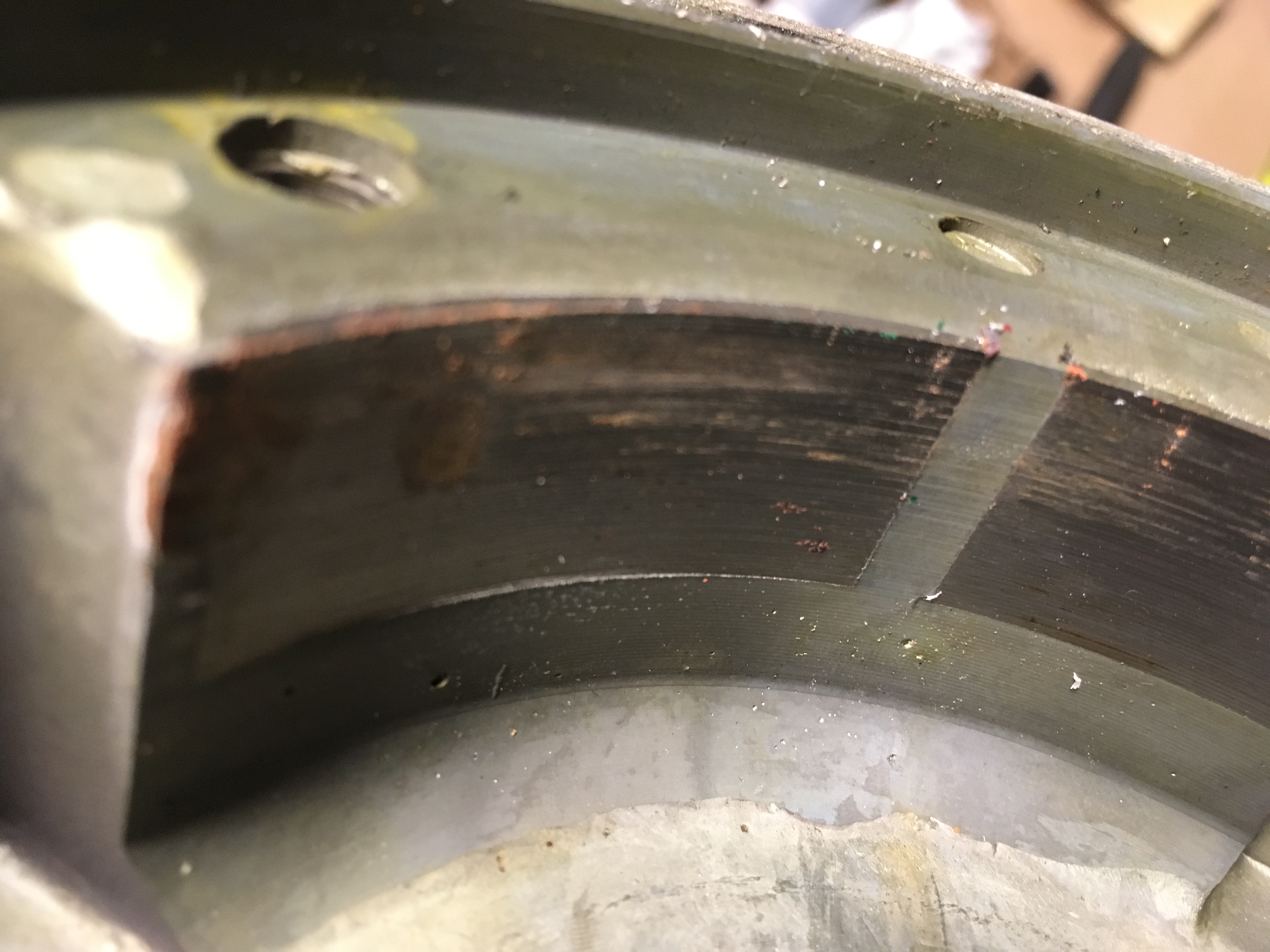

I have nice even compression numbers on this one. Paint and everything make me think it is a low hour motor, but you can never tell. I will likely have a peek inside to make sure the crank is ok on that bottom end.

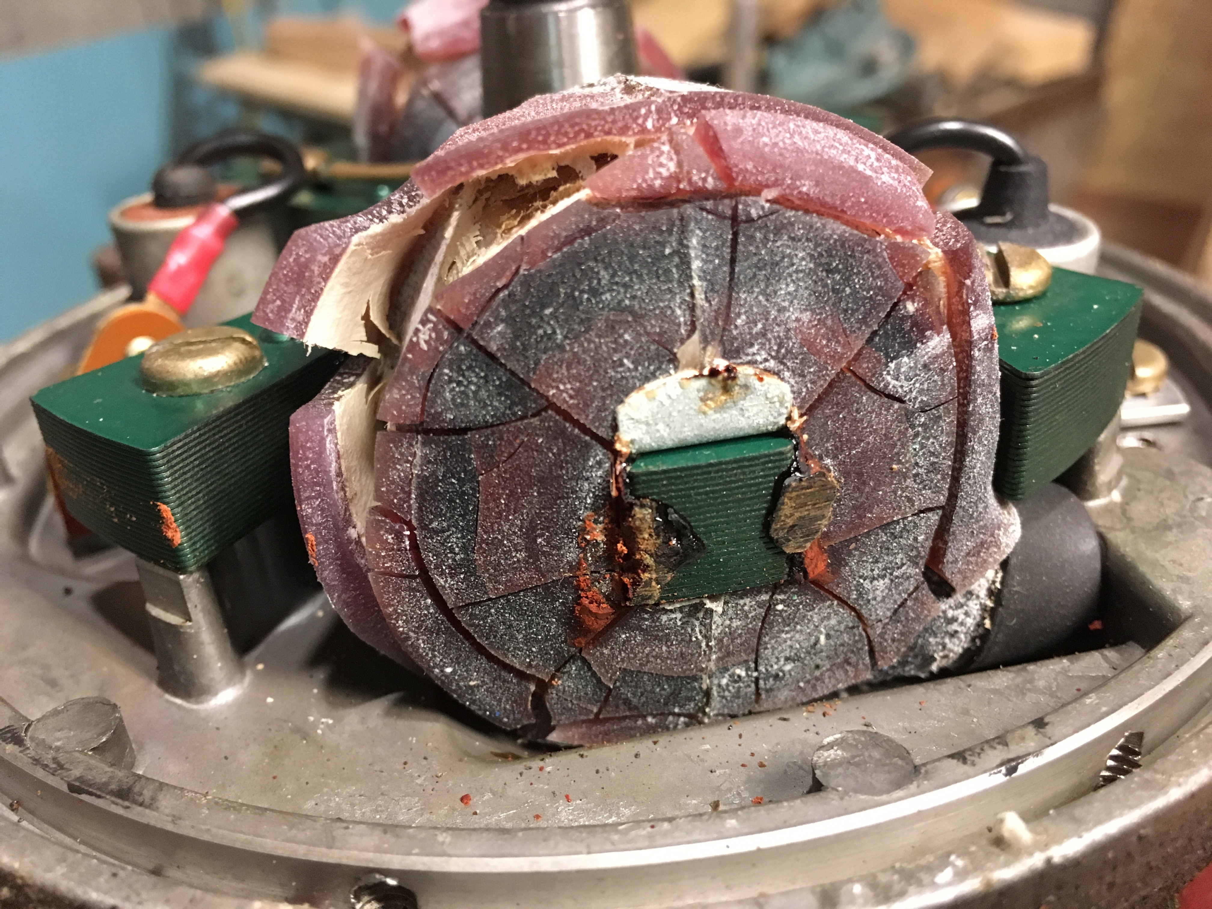

As I said above, this one was slightly stuck when I got it, but I am really thinking it was the coil stuck to the flywheel. I posted a pic of this in anther thread but will repost. The bore shows no sign of rust or scoring.

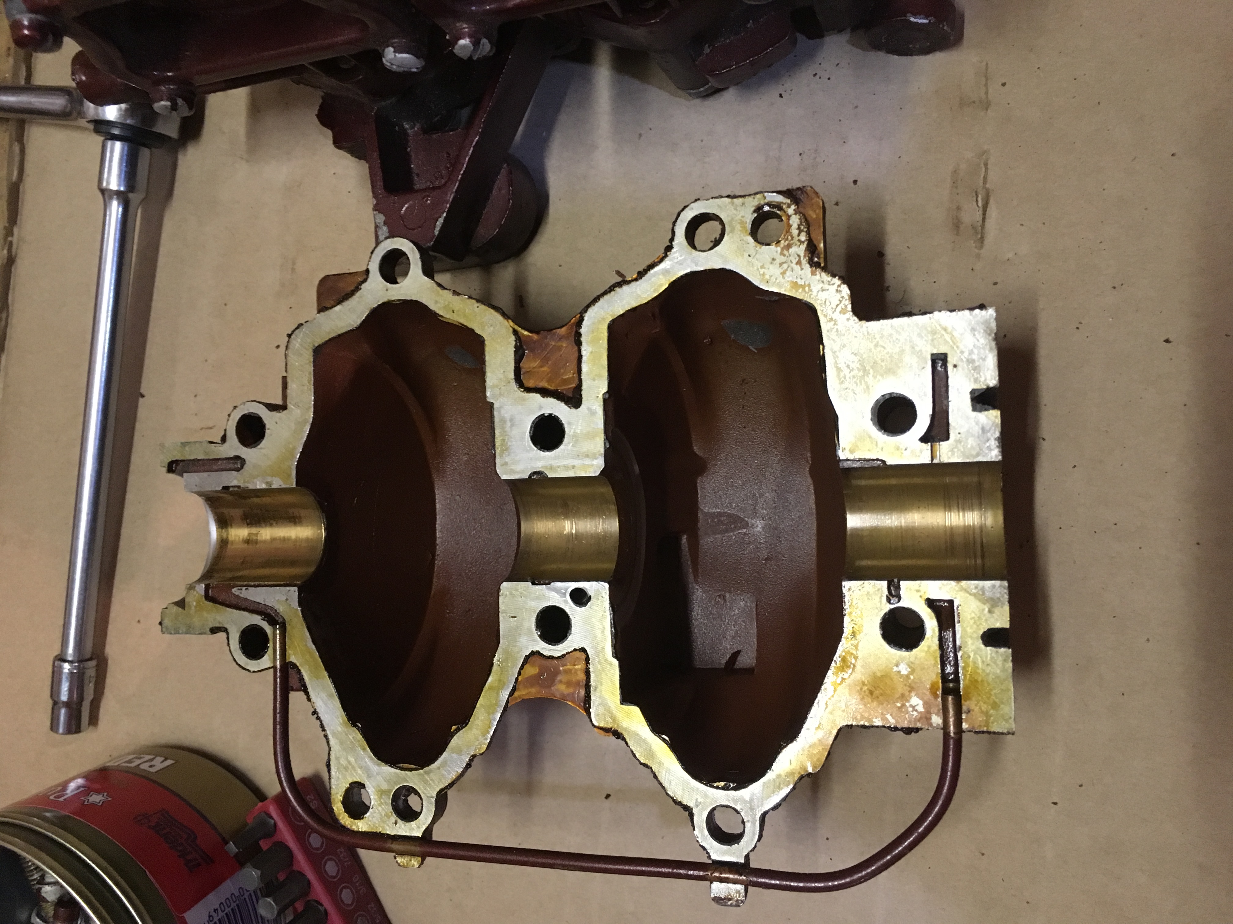

January 6, 2017 at 12:04 pm #50433I’ve preached on this enough, but my concern would be rust on one of the crank rod journals. It takes only a few grains of that stuff to scratch the rod bearings. Then you find one sticking through the side of the crankcase.

No need to preach to me. I will open it up and make sure things are good before I pull the cord with gas in the tank.

January 6, 2017 at 2:03 pm #50440A frustrating situation indeed….Darned if you do, and darned if you don’t. You indicate this is a nice low hour engine, so I would heed Frank’s advice to disassemble. Fortunately, this is a simple powerhead, no needle bearings to deal with….
