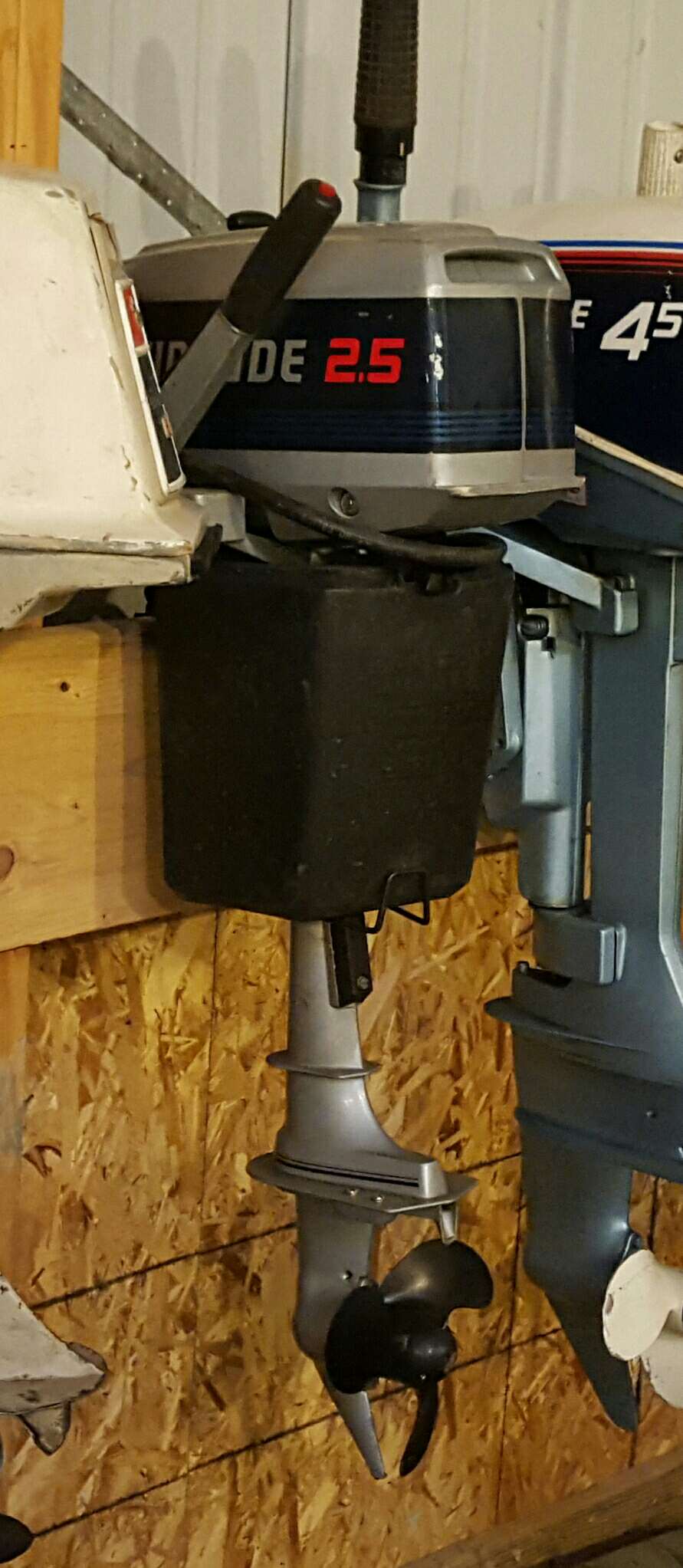

July 4, 2016 at 10:56 pm #39594I have a 1987 Evinrude 2.5hp with a factory saddle or ‘pannier’ tank. They made a 4hp vers I need of this motor too. I’m not sure if this could work with your motor or not, but the tank itself is pretty small and handy by itself. They aren’t real common pieces to find by themselves and I have seen a fair number of these motors without the tank. This is a picture of the saddle tank anyway, so you can see what it looks like.
-BenOldJohnnyRude on YouTube
July 4, 2016 at 11:22 pm #39595Ben-How much gas does that pannier saddle tank hold? On the 76-79 2 and 4 hp’s I have the gas tank on top holding a quart. Looks like the saddle tank is way bigger, an improvement for capacity would be great. Problem is gotta have a fuel pump . the late 70’s 2 and 4 hp were gravity fed.
Robbie RobertsonJuly 5, 2016 at 1:26 am #39605That would work now I need to find one thanks for the replys
July 5, 2016 at 1:35 am #39606I’ll double check the pannier tank capacity when I get back home but it’s close to a gallon give or take a little. It’s definitely an improvement in capacity over a top tank. Yes, you do need a fuel pump. Also, the cap doesn’t seal the best and if the motor is tilted up with the tank in place it tends to drip quite a bit if it has much fuel in it. If all the gaskets were replaced it might not. You do still have to remember to close the vent before you tilt the motor.
