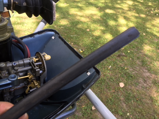

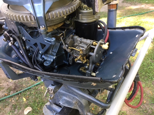

                        I just barely replaced mine with 3/16 rubber fuel line that I slit lengthwise, it worked perfectly and looks pretty good too. Mine was whooped and beyond usage. It’s cheap enough to do annually. No adhesive required and it quiets the hood rattling.
