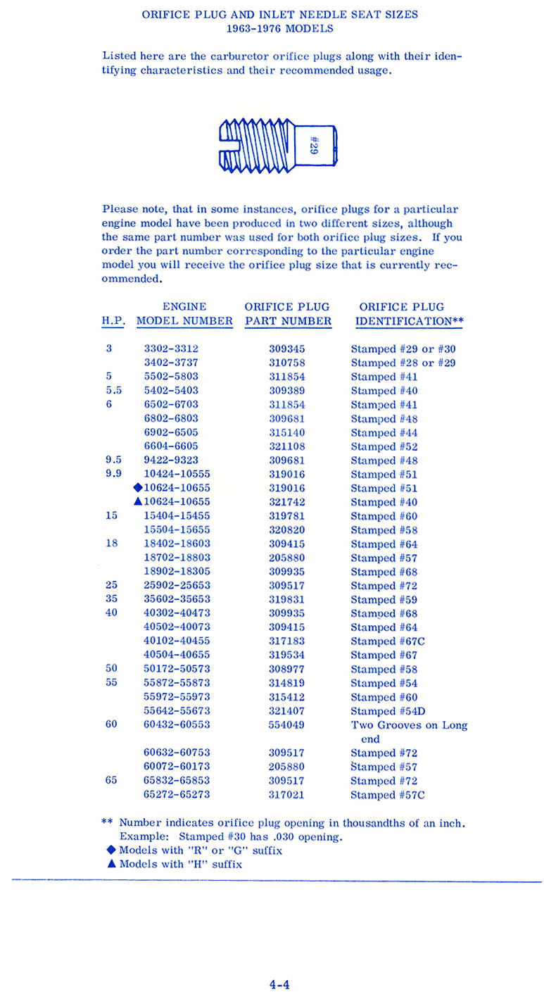

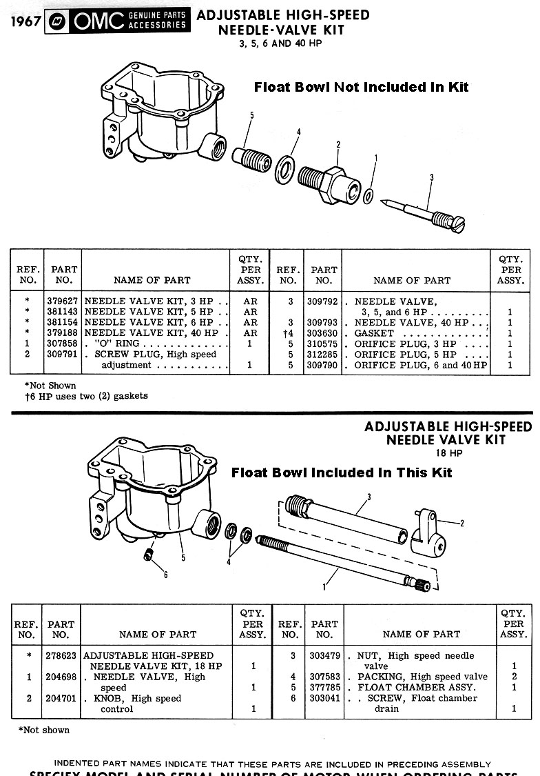

      I’m about to do carb rebuilds on a 1972 50hp Evinrude.
      Are there any adjustable high-speed needles available for this motor?
      There is one listed on ebay, but doesn’t say what motors it works with.
      #73587
        I’m not sure if they made them for your 50 horse motor or not but they did make them for the 40 horse motors thru the seventies. Usually the orifice jet in the carb is changed to suit conditions when dealing with the larger motors.
