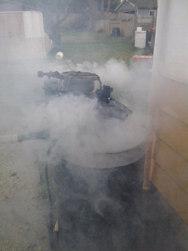

                        Roping them over slowly with the spark plugs disconnected will help remove any water sitting in the pump. Fogging motors is always exciting to!
