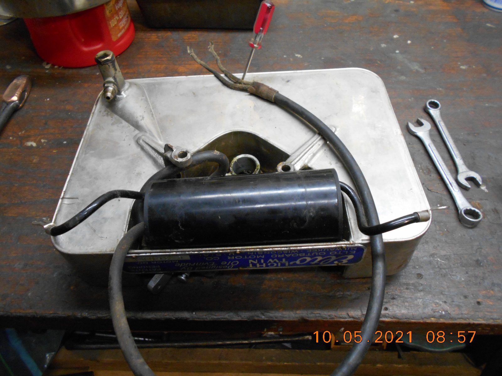

      I removed the flywheel and tank on the second 1925 Elto Lightwin, Model C,
      to check out the coil, as long as the hotplate was still set up for heating tar
      and melting wax.
      I was surprised to see that the coil and wiring looks in great shape.
      Only thing I can think of that it was replaced at one time.
      Did they sell aftermarket coils for these years ago?
      It has a black casing, and no markings on it that I can find.
      The secondary seems okay a 5.5 K ohms.
      I get inconsistent readings across the battery connection leads,
      but perhaps that’s because the capacitor is “in play”?
      I was going to hook it up to a battery and check spark, but the timer
      has to come apart first. The latch drive is turning very stiff like it
      has petrified grease in it.
      DSCN1874
      DSCN1875

            Tubs, I watched your video, and the Canadian Chapter Boy’s video before I fixed the first coil.
            Very helpful, Thanks!
            I tested the good looking coil after supper, after freeing up the timer and cleaning the points.
            It seems to spark good, so I guess I’ll leave it alone for now.
