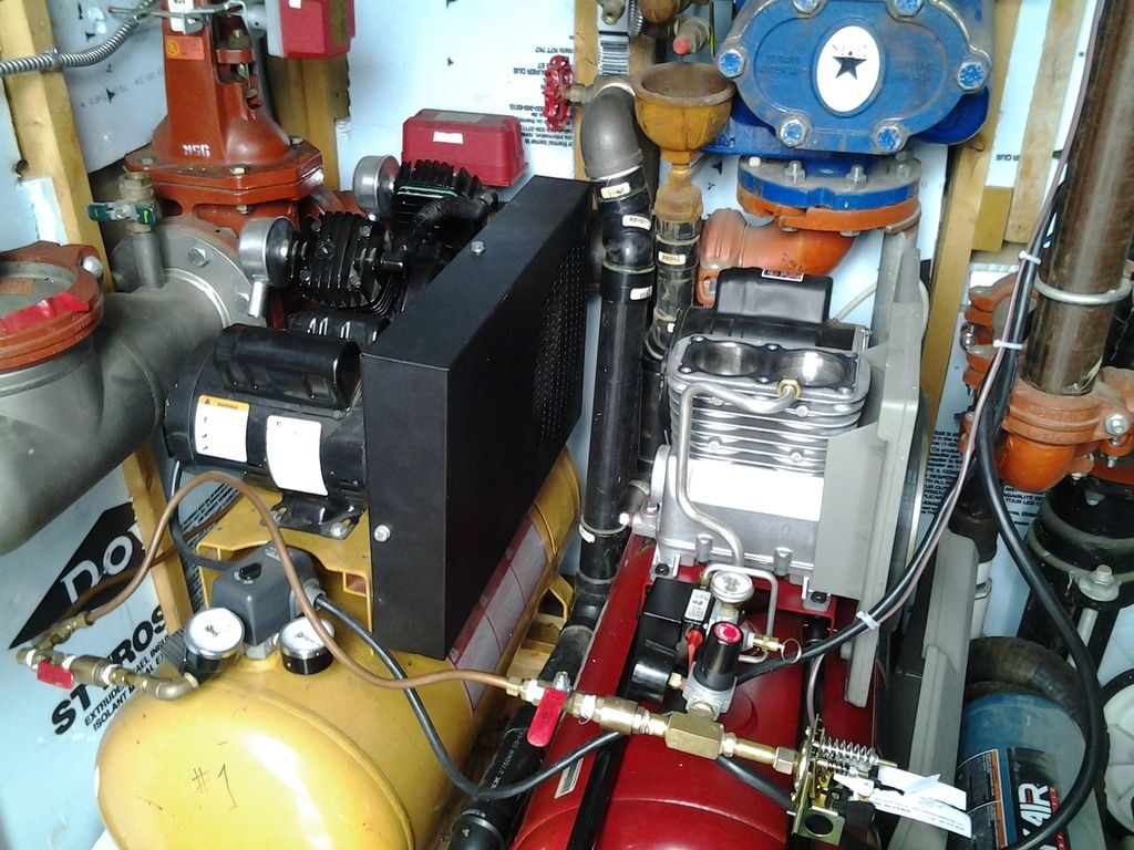

              What you want to look for in a compressor is its CFM (Cubic Feet Per Minute) rating, not the pressure it can develop so much. Most compressors will put out 100+ PSI but they have to put out at least the minimum volume your tools or spray gun will demand of it. There’s nothing worse than running low on air halfway thru a paint job and having to watch your paint set while waiting several minutes for the too small compressor to build up air again.
              If you want a large one, keep your eyes open for a body shop going out of business or upgrading. I found this 5HP DeVilbiss two-stage that way cheap and it only needed a guard made and a main switch. It puts out enough air to run several tools at once and has enough volume for beading or sand blasting.
              Another option to get the volume is to hook two smaller ones together like these ones are. They aren’t in a shop but are used for charging a dry sprinkler system. When servicing them, I run them both together and they put out a pretty good breeze.
              #22876
              wiscoboater
                Mumbles, That red one seems to be missing something up top!
                #22877
                  Yeah, it had blown a head gasket. It’s kind of funny how hot they can get running continuously before someone discovers it! 😀

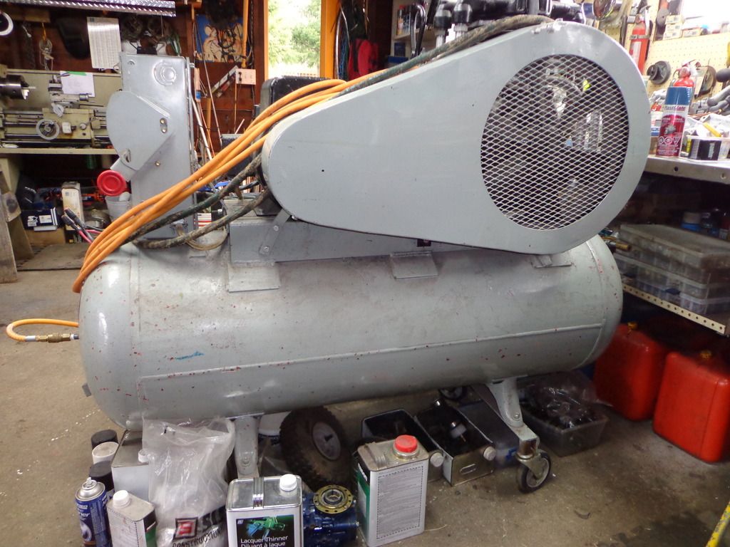

                    WAYNE
                      You need to determine the maximum amount of air you need and then pick out the air compressor. Don’t worry about hp. They are usually over rated. 1 hp = 746W and a 110V 15A plug outputs a max of 1500W. That means you can’t get more than 2 hp out of a standard 110V outlet. You can run a maximum of 5 hp on 220V wiring if it’s wired correctly. CFM is a better way to pick a compressor. Just know that those numbers can be biased as well. A compressor will output about 3-4 CFM per true hp. A two 2 stage compressor will output 150 psi whereas a single stage will output 100 psi. A single stage is all you really need.
                      I paint outboards and run tools with a small 1/3 hp 8 gallon compressor. It outputs 3.7 CFM at 90 psi or so it
                      claims. I suspect it’s less than that. I also bought a good quality old (1968) single stage 110/220V compressor with a true 2 hp TEFC motor and 60 gallon tank off the local buy and sell website last year for cheap. I would go this route if you have the space. I use electric DA sanders. I don’t like pneumatic air sanders. JMO
                      Wayne
                      Upper Canada Chapter
