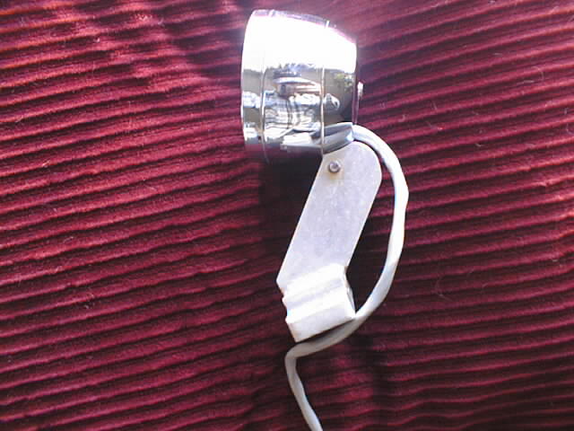

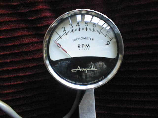

      I have this pedestal mount Airguide tach. I want to use it with a Mercury Mark 58. It has four wires coming out of it. Two are for the internal light, the other two are red and green. After removing the back cover the red is labeled plus(+) and the green is labeled minus(-). Does this tach require a sending unit,or can it be wired direct to the motor? If direct, do they go to the mag and ground? If anyone is interested, I would be willing to trade this for the same tach in a surface mount.

        My guess is that it does require a sending unit.

            I do not know the model number, and my tach is not on this chart(nothing is listed with 0-9000 RPM). After further research, I think it may be for an automotive application. If anyone has a vintage tach that will work on a Mercury four cylinder with a mag, I would be interested.

                When I was a kid, I connected an Airguide tach to my 18 Evinrude. (-) went to the block, (+) went to one set of points. Used the selector switch for the proper pulses. Worked fine.
