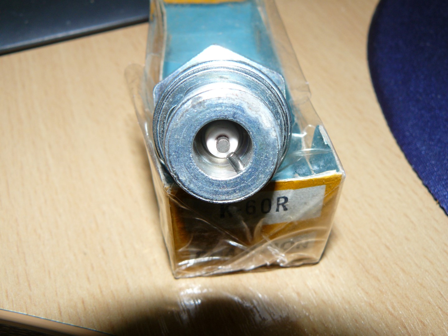

      5MJ = D9J = 508 if you’re sticking with Champion. The Johnson PO uses an R-7 = K60R = 506 . . . 😀
      Founds some NOS K60Rs for the P45- they’ve a pin-style side electrode recessed in the thread…how do I set the gap please?
      #66794
        By pushing that horizontal electrode in or out to get the right gap…
        #66802
          Since that requires a special tool, it is unlikely that the gap will get out of adjusted by mishandling like the standard "J" gap spark plugs do. . . 😀
          #66805
          rapier
            If only I’d known..what does this special tool look like (luckily they’re preset to 020)?
