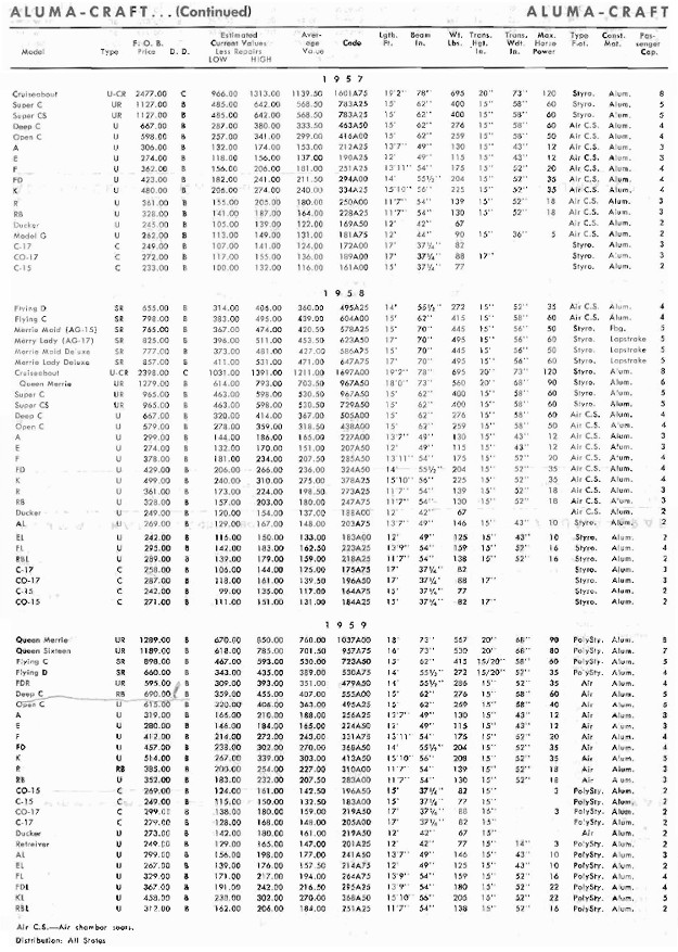

        Attached is an early Alumacraft spec sheet, but
        hard to read.

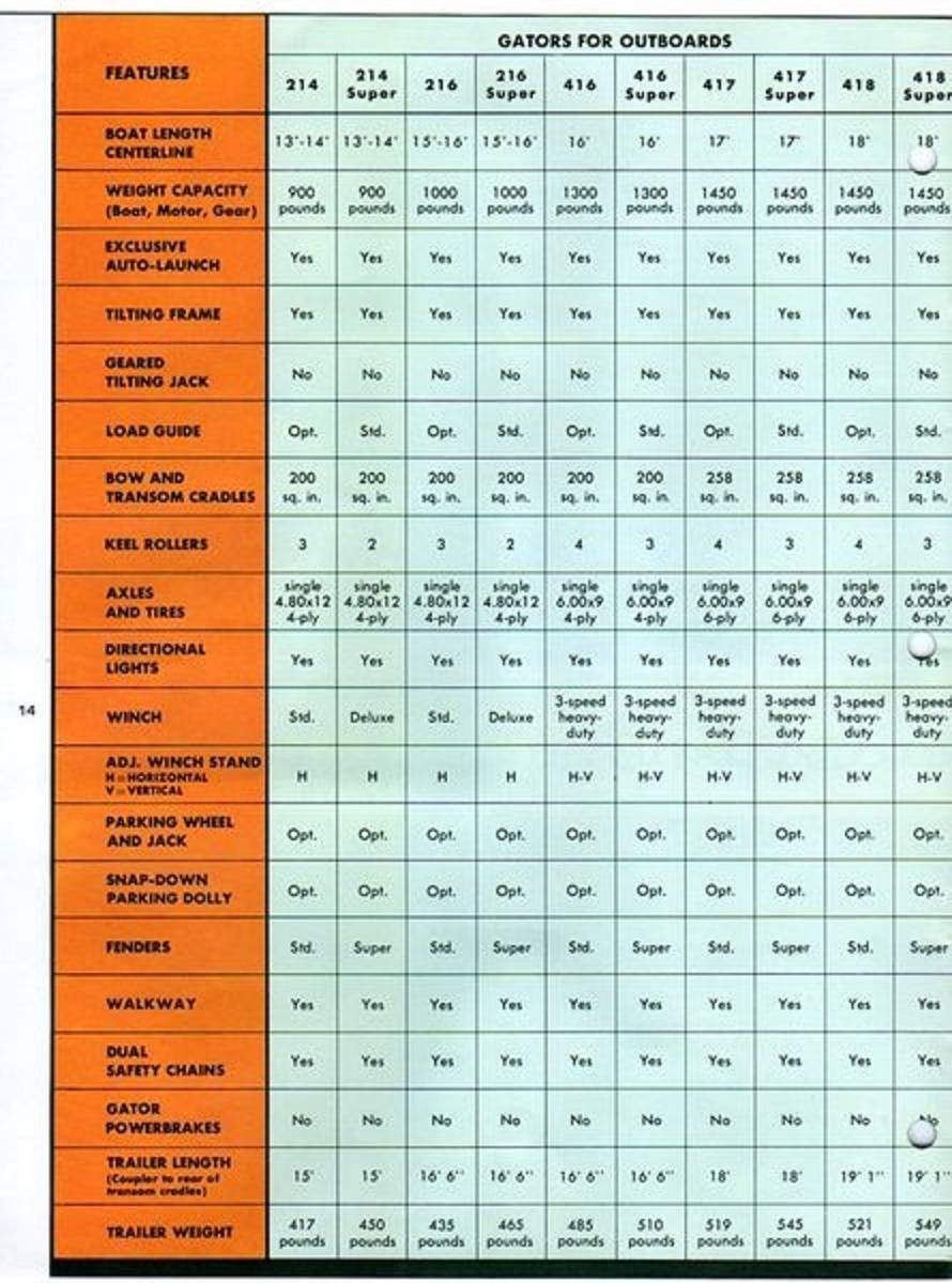

        Also attached is a hard to read Gator spec sheet.

          That’s a nice boat Kevin. It looks like a model K possibly according to the posted list.

            Trailer looks like it has 4.80 x 12" tires. These are easier to get than the 9" ones sometimes seen on old trailers. Check for obvious broken welds. If pulling home any distance pull hubs and check/lube bearings, or at the very least feel for hot hubs after a couple of miles….

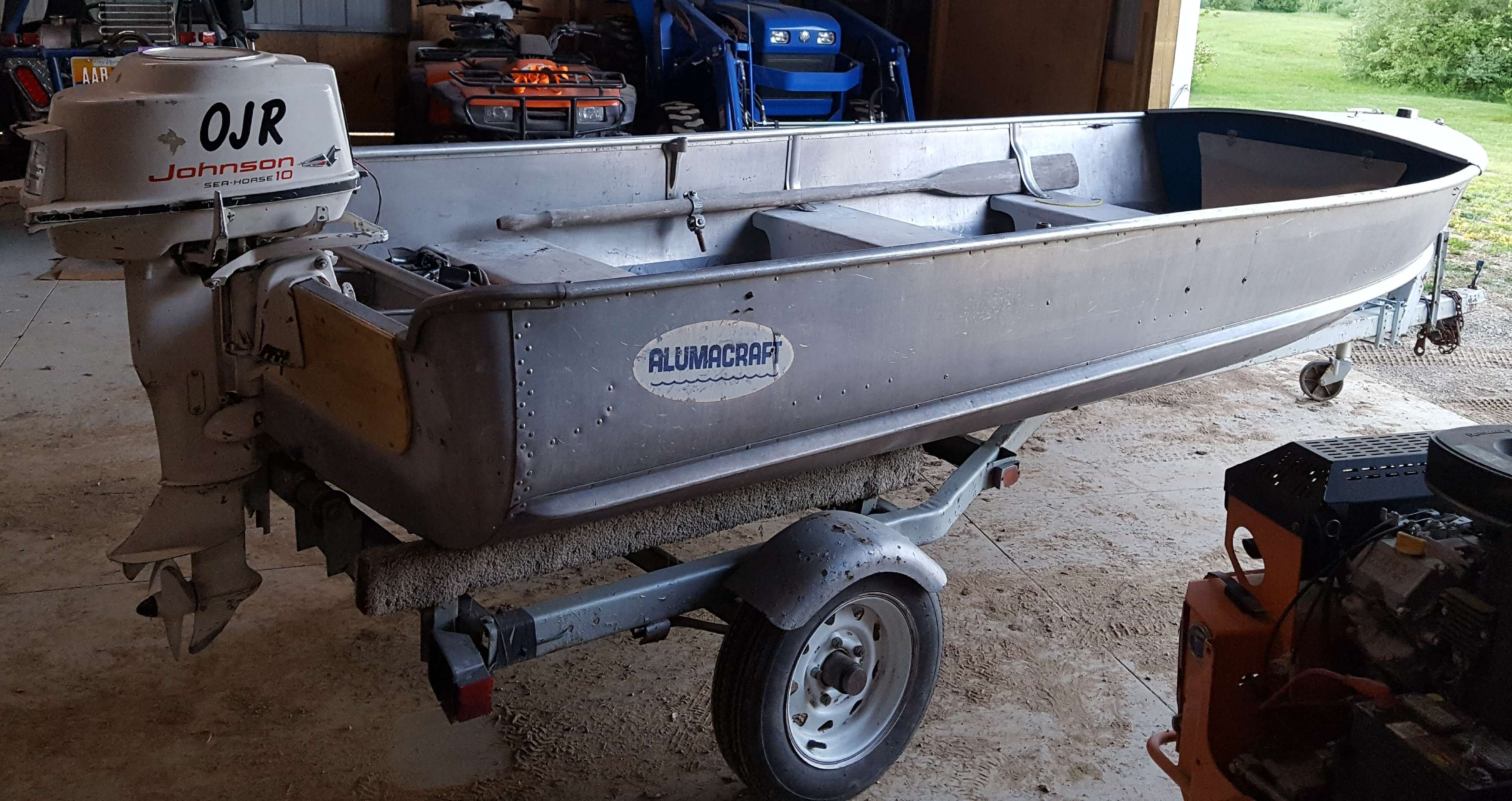

              Here is a picture of my 14 footer with the oar stowed under the strap.

                      The trailer seemed solid enough but will require substantial work (sandblasting and bolt replacement, probably the rubber parts too). Buccaneer, the model number was stamped right where you said it would be (see pictures below). Model number looks like 244-3 24 which I have not yet been able to find any information on. He had the gator aluminum hub caps, but they were pretty corroded. I measured the rims and they were 14", so you were pretty close with your observation amuller. Interestingly, the wiring (which will need replacing) was all strung along the outside of the trailer frame. I would have thought the wiring would run through the middle of piping, but there did not appear to be any entry/exit points for wires in the frame.
