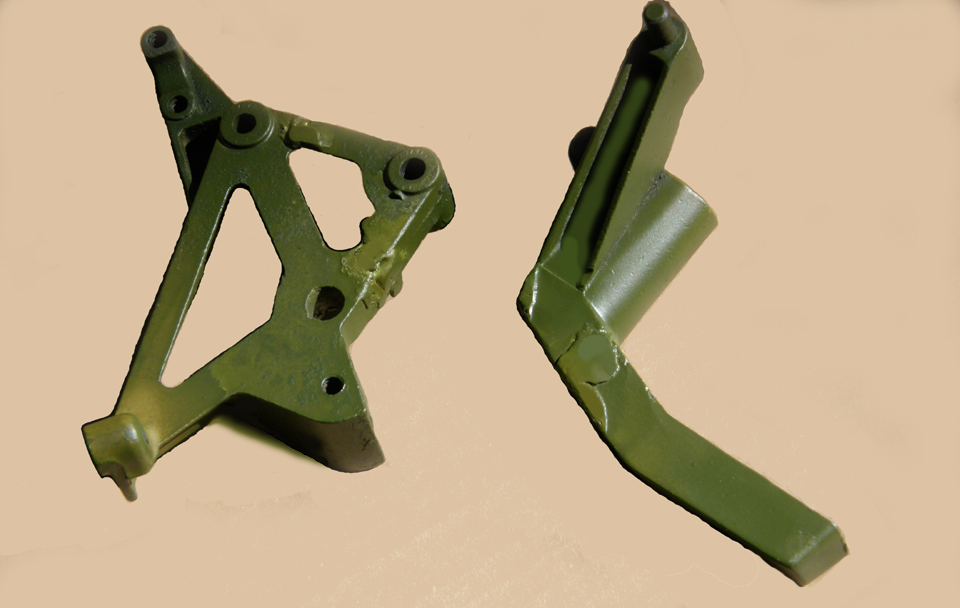

          I watched their 6 minute video.
          https://youtu.be/RCrixbXz4rc
          I like how they fix a threaded hole and
          make a new "ear" with a bolt hole on
          a casting.

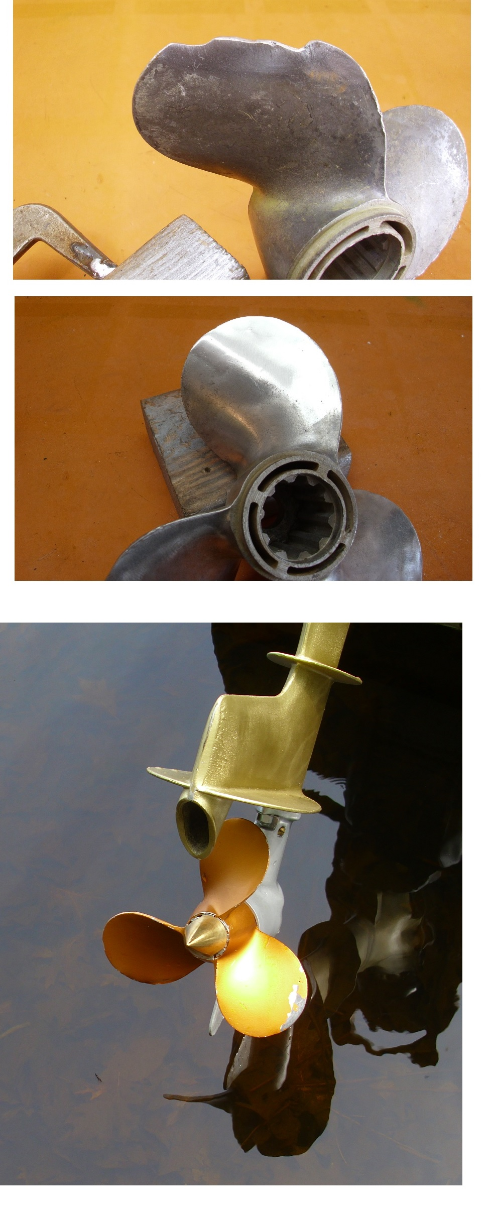

                I patched this prop with one of those low temp.
                aluminum welding rods this winter. Been running
                the motor 3 to5 times a day for the last 8 days.
                The paint is coming off and I can see it has
                changed to a darker color but it’s still on there.
                First time I got the stuff to work for me. There
                Is defiantly a learning curve and I’m not even
                close to being around the corner.
                Here is a link to that discussion.
                https://aomci.org/forum/viewtopic.php?f=5&t=11625&p=61708#p61708

                      I have had some luck with small parts. I use it to repair chips out of the AV plates on gearcases. Never tried anything like a boat before!
                      I first cut the hole square.
                      Cut a piece to fit
                      bevel the mating edges
                      CLEAN CLEAN CLEAN, then clean again with SS brush
                      heat the part, not the rod. Get it hot, so that when you run the rod along the crack, the medium flows into the crack.
                      Keep heating and testing by running the rod along it. If it doesn’t melt, part is not hot enough yet.
                      #61200
                        The heated aluminum oxidizes as soon as it is exposed to air. The secret is to cover it with molten rod then scrub with the stainless steel brush. It will then stick to the almost melted aluminum. I have fixed a few things, but have used almost as many brushes as rods. . . 😆
