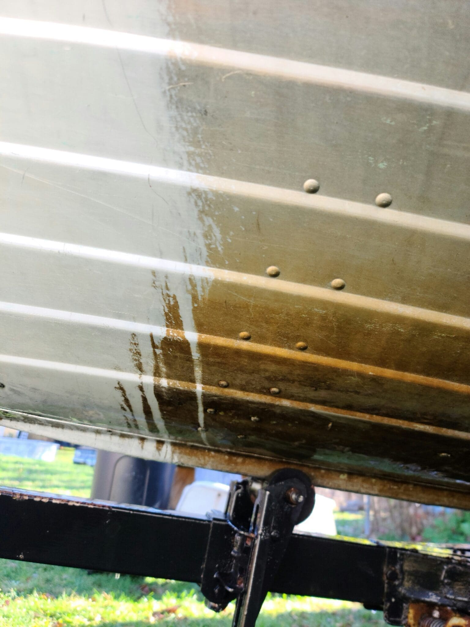

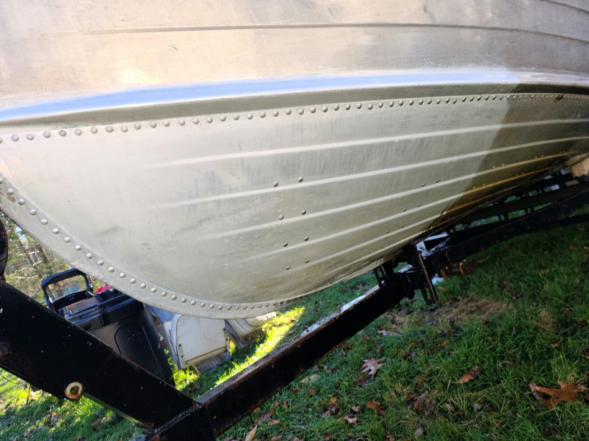

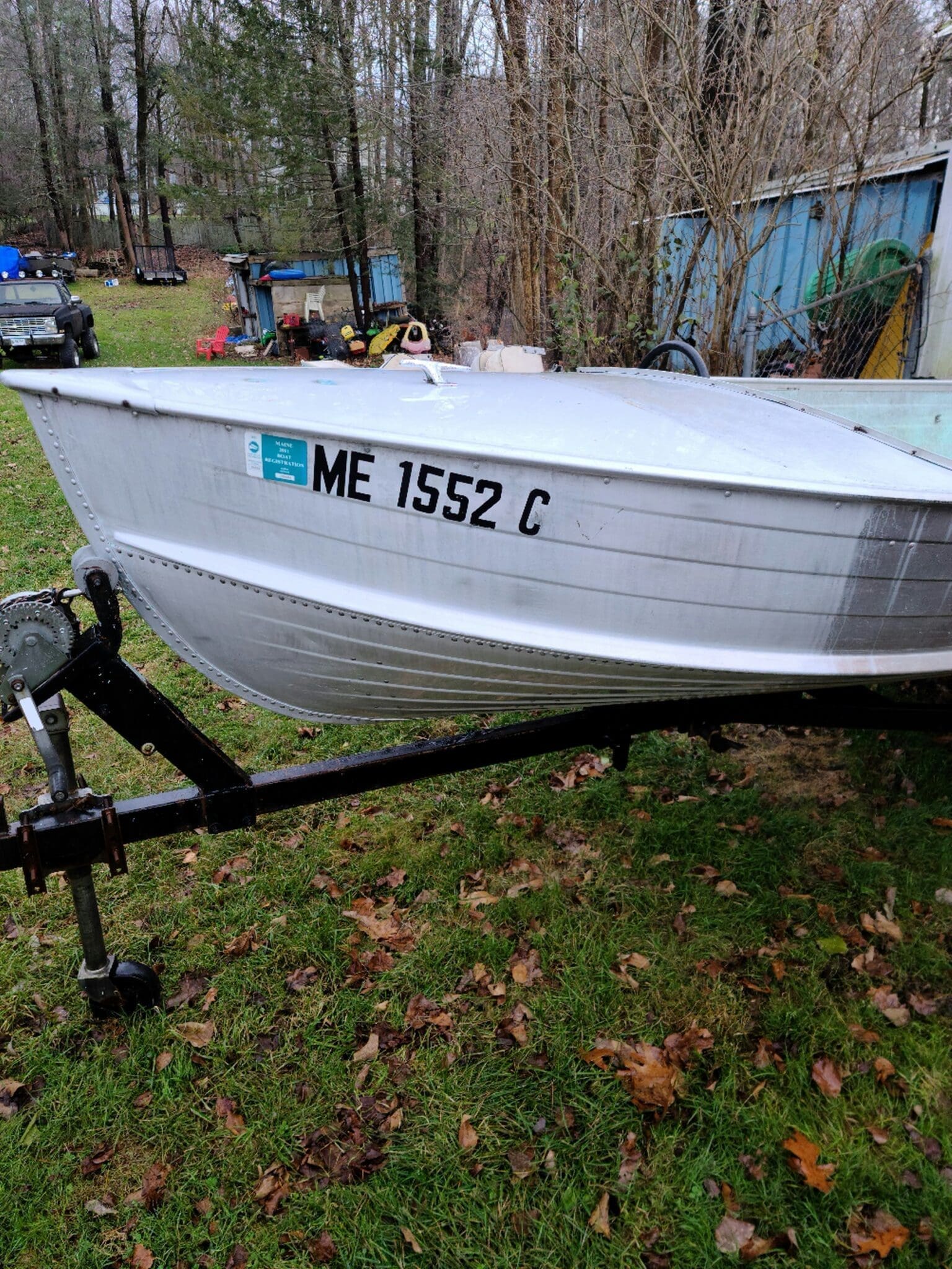

      Hey fellas i came across a video on YouTube of a guy using a product made by purple power called aluminum brightener he was using it on his aluminum runabout i was amazed at the outcome and no scrubbing at all so i decided to try some and here are the results so far

        Wow! That’s really something! Thanks for sharing. Any idea what the active ingredient is?
