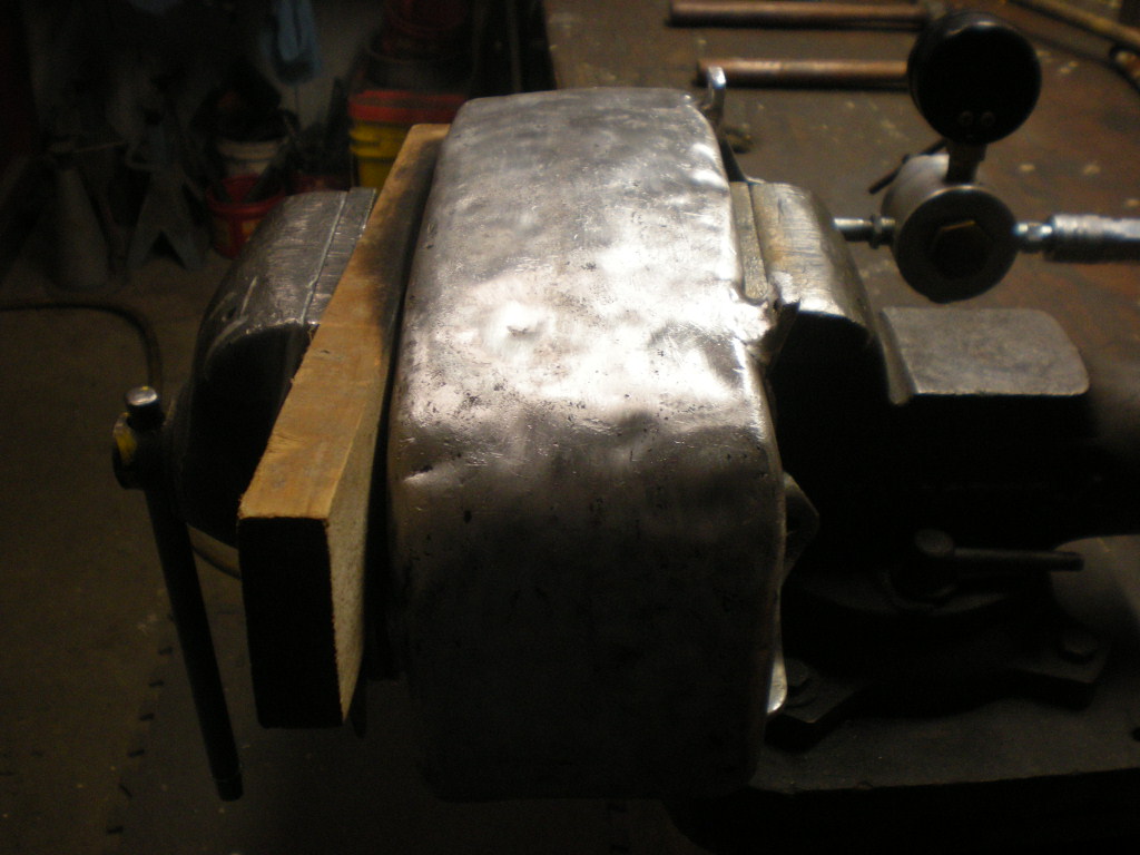

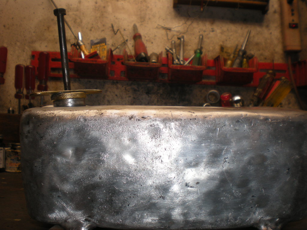

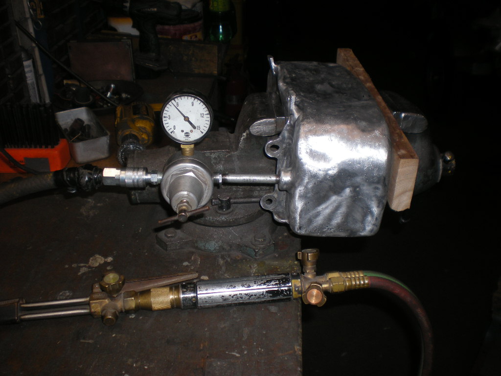

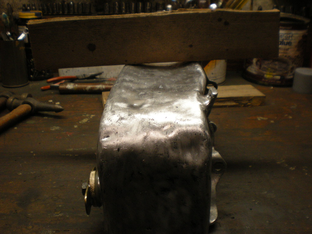

      Trying to get the tank on the Johnson A-80 somewhat more presentable
      than it was. I decided on the "air pressure and heat" method instead
      of cutting the tank in half and re-welding, as my aluminum welding
      equipment consist of some $10 aluminum rods and gas / oxygen torch,
      and my skill with such "suck", lol.
      Anyway, I’ve progressed thus far (as shown in the photos), and decided
      to quit before disaster struck.
      The heat from the torch and air pressure did most of the work, and a little
      help from a hammer.
      Just wondering what I should do to make it better yet?
      Sound I continue with the heat and air pressure, or
      just start block sanding and "tapping" with the hammer and little
      here and there?

        Good job so far.
        #67319
          If memory serves, increase your air pressure to 9 psi, not 8, not 10, but 9 psi, then use heat and tap around the dents and they should get better…. AOMCI President Jay Walls did a show on this at our North Webster Indiana meet one year….fascinating…

            is your torch not too big?
            It looks like a cutting burner, rather dangerous IMO
            I prefer a propane solder burner for more control of the heat
            #67325
              Kees, yes, it was a cutting torch. I use propane instead
              of acetylene, and had it adjusted to a "lazy" flame,
              so as not too hot. Otherwise, all I have use is a
              too small brazing tip.

              The top of the tank was pretty decent as far as dents.
              The vise kept the flat top from "bulging out" from the
              air pressure. Not sure the magic number as far as
              air pressure. All I know is that too much might be bad. 😮
              I would think air pressure would be a variable depending
              on the design and shape of the tank.
              Thanks!

                Jay Walls insisted on the 9 psi, not 8, not 10 but 9 psi…

                    You’ve done good so far, but might I suggest you place a want ad for another tank. The A-70, 75 and 80 should all be the same. I’ll bet you can find one with minor dents ready for polish. Run this till you find one.

                        I would agree. 10 pounds and too much heat caused a “blowout” on my Bendix tank. I was fortunate that I was able to hide my repair under the decal.
                        Use propane and a light touch with the hammer.
