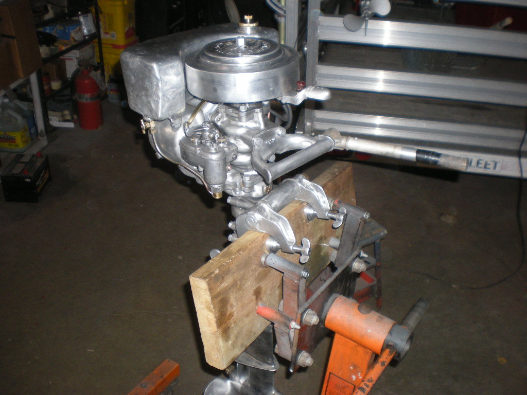

      Great to hear it’s a runner! Let’s see a picture of it all together. What did you use for condensers, I’m going to need to replace them on my K-80 and I’m sure they are the same.
      #67568
        I used Digi-Key capacitors,
        BC2609-ND, rated at .22uf.
        I fitted them in the well where the
        original rectangular condensers were.
        Now that I know it runs, I’ll look for
        a decal for the gas tank.
        It won’t be a "show piece", but at
        least it should turns some heads
        out on the lake next summer with
        the fisherman wondering what that
        "contraption" is, lol.
        P.S.- I believe I have the correct tiller handle coming.

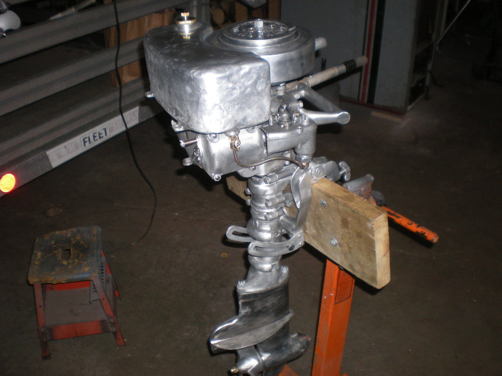

        #67578
          Tank looks pretty good especially when you consider
          what you had to start with. When you get to take
          the motor out those who see it may think your tank
          isn’t much. If they only knew. Looks like you have
          gotten the curve out of sides and back. Seem to be
          pretty flat know. Dented tanks aren’t hard to find
          so we will be looking forward to your attempt.
