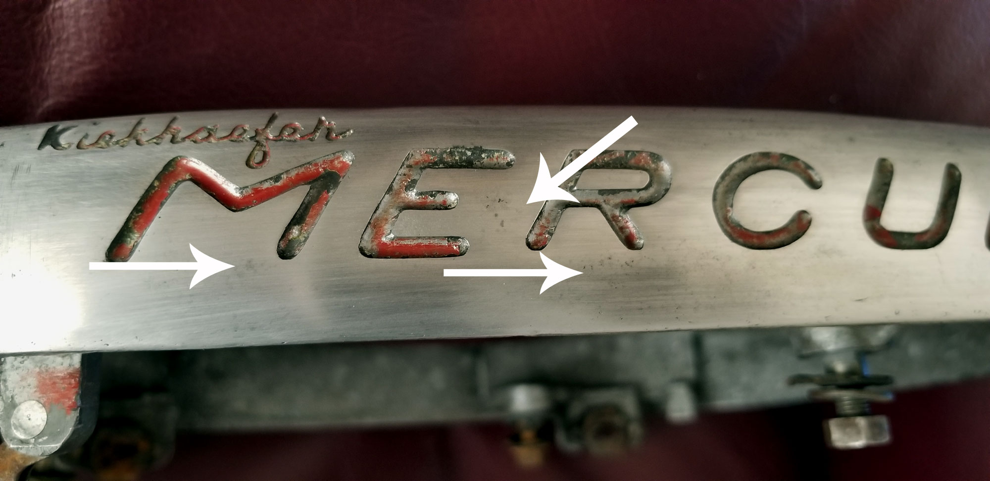

      I am working on sanding prior to polishing an aluminum gas-tank band from a green-top Mercury Mark 5. They were originally painted in a hammer-tone finish.
      I have sanded and worked my way up to a 500 grit but no matter how much I sand….there remains various imperfections….dark colored spots and specs that just don’t go away.
      What can be done? What am I seeing? Please have a look at the picture and see if you can help.
      Thanks, Chuck

        What did you start with? If not heavy enough, you will only get so much out.
        #72607
        20mercman
          That’s corrosion Chuck. This can be very difficult to remove. As Chris said, with the more coarse grits, you need to get them out as much as possible before going to more fine grits. Sometimes you can’t get everything out, or if you do, you have removed a lot of material to get below the corrosion.

            CHUCK
              OK; Thanks for the replies.
              Just to be clear…..the marks are not depressions. It is more like a stain which apparently goes deep under the surface….as additional sanding has little if any effect.
              I guess this is why Mercury chose to paint the surface?

                see what buffing will do for it.

                  As for the tank band – Your part is corroded. Period. The black stains are oxidation that has eaten its way into the pores of the material. Unprotected aluminum will oxidize naturally, due to exposure to moisture or contaminants in the air. You may be able to bleach them out, but not likely. If you buff it,the spots will appear to diminish or shrink away, so that might be your best option other than sanding them out or hitting it with glass bead. Either way, it requires some removal of the substrate in order to get down to where the stain has penetrated.
                  Hope this helps.

                      I’ve done a lot of alum buffing on vintage Airstreams and old alum boats. Never found a shortcut. I generally use a dewalt angle polisher with an Airway cotton cloth edge wheel and bar buffing compound. Busch Enterprises has the materials and good info. I rarely use sandpaper eventually you have to buff deeper than the deepest scratch where as the Tripoli Bar [brown] #63030 compound is a fast aggressive 1st cut, then you can skip to white bar #63020 to polish. On decient grade aluminum you will get a mirror finish. Now if, BIG IF, its possible the black stains were caused by back and forth sanding, resetting the removed material back into the just polished alum.Yea, sounds foolish, read the info at the Busch site. Try wiping it with accitone or even alcohal. Polish one direction if possible. The wheel compound technique will do well on and around the letters but beware of "molecular migration", [with experiance you can use that problem to fill pits!] agian Busch site. What I think I see in the pic I’d guess less than 2 hrs to finish.
