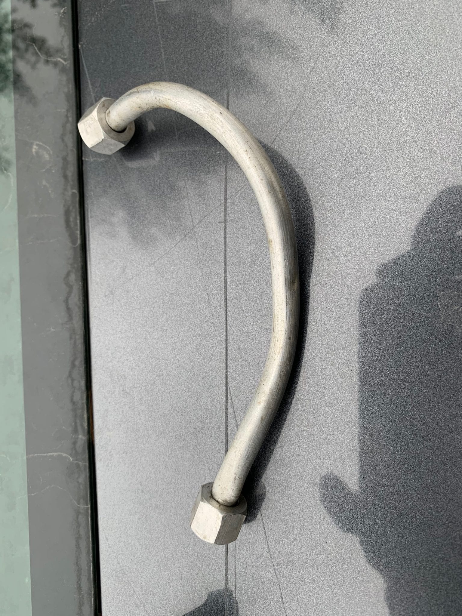

    davidk
      I was ham handed in handling my Johnson OA 55 powerhead and I cracked my starboard cooling line coming out of the jug. Is there a source for aluminum tubing and ferrules for making a new line? I know that most people just switch over to copper but the rest of my lines are good and it would look weird with one copper piece. Maybe I’ll find a parts motor with an intact cooling line?
      Summary: I am wondering if there is a source for aluminum tubing and aluminum ferrules?

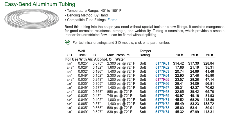

        #191666
          Easy-bend aluminum tubing at
          https://www.mcmaster.com/aluminum-tubing
          #191773
          davidk
            Thanks for the suggestions!
            10 ft for $23. 25 ft for $28. 50 ft for $50 . It would be hard not to buy 25 ft, That’s a lot of OA 55’s. : )
