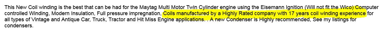

Sorry guys i know this has been asked many times i think i might try the maytag twin coil on ebay .. anyone know if this is the one … picture attached thanks in advance

April 18, 2022 at 11:48 am #258462April 18, 2022 at 2:56 pm #258470In my search for an Eisemann coil for my ’37 Champion, the only sources I could still find for these Maytag coils are either Flywheel Supply or Mark’s Carburetor & Magneto Service (Maytag Mark).
When I initially contacted Flywheel Supply directly, they wouldn’t sell me a coil when I told them I was needing it for an outboard motor. In addition to Maytag coils, Flywheel Supply also has some Wico coils.
Mark’s Carb & Magneto has a Facebook page but I don’t go there. I ended up getting my coil thru Bob’s Small Engine Repair who happened to have one of Mark’s coils on hand.

April 18, 2022 at 3:20 pm #258475Yes the one i posted is from flywheel supply sold on ebay i think i might try one was just wondering if this is the one
April 18, 2022 at 3:28 pm #258476I know that the John Deere pony motor coil will work in a Lauson, however the armature laminations have to be cut down to fit the core… I think from 5/8 to 1/2 ” square. The coil on flea- bay appears to have the larger, proper size core.
