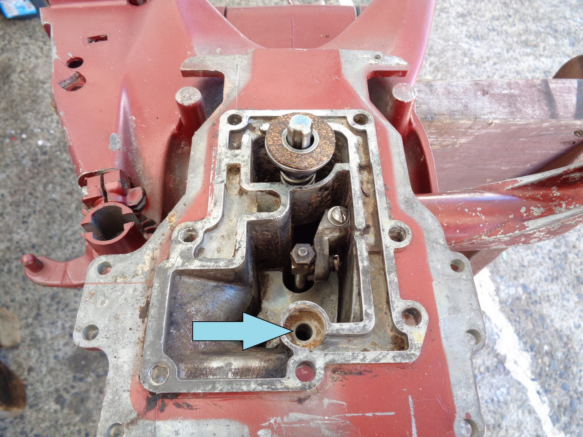

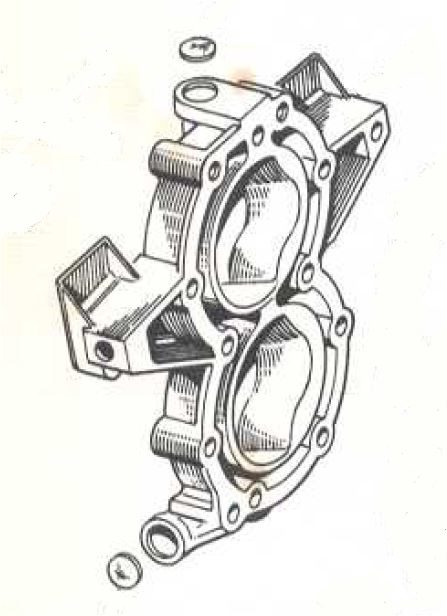

      I just picked up a 1956 7.5 hp that the previous owner swapped the the complete lower unit from a 1958 5.5 he went right through it but he has given up because it pumps water out of what looks like a freeze plug on the head and i see something bubbling on one of the other head bolts but i doesn’t pump water out of the normal spot on the lower unit my question is are the compatible ? Or is something maybe plugged up ? I have the 5.5 power unit so i might swap it back but the i was wondering first thanks
      James
      #244953
        Both exhaust housings are the same so the powerheads interchange. No problem there but if water isn’t coming out of the exhaust relief, insects may have crawled up in there and built a nest. If the water pump needs servicing, the powerhead will have to come off and that would be a good time to make sure the water passage (blue arrow) is clear. You should be able to see daylight when you look down thru it.
        The 7.5 cylinder heads have two Welch plugs and the lower one likes to rot out or fall out causing a leak. Water shouldn’t be coming out from under a bolt head either as the threads are dry and don’t go into the water jacket. I’d suspect a leaking or blown head gasket, P/N 203034 as the culprit. Or possibly the head is corroded thru into a bolt hole or it isn’t torqued down properly.

                Are you sure it is a 1956 unit? I’m asking because 1955 powerheads/exhaust housings were a little different, and you can not mix/match 55 and prior with 56 and later years…Post some pictures when you pull the powerhead…
                Like others have said, and you have discovered, the water pouring out is most likely due to the bottom head welch plug falling out, which short circuits the water path out of the normal relief on the exhaust housing.
