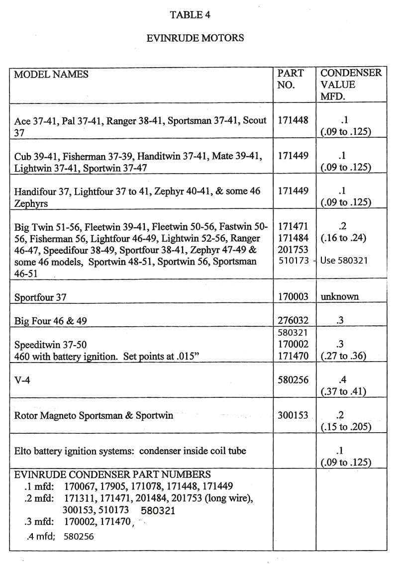

        That takes a 0580321 – 3µf. + or – 10% . . . Someone should have the generic number for you –

          Did you change the coils in the ELTO? I think there is only one choice for the modern replacements, which is .22 mfd.

            With all due respect to Garrys post, the 580321 cap has a rating of 0.22 uF +/- and not 0.30 as shown. The Evinrude chart shown had a typo and has since been corrected.
            Caps_table4

              I will just give him a modern cap, rated 600 volts 🙂
              220 nF is a usual value.
