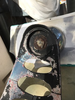

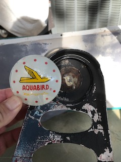

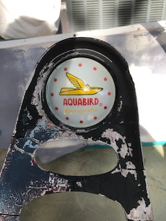

                1aquaholic
                  I just went and looked at my Aquabird steering wheel. Mine has a center cap that is glass. If yours is the same as mine, be careful not to break the glass, as I’m sure they are hard to come by! It is held in place by a spring loaded circle clip. (I took the clip off awhile ago, and I can’t seem to find it) Pop that clip off, and it should come out. My steering wheel is not in the boat, so I just turned the steering wheel over and it came right out. On mine, behind the glass Aquabird center cap it looks like they welded a nut on the steering bolt. It’s all rusted and there’s no way to grab ahold of it.
                  I’ll try and post some pictures to this response, but if for some reason I can’t attaché them, PM me your email and I will send you the pictures of my steering wheel.
                  I hope this helps!

                        worked like a charm, the clip was disguised inside a white nylon jacket. I thought it was a seal or glazing or something.
                        I tightened up the wheel and the wobble is gone. There’s a small amount of play in the keyway though, so there’s a minor delay in the shaft rotation before the wheel catches. If it bothers me enough, I’ll see about replacing the pin that sits in the keyway
