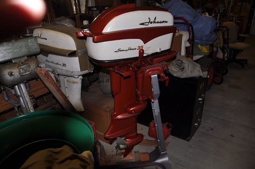

      Hi everyone! About to pull the trigger on buying a 1958 Johnson SeaHorse 35hp outboard that is coming with a classic duracraft I am buying.
      The motor has been rebuilt, but has been sitting for 3 years in a garage. I was informed by the seller that the carburetor would need to be rebuilt due to sitting (plus the tank flushed and fuel line replaced of course).

        Those carbs are super easy. Few of us are mechanics on this site. We’re just hobbyists who like wrenching on and learning from these wonderful old mechanical beauties. With a little sweat equity and guidance from members here, you can do it. Don’t be scared, jump in!!
        Parts for a carb overhaul are available and not expensive. Try dan gano in our links. He also gives good, free tech advice.

          Well now, the carb may, or may not need a cleaning, or rebuild. That remains to be seen. Try fresh gasoline/oil and pump it thru’ the hose by squeezing the primer bulb and depressing the fuel side pin on the connector. Eight or ten pumps will shoot the old fuel OUT and refill the hose with the NEW. Catch the old fuel in a pan, or bucket, or something. Drop the motor into a barrel filled with water, connect the fuel line, tighten the fuel cap and pump up the primer bulb till it feels hard to squeeze. Now pull the choke, grab the starter handle and give her the devil. ( Put her into neutral and twist the handgrip a tad to the left. If she fires up, let her run in the barrel for a while. (In the picture, that 35 looks very, very nice). Let’s pretend that things go well with the motor and you end up buying it. For gasoline, find an airport, or race track. If an airport, fill your fuel can with 100 LL aircraft fuel. (100 LL is 100 Octane gasoline that has had a low amount of lead added). It is opaque blue in color and smells different than the ethynol gasoline trash that we buy at the pump. OR, you can go to your area race track and buy 93 Octane gasoline with NO ETHYNOL !! Of course, you mix both types of gasoline with quality two-stroke marine oil. 50:1 ratio. ETHYNOL is the bane of ALL carburetors. It is cancer to carbureted gasoline engines both two and four-stroke. When ETHYNOL sits dormant in a carb, fuel system, fuel tank, over a period of time, it clogs, gags, starves, and generally wreaks havoc inside of gasoline engines.
