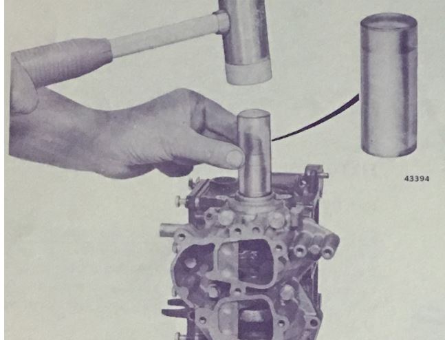

      I am looking to make an upper crack shaft installer tool for 1955 25 hp OMC motors.
      If you have this tool.
      Can you please give me the dimensions of it?
      Also – Arthur on Facebook is interested in possibly make this tool with a 3 d printer.
      Thanks to all that supply dimensions.
      PART NO. 304722
      For 15 HP thru 40 HP engines
      (except 1962 and later 28. 33 and 40 HP; 1974 and later 15 HP;
      1976 and later 35 HP and 1977 25 HP)
      upper-crack-shaft-installer-tool
      #300843
        No need, just use a chunk of PVC pipe….. I have about a dozen of them already cut to length ready to go…. I have considered including them with the purchase of a seal puller.  If you want one…message me.  I have already tried with a 3d printed part, I was not satisfied due to how easily it “could” break, as some will undoubtedly hit it too hard with a hammer to seat the seal, so I stopped. I am sure it could be done, but someone smarter than me, suggested the PVC pipe solution…
